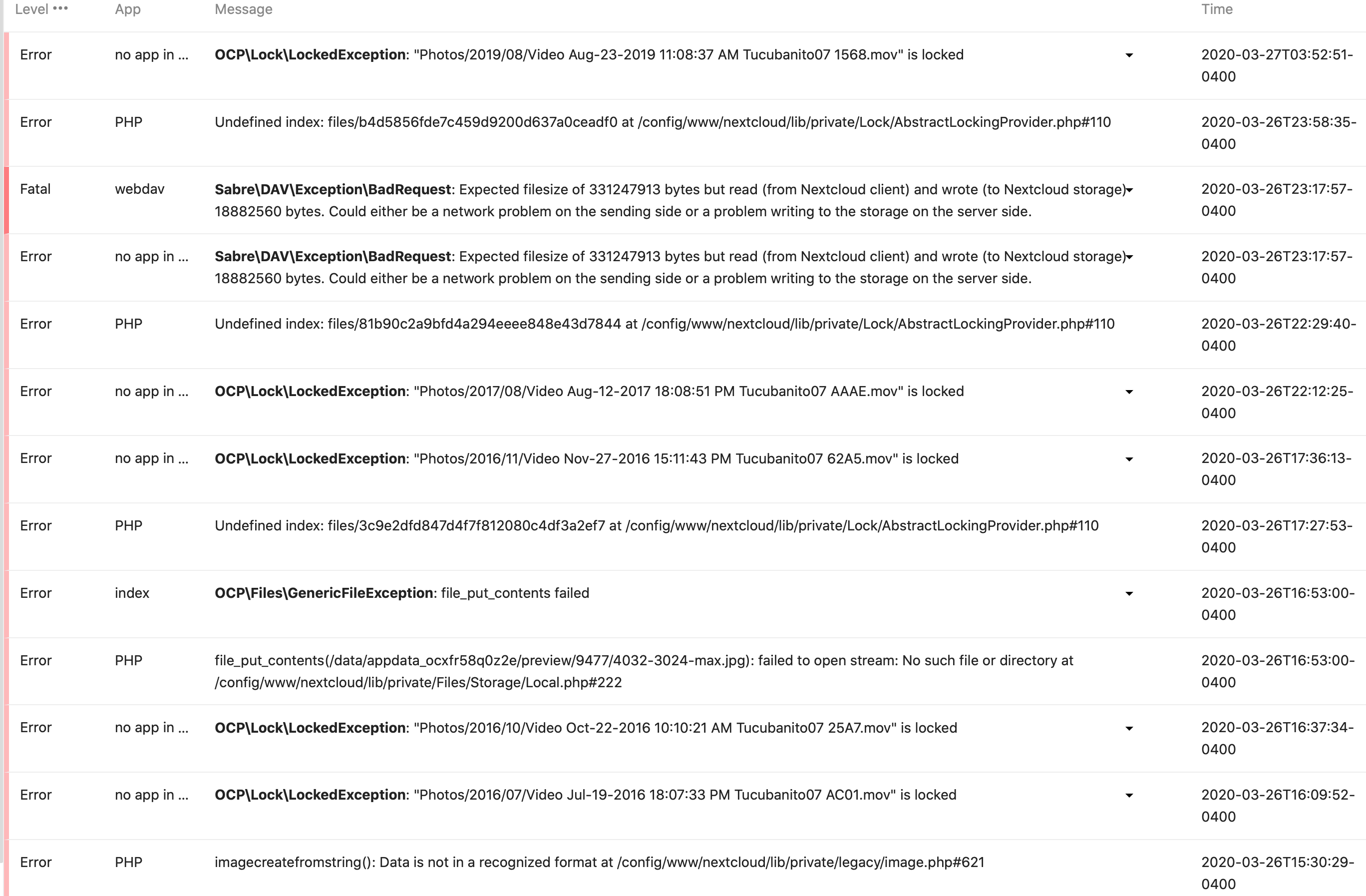

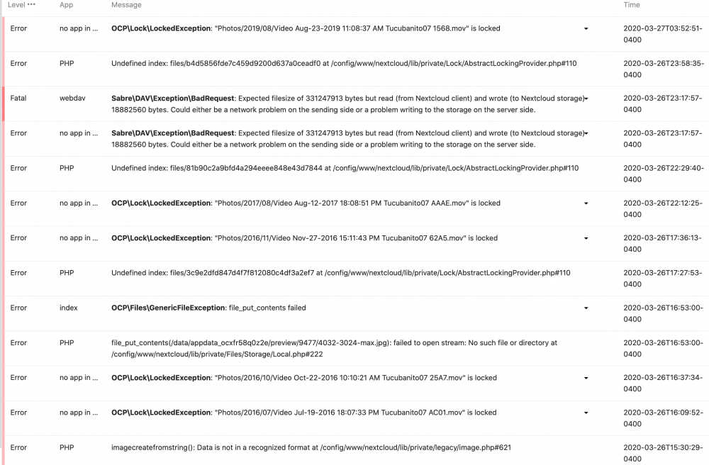

  17. Hey @alturismo every time i installed Nexcloud fresh i deleted the /appdata/nextcloud folder and also the MariaDB like that there is nothing on the folder. So i just uploaded all my photos from my phone on a fresh installed nextcloud and i get all of these errors. I dont know if they are critical or not but if is a fresh install, i should have any errors since i have not touch any files at all. Let me know what you think.

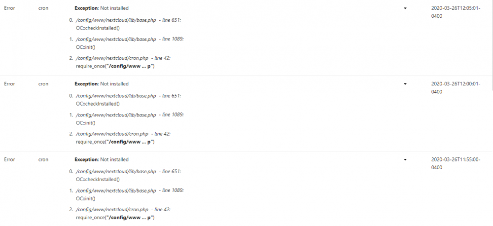

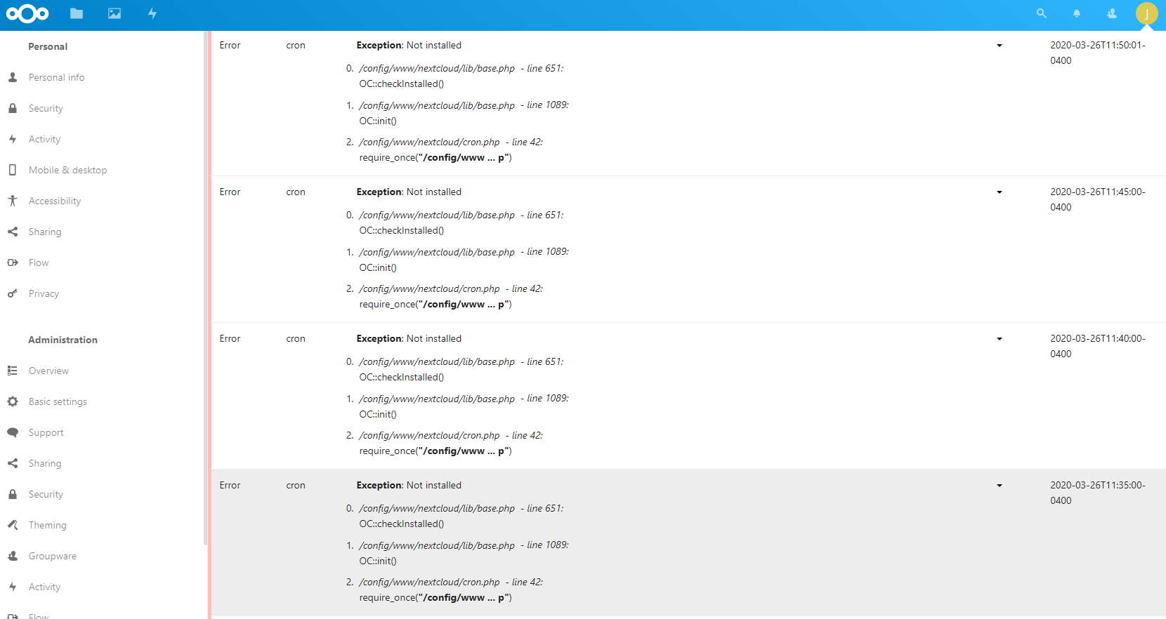

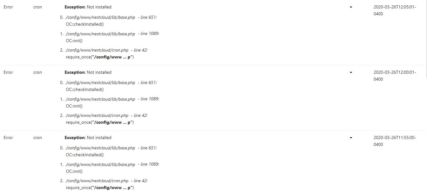

  18. Hey Guys, I just did a fresh installed of Nextcloud and i am getting these errors. Does anyone know what ti means or how can i fix them. When i did the installation i unchecked the Install applications like Mail, Contacts.

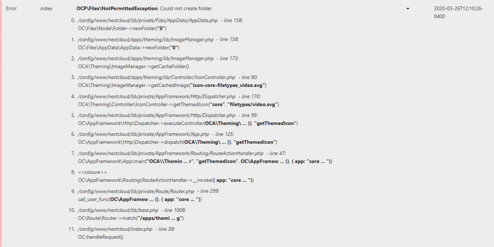

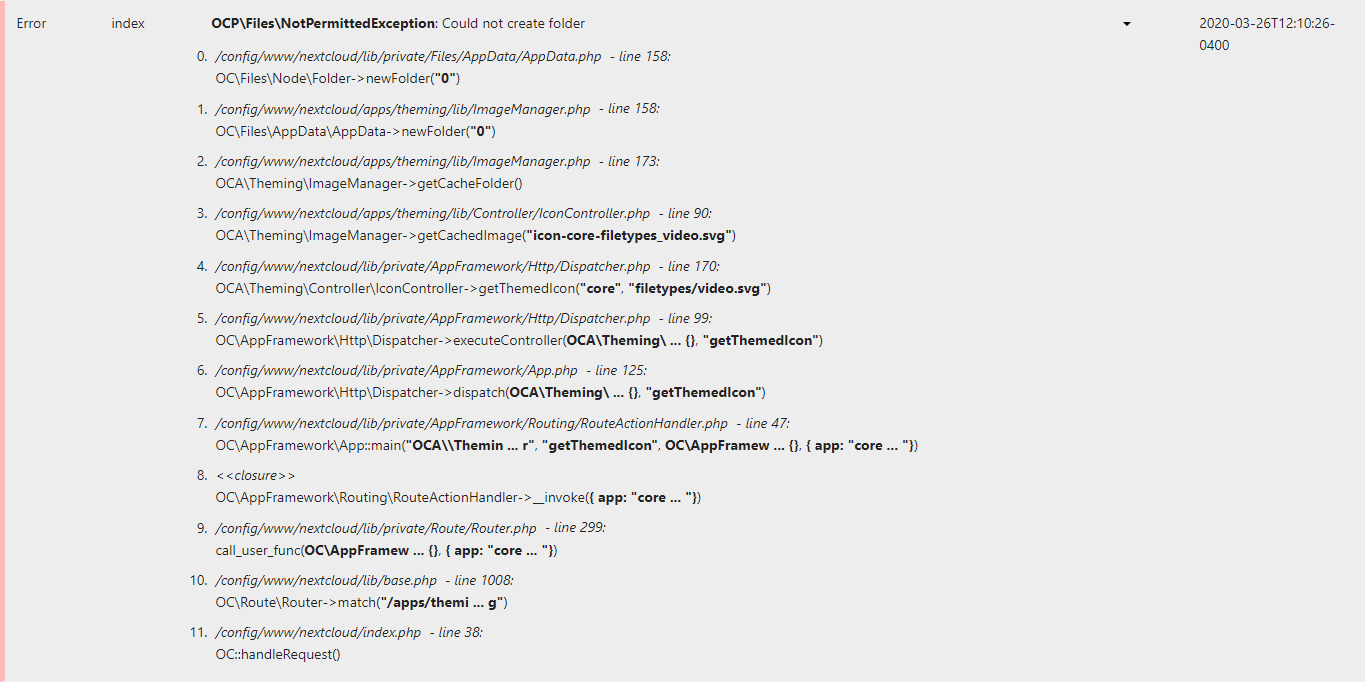

  21. Hello guys, I got the Nextcloud container working. However, when I go to logging i have these two errors. Can someone help me fix them or figure them out? I also added the extra arguments stated in the first page in the forum. [index] Error: OCP\Files\NotPermittedException: Could not create folder at <<closure>> 0. /var/www/html/lib/private/Files/AppData/AppData.php line 158 OC\Files\Node\Folder->newFolder("0") 1. /var/www/html/apps/theming/lib/ImageManager.php line 158 OC\Files\AppData\AppData->newFolder("0") 2. /var/www/html/apps/theming/lib/ImageManager.php line 173 OCA\Theming\ImageManager->getCacheFolder() 3. /var/www/html/apps/theming/lib/Controller/IconController.php line 90 OCA\Theming\ImageManager->getCachedImage("icon-core-filetypes_video.svg") 4. /var/www/html/lib/private/AppFramework/Http/Dispatcher.php line 170 OCA\Theming\Controller\IconController->getThemedIcon("core", "filetypes/video.svg") 5. /var/www/html/lib/private/AppFramework/Http/Dispatcher.php line 99 OC\AppFramework\Http\Dispatcher->executeController(OCA\Theming\Controller\IconController {}, "getThemedIcon") 6. /var/www/html/lib/private/AppFramework/App.php line 125 OC\AppFramework\Http\Dispatcher->dispatch(OCA\Theming\Controller\IconController {}, "getThemedIcon") 7. /var/www/html/lib/private/AppFramework/Routing/RouteActionHandler.php line 47 OC\AppFramework\App::main("OCA\\Theming\\C ... r", "getThemedIcon", OC\AppFramework\ ... {}, {app: "core",ima ... "}) 8. <<closure>> OC\AppFramework\Routing\RouteActionHandler->__invoke({app: "core",ima ... "}) 9. /var/www/html/lib/private/Route/Router.php line 299 call_user_func(OC\AppFramework\ ... {}, {app: "core",ima ... "}) 10. /var/www/html/lib/base.php line 1008 OC\Route\Router->match("/apps/theming/i ... g") 11. /var/www/html/index.php line 38 OC::handleRequest() GET /apps/theming/img/core/filetypes/video.svg?v=0 from 10.10.7.20 by Tucubanito07 at 2020-03-24T01:18:48+00:00 Here is the other error. Error: Cannot declare class OCA\Talk\Migration\Version2000Date20170707093535, because the name is already in use at /var/www/html/custom_apps/spreed/lib/Migration/Version2000Date20170707093535.php#127 POST /settings/apps/enable from 10.10.7.20 by Tucubanito07 at 2020-03-24T01:18:39+00:00
  22. Don’t feel bad. I have done the same thing lol.
  23. That is awesome. Your config file look different and that probably the reason why they were different. Well I am glad it’s working for you.
  24. Ok so this is how my fresh install looks like. I see a couple of different stuff in there not correctly, however, i am not an expert on this. Compare my config and yours and try to mimmick it. Obviously i place wording to explain what goes there. The Cron.php i would say it permission. I also see that you pick SQlite. I dont know how that would work. I always use MariaDB. <?php $CONFIG = array ( 'memcache.local' => '\\OC\\Memcache\\APCu', 'datadirectory' => '/data', 'instanceid' => 'This would be the Instance ID Nexcloud chooses', 'passwordsalt' => 'These Password are given by Nextcloud instance', 'secret' => 'These Password are given by Nextcloud instance', 'trusted_domains' => array ( 0 => '10.10.7.4:444', 1 => 'Address of the URL of your DNS if you are using Letsencrypt to see your Nexcloud Instance from Outside the network' ), 'dbtype' => 'mysql', 'version' => '18.0.2.2', 'overwrite.cli.url' => 'Address of the URL of your DNS if you are using Letsencrypt to see your Nexcloud Instance from Outside the network', 'overwritehost' => 'Address of the URL of your DNS if you are using Letsencrypt to see your Nexcloud Instance from Outside the network', 'overwriteprotocol' => 'https', 'dbname' => 'Database Name', 'dbhost' => 'IP Address of the Database:Port number', 'dbport' => '', 'dbtableprefix' => 'oc_', 'mysql.utf8mb4' => true, 'dbuser' => 'Database User You pick when setting up the database', 'dbpassword' => 'Your Password Obviously', 'installed' => true, );
