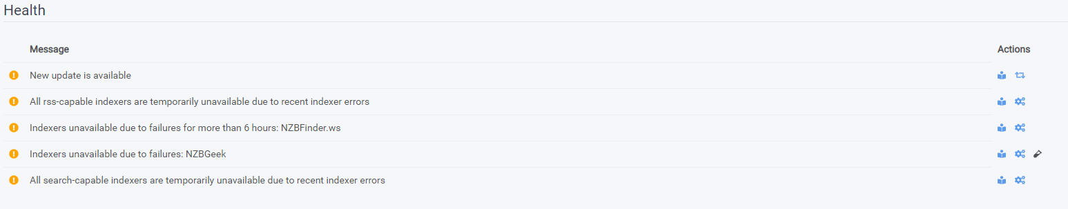

  2. Having two issues with the new version of Radarr, can't seem to track down what is happening. 1. The search is atrocious. If it finds anything at all, it will take 5 minutes, and then return random stuff. I see this constantly in the logs, searching for titles, tmbd, or imdb: 2021-3-1 17:00:13.6|Warn|SkyHookProxy|The SSL connection could not be established, see inner exception. Unable to read data from the transport connection: Connection reset by peer.: 'https://radarrapi.servarr.com/v1/search?q=fast%2B%26%2Bfurious&year=' [v3.0.1.4259] System.Net.WebException: The SSL connection could not be established, see inner exception. Unable to read data from the transport connection: Connection reset by peer.: 'https://radarrapi.servarr.com/v1/search?q=fast%2B%26%2Bfurious&year=' ---> System.Net.WebException: The SSL connection could not be established, see inner exception. Unable to read data from the transport connection: Connection reset by peer. ---> System.Net.Http.HttpRequestException: The SSL connection could not be established, see inner exception. ---> System.IO.IOException: Unable to read data from the transport connection: Connection reset by peer. ---> System.Net.Sockets.SocketException (104): Connection reset by peer --- End of inner exception stack trace --- 2. My indexers are constantly being "shut off for being un available". I have reset api keys, check them, and they work perfectly find for Sonarr... yet i see this all the time. (Screen shot attached). This is the error log, which I can't understand given that running the same creds on Sonarr works just fine. 2021-3-1 17:04:02.0|Warn|Newznab|Unable to connect to indexer [v3.0.1.4259] System.Net.WebException: The SSL connection could not be established, see inner exception. Unable to read data from the transport connection: Connection reset by peer.: 'https://api.nzbgeek.info/api?t=movie&cat=2000,2010,2020,2030,2035,2040,2045,2050,2060&extended=1&apikey=(removed)&offset=0&limit=100' ---> System.Net.WebException: The SSL connection could not be established, see inner exception. Unable to read data from the transport connection: Connection reset by peer. ---> System.Net.Http.HttpRequestException: The SSL connection could not be established, see inner exception. ---> System.IO.IOException: Unable to read data from the transport connection: Connection reset by peer. ---> System.Net.Sockets.SocketException (104): Connection reset by peer I must be missing something simple here... Version 3.0.1.4259 Package Version 3.0.1.4259-ls91 by linuxserver.io .NET Core Yes (3.1.10) Docker Yes DB Migration 188 AppData directory /config Startup directory /app/radarr/bin Mode Console Uptime 2d 07:48:58

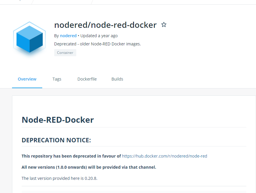

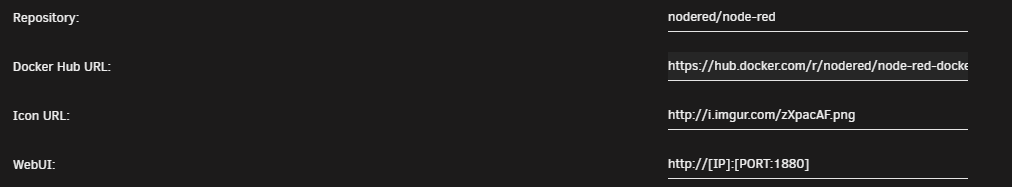

  3. So I went in and deleted the modules, one at a time backwards from when they were added. Removing these two modules allowed it to start and run as is did before: node-red-contrib-amazon-echo node-red-contrib-hue As for the current repo, i am a bit confused. I am using the official node red docker from CA... but, it seems to be pulling from the depreciated repo? When i check that out, it looks like it was depreciated: Should it be pulling from: https://hub.docker.com/r/nodered/node-red
