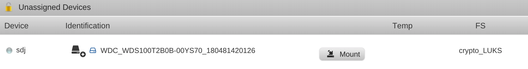

  6. Hi, This is just a small cosmetic request, please: I use lower case names for my Pools in Unraid 6.9.2 as I like the consistency with other names such as disk1, disk2 and ease-of-typing when using the terminal. But since they are acronyms such as SSD and TM (Time Machine), they look odd when shown in the UI as Ssd, Tm etc*. I wondered if it would be possible for you to stop auto-capitalising the first letter off Pool names in the UI please, so they show exactly as named? Like I said, just a small thing, but thought I would ask! Many thanks, Rich. (*I know they are acronyms and should be upper case, but this is just my preference for making the terminal approach the consistent one).
  7. Hi, It's funny you say that, before it started working (spoiler alert), the FS type was listed as btrfs in the FS column in UD. It's a SATA M.2 SSD. After I did the manual decrypt with cryptsetup in the Terminal, I thought I would test a mount via the UD GUI, which unfortunately still didn't work (same error). However I noticed that the FS type changed to crypto_LUKS: I wanted to send you a screenshot of the before and after, so rebooted to reset the encryption, but post-reboot the FS type was still crypto_LUKS, not back to btrfs. After entering the array passphrase I then tried a UD mount and it worked! Automount post-reboot also works as expected, so I'm delighted about that. I don't know whether it was the manual one-off cryptsetup or the reboot that resolved it, but all is now well. It might be hard to get to the bottom of it, but if there is anything further you'd be interested to see please do let me know. Thanks for your help, small Paypal retirement contribution incoming Rich.
  8. After seeing the output of the diagnostics, I decided to have a look for the successful mounting of the HDD from the array to see why that would be any different for /dev/sdd, but I'm not sure if the details of a successful mount are recorded in detail as part of the "unassigned.devices" logging? I was able to see the failed mount, for example: Mar 16 16:57:31 NAS unassigned.devices: Adding disk '/dev/sdj1'... Mar 16 16:57:31 NAS unassigned.devices: Mount drive command: /sbin/mount -t btrfs -o auto,async,noatime,nodiratime '/dev/sdj1' '/mnt/disks/WDC_WDS100T2B0B-00YS70_180481420126' Mar 16 16:57:31 NAS unassigned.devices: Mount of '/dev/sdj1' failed. Error message: mount: /mnt/disks/WDC_WDS100T2B0B-00YS70_180481420126: wrong fs type, bad option, bad superblock on /dev/sdj1, missing codepage or helper program, or other error. Mar 16 16:57:31 NAS unassigned.devices: Partition 'WDC_WDS100T2B0B-00YS70_180481420126' could not be mounted... Looking in the logs at how the encrypted disks in the array are unlocked using "cryptsetup" and then mounted, I replicated this manually via the Terminal for /dev/sdj1 and it mounted successfully, so I have a manual workaround for now from which I can run VMs: root@NAS:/mnt# cryptsetup luksOpen /dev/sdj1 sdj1 Enter passphrase for /dev/sdj1: root@NAS:/mnt# mount -t btrfs -o auto,async,noatime,nodiratime '/dev/mapper/sdj1' '/mnt/disks/test' root@NAS:/mnt# cd /mnt/disks/test root@NAS:/mnt/disks/test# ls root@NAS:/mnt/disks/test# ls -la total 16 drwxrwxrwx 1 nobody users 0 Mar 16 16:50 ./ drwxrwxrwx 3 nobody users 60 Mar 16 20:27 ../ root@NAS:/mnt/disks/test# However it would be great to be able to use Unassigned Devices to have this happen automatically using the same passphrase as entered to start the array after each boot, then all will be mounted and ready for the VM services to start. I think the key is to work out why /dev/sdd mounted using the array passphrase but /dev/sdj will not. Thanks for your help, Rich.
  9. Hi, thanks for getting back to me already. Diagnostics file attached. Thanks, Rich. nas-diagnostics-20180316-1903.zip
