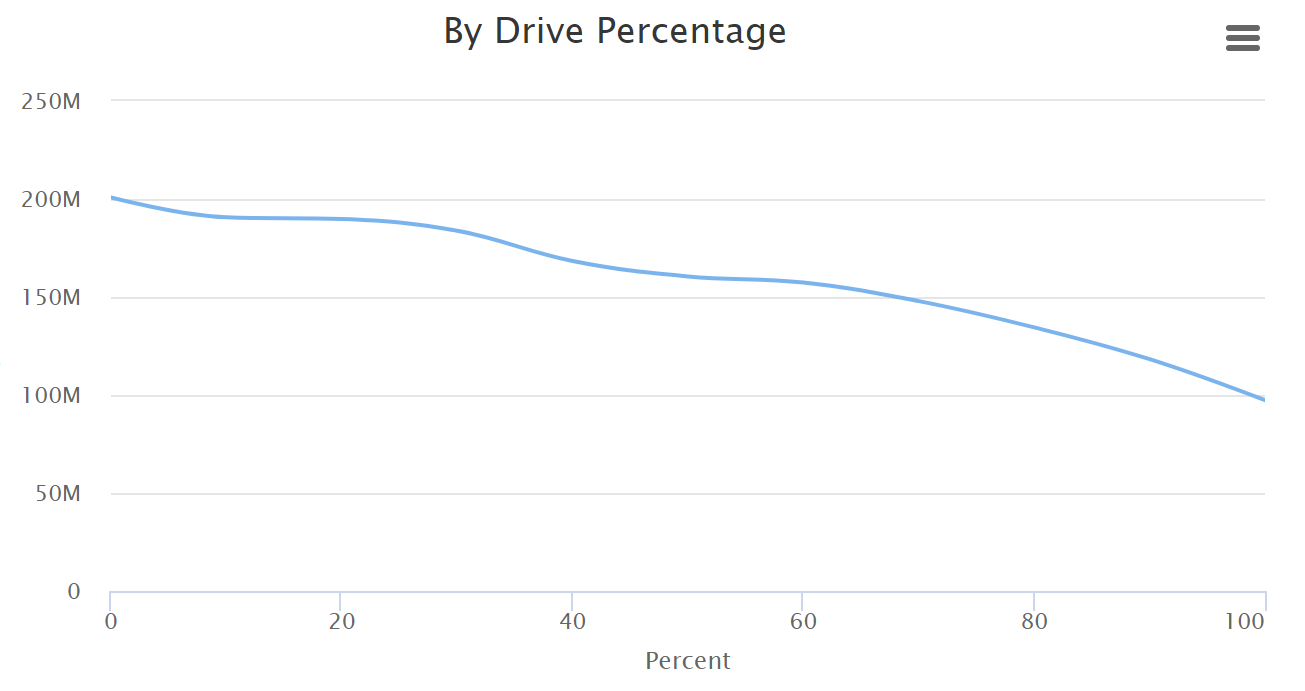

  19. I wouldn't know how to check, but I didn't get any pop ups or anything akin to that. Where can I find if SpeedGap was detected? The Blue line was a test done at the default %, I believe, so perhaps that skewed the results? Turned off all my Dockers (Don't have any VMs) and ran the test again, this time at 10% and turned on the SpeedGap setting just to see what would happen. Still a bit wobbly but much less so than my original blueline. I will do another 1% test soon. By the way, since this program/script relies on me testing the drives every so often, what can I use to schedule a test every week or every month? Im quite new to unraid, but I'm sure there's a way to trigger this. Thanks!

  21. All of you have such smooth curves for all your drives. I recently shucked a WD MyBook 8TB helium drive and I am getting very wobbly lines... I take it I need to turn off dockers while testing?
