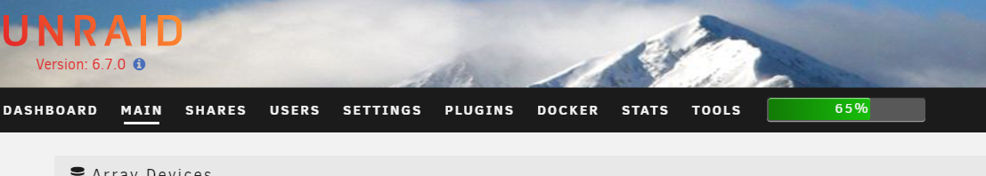

  5. Got the update prompt 3 min ago, clicked it, plugin updated just fine. Now... no Apps tab!

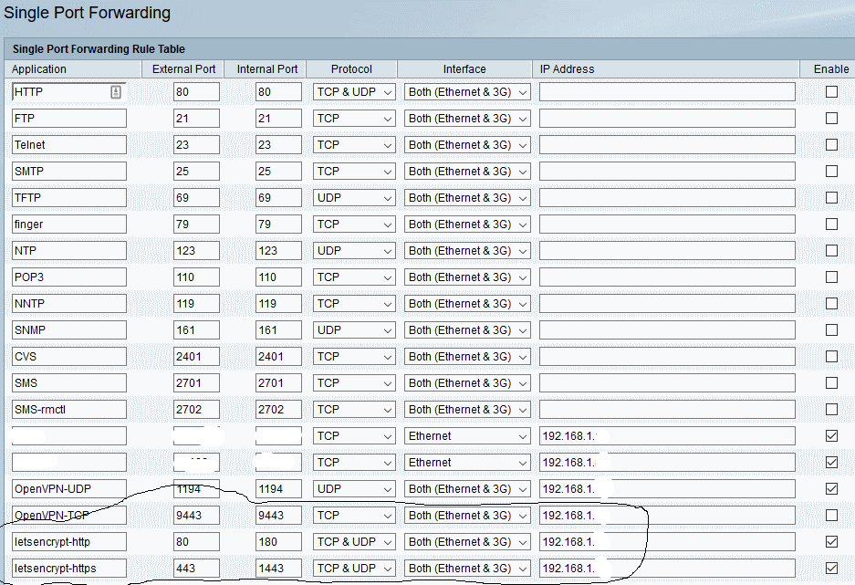

  6. Damn good catch, God knows how Cisco interprets "rule is first but is disabled." I'll give it a shot, thanks for taking a look!
  7. Yes and yes, as per the video... Ed is really thorough about these things. Like I said, I wanted to get at least Radarr and Sonarr working as I know Nextcloud can be a little more work. Getting worried that my ISP (Rogers in Toronto, Canada) is blocking port 80, that would be a hell of a kick in the nuts! So, the screenshots! And, by the by, thanks for replying... it's appreciated!

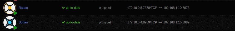

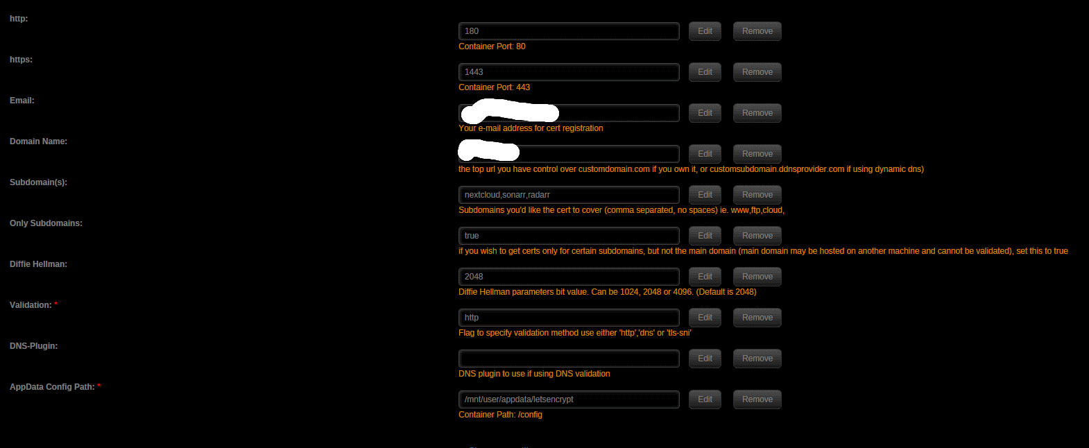

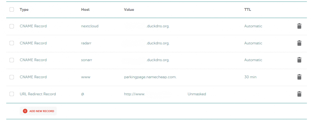

  8. My tale of woe: Followed SpaceinvaderOne's lovely video all the way through, successfully... except I still can't see my site, when trying to navigate to it off my phone (so not on the home WiFi!); am using Namecheap for my domain name. Port forwarding settings / namecheap settings / docker setting screenshots attached. Logs are all fine, letsencrypt below. Can ping all three subdomains (radarr/sonarr/nextcloud) but can't even get into the first two -- I'm aware nextcloud might take more finagling, left that one to last. Any ideas?
