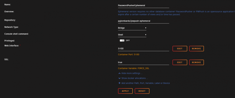

  24. So I got this all working, but how can I setup logins and so forth with it. I do not even see that option on my instance of pwpush.
