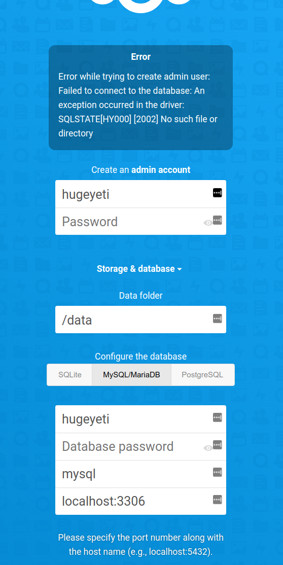

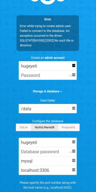

March 26, 20215 yr @CorneliousJD this bit: "... but it is SLOW. Slow to navigate to site page, slow going between apps." Do you have other alternatives in mind? I've tried to install nextcloud with mariadb,mysql,postres and I can't install it yet because of db errors about the password or user not correct. I dabbled in the CLI creating the db name, root name, password, user pass and no dice so far. I decided to try sqlite which is the default but there is a warning about not using sqlite for production environments. I do have 2 NVME's as cache and I am hoping the slowness you mentioned would be mitigated by this available cache (2TB each) as soon as I find out how to configure nextcloud w/ postgres.
March 26, 20215 yr 7 minutes ago, Huge Yeti said: @CorneliousJD this bit: "... but it is SLOW. Slow to navigate to site page, slow going between apps." Do you have other alternatives in mind? I've tried to install nextcloud with mariadb,mysql,postres and I can't install it yet because of db errors about the password or user not correct. I dabbled in the CLI creating the db name, root name, password, user pass and no dice so far. I decided to try sqlite which is the default but there is a warning about not using sqlite for production environments. I do have 2 NVME's as cache and I am hoping the slowness you mentioned would be mitigated by this available cache (2TB each) as soon as I find out how to configure nextcloud w/ postgres. SQLite's performance is awufl too, would recommend swapping that out right away. If you're having trouble w/ Postgres, I'd install the Linuxserver MariaDB docker container and use either Adminer or PHPMyAdmin (probalby easier of the 2) so you can get a GUI-based managemetn interface for your MariaDB to easily add a user/database.

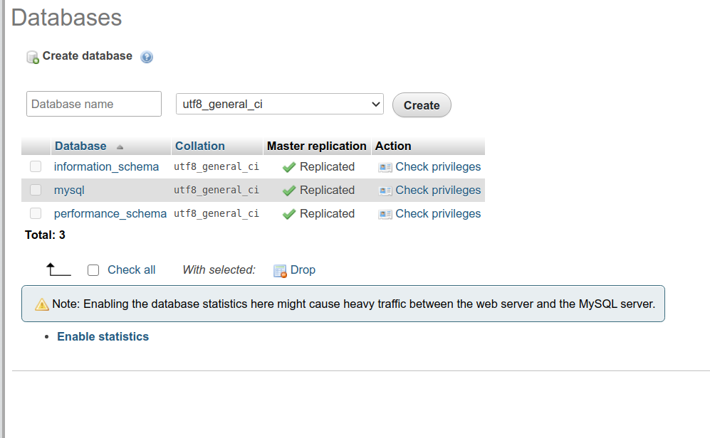

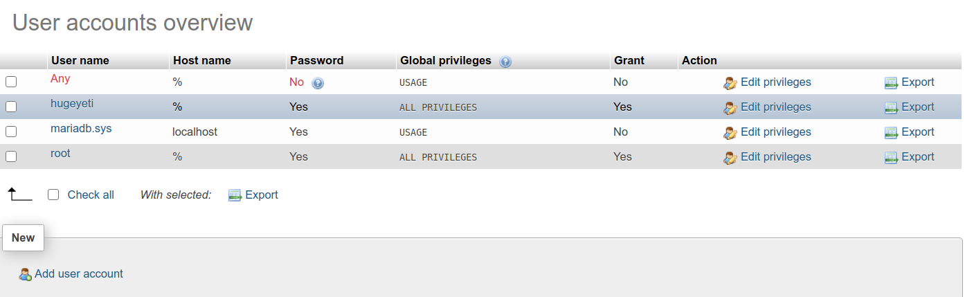

March 26, 20215 yr 2 minutes ago, CorneliousJD said: SQLite's performance is awufl too, would recommend swapping that out right away. If you're having trouble w/ Postgres, I'd install the Linuxserver MariaDB docker container and use either Adminer or PHPMyAdmin (probalby easier of the 2) so you can get a GUI-based managemetn interface for your MariaDB to easily add a user/database. Excellent. I will try this sequence of steps and keep you all posted. Thanks!
March 26, 20215 yr 26 minutes ago, Huge Yeti said: Excellent. I will try this sequence of steps and keep you all posted. Thanks! I must be missing some variable to be correctly filled out or something I missed/not-aware-of.

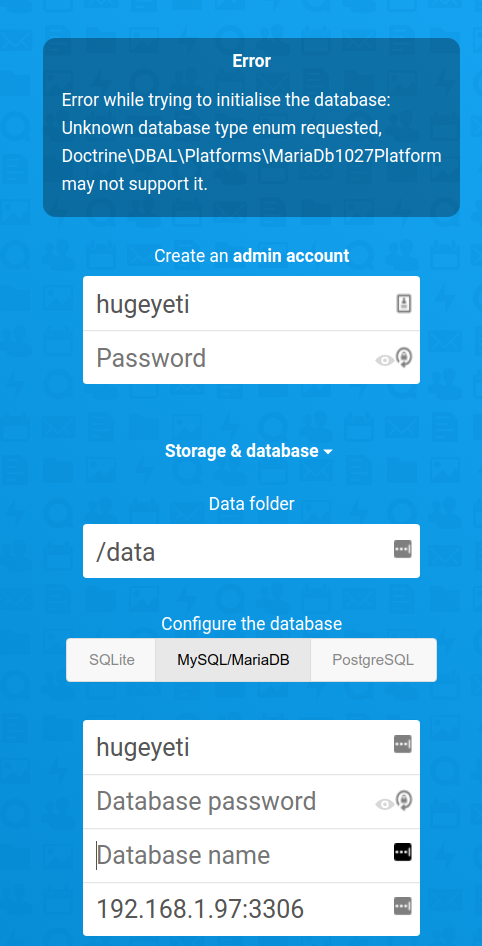

March 26, 20215 yr 4 minutes ago, Huge Yeti said: I must be missing some variable to be correctly filled out or something I missed/not-aware-of. Localhost amended and seems to recognize the db but with the following error:
March 26, 20215 yr 2 hours ago, Huge Yeti said: Localhost amended and seems to recognize the db but with the following error: You should reach out in the nextcloud container support thread instead of here actually. But you need to create a database too, not just a user. Also I would *not* recommend to not have a password. You may want to look up a tutorial or video on setting up nextcloud on unRAID. It should walk you thru everything.
March 29, 20215 yr On 3/26/2021 at 5:10 PM, CorneliousJD said: You should reach out in the nextcloud container support thread instead of here actually. But you need to create a database too, not just a user. Also I would *not* recommend to not have a password. You may want to look up a tutorial or video on setting up nextcloud on unRAID. It should walk you thru everything. Tutorial worked great! up and running w/ Mariadb. I noticed, like you said, it is a tad slow, but sufficient for my needs.

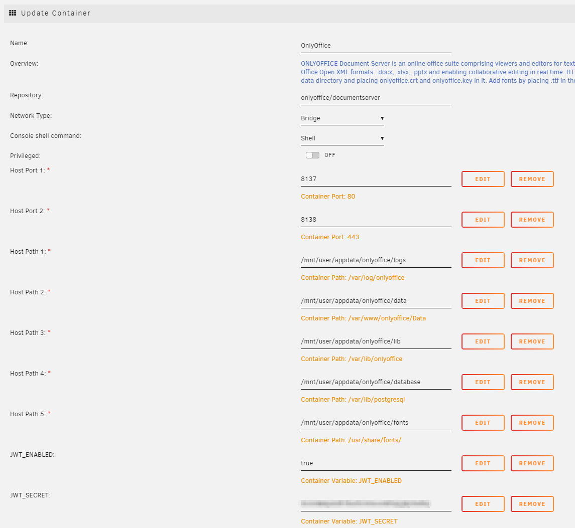

February 2, 20224 yr 23 hours ago, CorneliousJD said: I honestly chased this for months/years. Never got any better honestly. I just eventually gave up on Nextcloud completely. I wasn't willing to run dedicated VM for it, so that was out of question for me. I ended up installing FileRun in place of Nextcloud, and it is BLAZING fast in comparison. Unbelievably so honestly, and it does what i needed from Nextcloud. All the extra nextcloud crap I didn't use was probably contributing to the slowdowns so it feels good to ditch that and move on honestly. Good luck to anyone who continues to chase NC performance. I've seen countless threads and posts about it, and usually people just blame the OP for it being slow for "doing something wrong" but I never see the threads actually get RESOLVED with someone saying they found/fixed their performance issues. GL;HF Kinda hijacking this thread at this point, but with Filerun have you tried getting only office working with Filerun? I try and avoid google services as much as possible, so would prefer to get it working with only office if possible.
February 2, 20224 yr 36 minutes ago, InfInIty said: Kinda hijacking this thread at this point, but with Filerun have you tried getting only office working with Filerun? I try and avoid google services as much as possible, so would prefer to get it working with only office if possible. yes, very easy to get it working w/ FileRun! I installed the onlyoffice/documentserver container, set JWT enabled and created a JWT secret (this protects my onlyoffice from random public use) and threw it behind my reverse proxy, and pointed FileRun to it and gave it the JWT secret so it can authenticate. NOTE: I could not get it to work unless I put it behind my reverse proxy, but the JWT token makes that not a concern. That's it. easy peasy If needed, here's the bottom two variables referencing JWT, you'll need to add those yourself - as the template doesn't have them included by default.
