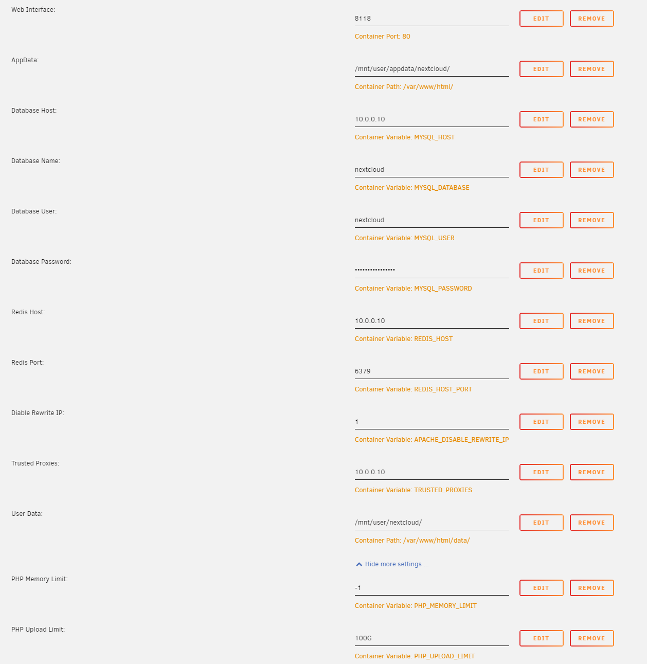

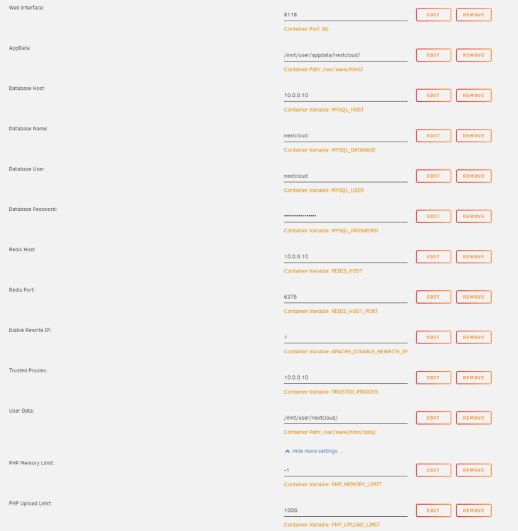

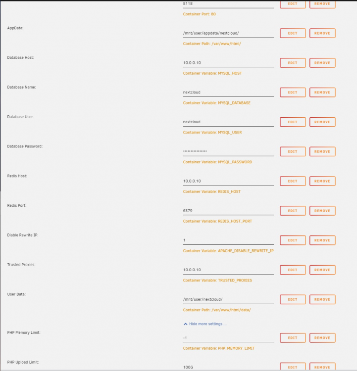

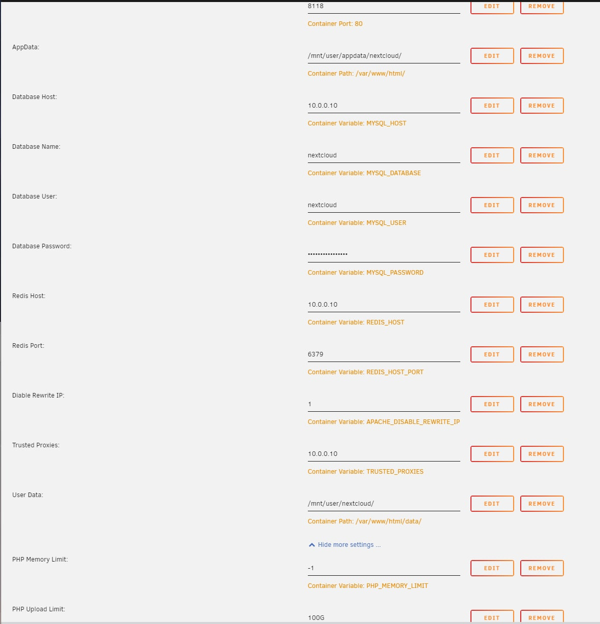

July 22, 20224 yr 44 minutes ago, JonathanM said: What exactly did you do? Were you able to continue to use your appdata and existing database, or did you start over? I had started completely over, however I'm sure you could get it to work with your existing data but I had given up on nextcloud for months and started using Filerun instead, but Filerun had it's own problems sadly. This got me motivated to figure out what the heck was going on with Nextcloud again and I started with the official image. My docker config for it is attached, and here's relevant config.php info as well. I even setup Collabra server as a seprate docker and have all that working as well. Passing with A+ security rating and no issues/warnings found in the instance at all, so far so good! It's been a long process to tweak to this point but hopefully this gives you a good starting point! Note that I also setup system cron via unraid userscripts running at */5 * * * * #!/bin/bash docker exec -u www-data Nextcloud php cron.php Sanitized config.php <?php $CONFIG = array ( 'htaccess.RewriteBase' => '/', 'memcache.local' => '\\OC\\Memcache\\APCu', 'apps_paths' => array ( 0 => array ( 'path' => '/var/www/html/apps', 'url' => '/apps', 'writable' => false, ), 1 => array ( 'path' => '/var/www/html/custom_apps', 'url' => '/custom_apps', 'writable' => true, ), ), 'memcache.distributed' => '\\OC\\Memcache\\Redis', 'memcache.locking' => '\\OC\\Memcache\\Redis', 'redis' => array ( 'host' => '10.0.0.10', 'password' => '', 'port' => 6379, ), 'trusted_proxies' => array ( 0 => '10.0.0.10', ), 'instanceid' => 'xxx', 'passwordsalt' => 'xxx', 'secret' => 'xxx', 'trusted_domains' => array ( 0 => '10.0.0.10:8118', 2 => 'cloud.domain.com', ), 'datadirectory' => '/var/www/html/data', 'dbtype' => 'mysql', 'version' => '24.0.3.2', 'overwrite.cli.url' => 'https://cloud.domain.com', 'overwriteprotocol' => 'https', 'trashbin_retention_obligation' => '30, 30', 'default_phone_region' => 'US', 'dbname' => 'nextcloud', 'dbhost' => '10.0.0.10', 'dbport' => '', 'dbtableprefix' => 'oc_', 'mysql.utf8mb4' => true, 'dbuser' => 'nextcloud', 'dbpassword' => 'xxx, 'installed' => true, 'twofactor_enforced' => 'true', 'twofactor_enforced_groups' => array ( 0 => 'admin', ), 'twofactor_enforced_excluded_groups' => array ( ), ***EMAIL CONFIG REDACTED*** 'enable_previews' => true, 'enabledPreviewProviders' => array ( 0 => 'OC\\Preview\\TXT', 1 => 'OC\\Preview\\MarkDown', 2 => 'OC\\Preview\\OpenDocument', 3 => 'OC\\Preview\\PDF', 4 => 'OC\\Preview\\MSOffice2003', 5 => 'OC\\Preview\\MSOfficeDoc', 6 => 'OC\\Preview\\Image', 7 => 'OC\\Preview\\Photoshop', 8 => 'OC\\Preview\\TIFF', 9 => 'OC\\Preview\\SVG', 10 => 'OC\\Preview\\Font', 11 => 'OC\\Preview\\MP3', 12 => 'OC\\Preview\\Movie', 13 => 'OC\\Preview\\MKV', 14 => 'OC\\Preview\\MP4', 15 => 'OC\\Preview\\AVI', ), 'loglevel' => 2, 'maintenance' => false, );

February 7, 20233 yr I know I'm reviving an old thread, but I'm following the example of @CorneliousJD and have a few questions. Hopefully he sees this... When I try to set the `APACHE_DISABLE_REWRITE_IP` container variable it fails to start and I get an error in the logs `Could not remove /etc/apache2/conf-enabled/remoteip.conf: Permission denied`. If I remove that variable it starts and seems to work fine. I have `trusted_proxies` setup in config.php and everything seems to work. Do I need to fix this? What exactly does this variable do? I see in your config.php that you are using a preview provider. I see mention of using Imaginary in the docs for tuning, but you don't give a url for the imaginary instance. Is Imaginary built into this container? Or how does that work? The good news is that so far it's running MUCH faster and seems like everything is working. Thanks in advance!
February 8, 20233 yr 8 hours ago, shooga said: I know I'm reviving an old thread, but I'm following the example of @CorneliousJD and have a few questions. Hopefully he sees this... When I try to set the `APACHE_DISABLE_REWRITE_IP` container variable it fails to start and I get an error in the logs `Could not remove /etc/apache2/conf-enabled/remoteip.conf: Permission denied`. If I remove that variable it starts and seems to work fine. I have `trusted_proxies` setup in config.php and everything seems to work. Do I need to fix this? What exactly does this variable do? I see in your config.php that you are using a preview provider. I see mention of using Imaginary in the docs for tuning, but you don't give a url for the imaginary instance. Is Imaginary built into this container? Or how does that work? The good news is that so far it's running MUCH faster and seems like everything is working. Thanks in advance! So glad you're seeing the same speed improvements, I have been running and using Nextcloud this way for months now and it is so much better! 1. Looks like others on github have had your same issue w/ the disable rewrite IP issue: https://github.com/nextcloud/docker/issues/1494 For what it's wroth I am NOT running into that issue though. I'm not sure if you need it though, iirc it's for logging? Going off memory here tho. Here's my whole setup (Below) 2. the image providers are built-in -- you do need to install ffmpeg for video previews, but i have that on a 7AM recurring cron job to install it into the container (so it survives container rebuilds) but all the others should be baked in by default already.
February 8, 20233 yr Thanks again, @CorneliousJD! This has renewed my faith/interest in using Nextcloud. I added the preview providers via config.php. I just copied your block and tried it with the video previews still in to see what would happen. Turns out .mp4 and .mov previews work without installing ffmpeg. I was surprised, but I'm not complaining... Edit: I take back what I said. I think I misunderstood what they meant by previews. The videos will play inside Nextcloud when I click them, but there's no thumbnail. Maybe that's what the preview is? Would you mind sharing your script to install ffmpeg so I can give it a try? In this documentation they recommend using their Imaginary container to speed up previews, but the performance is quite fast for me right now so I don't see the point. Edited February 8, 20233 yr by shooga
