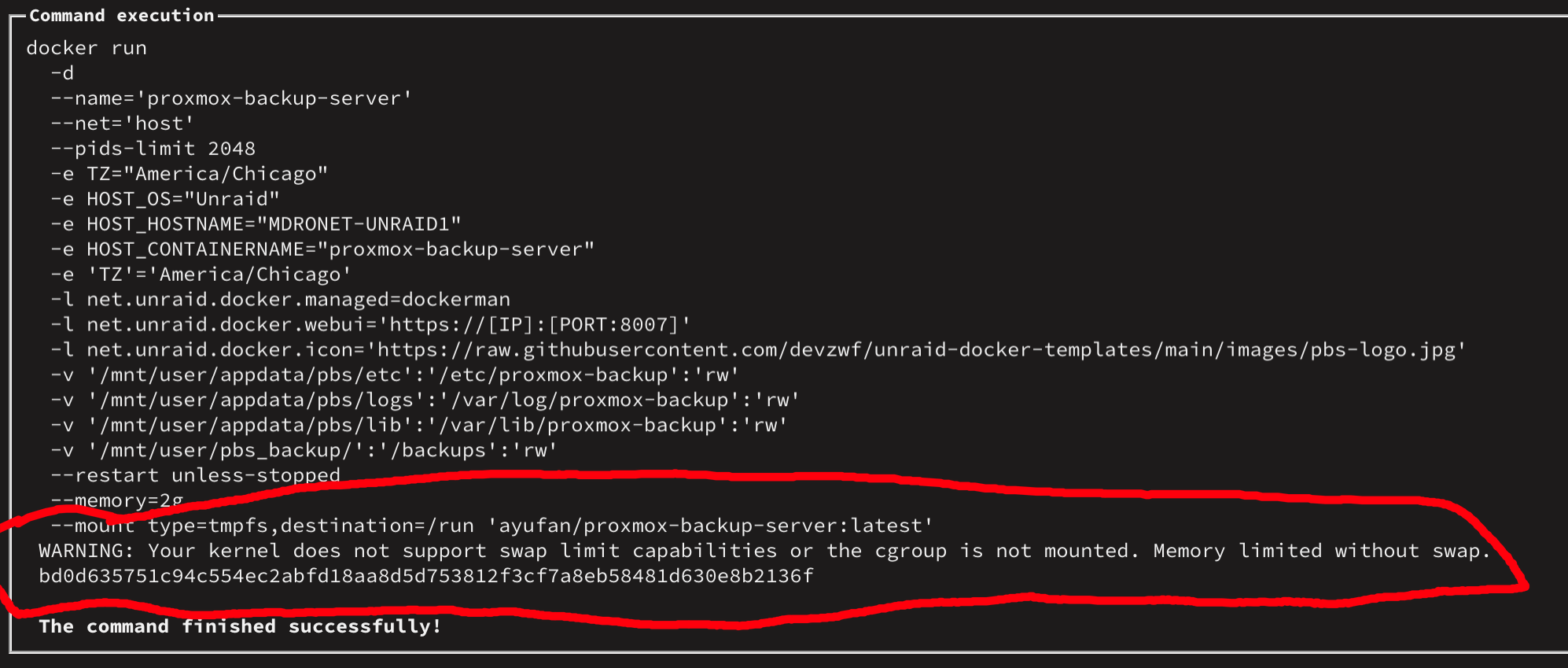

  5. i have many times =( I can try it again. also just an FYI i loaded the PDM as well, same issue, cannot get to web interface.. Something is strange with these two. Only happens with these. All other containers have installed with zero issues. Have been running this server for 10+ years.. on 7.2 now if that makes any difference.. EDIT: Same issue, deleted, cleared everything, no luck.. Appreciate the help but i dont know what is wrong. I did notice this on install.

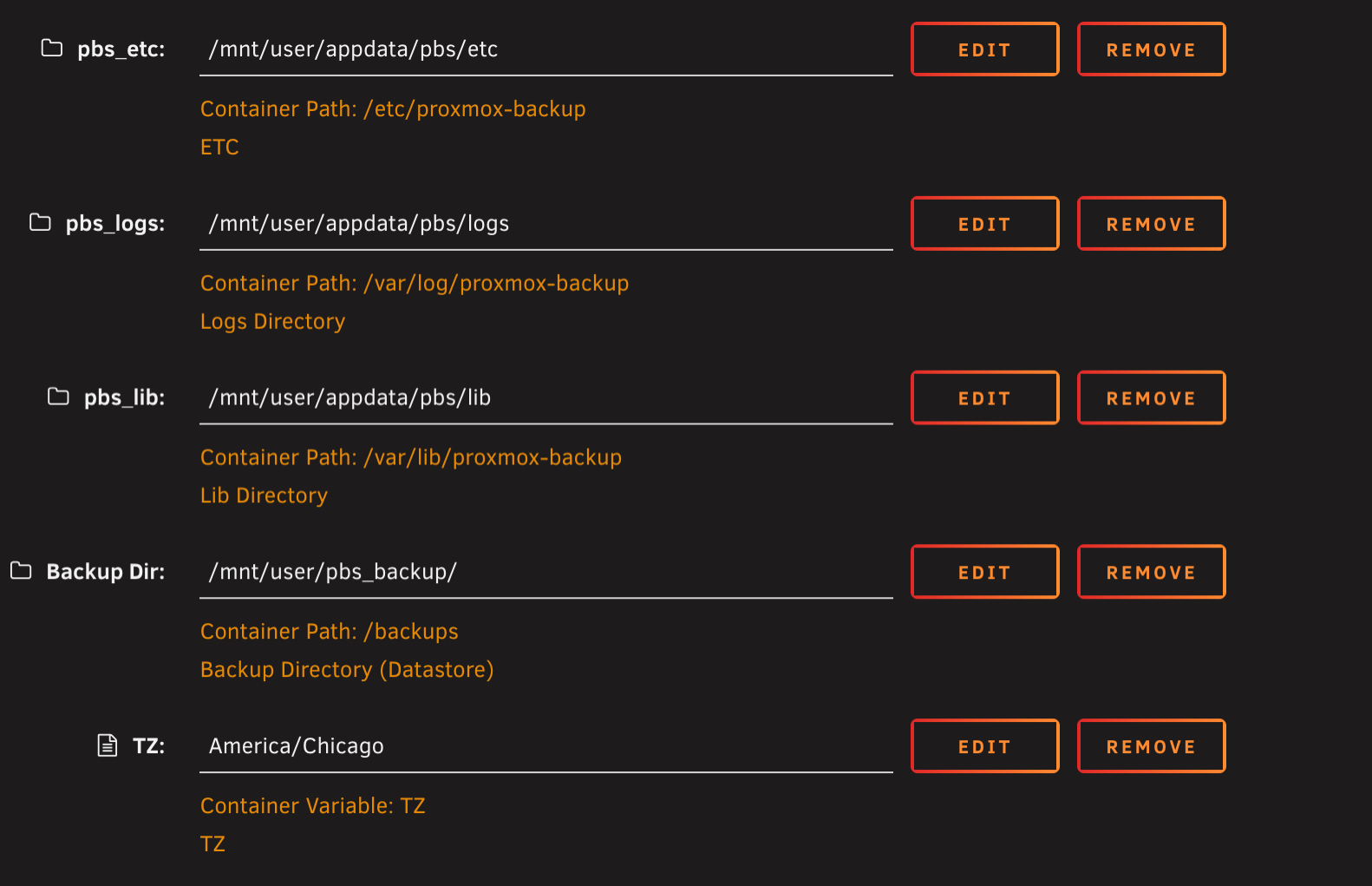

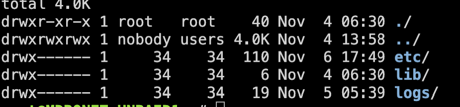

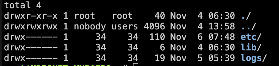

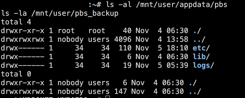

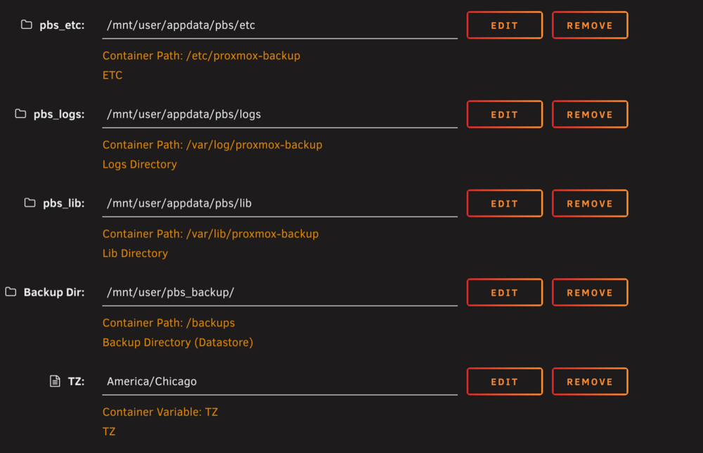

  6. maybe i am being dense but can you explain to me how the FS says otherwise? Your screenshot matches mine exactly and above you said i have mine set to this below, but the template is set that way as well? I don't get what I am missing. Seem like your directory are not correctly set for /etc/proxmox-backup. you have set /mnt/user/appdata/pbs/etc but the etc. directory seems to be in /mnt/user/pbs_backup
  7. Hmm, like i said above i did not change anything. I just took the defaults of the container.. so that is strange..
  8. Its just the standard appdata path /mnt/user/appdata where all my other docker containers reside, all permissions are ok there. Is there something specific i need to do for this that i missed somewhere? Everything i left default.

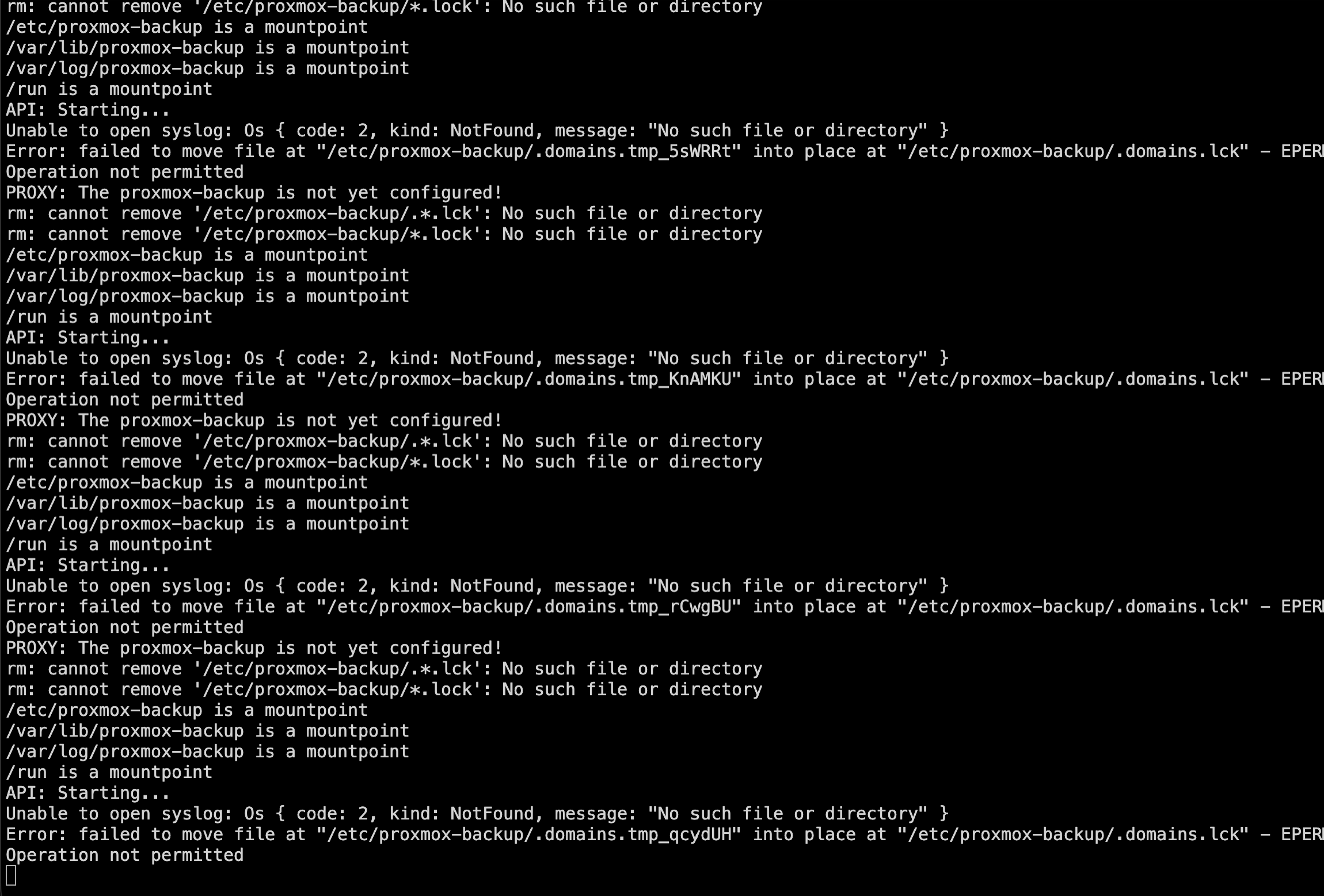

  9. Hello, I installed this for the first time and nothing comes up from the webui. Took all the defaults, only changed the Timezone.. Any idea what the issue is? Here is what the log says
