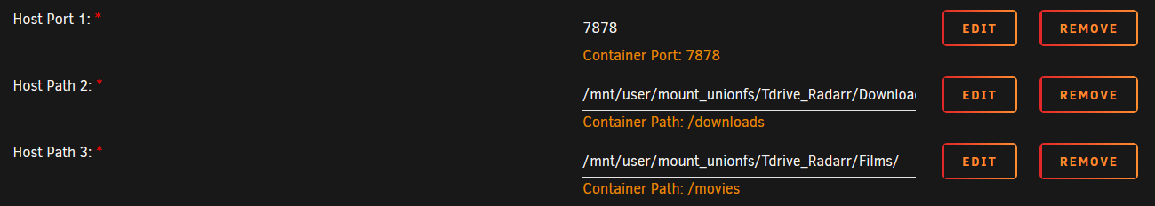

You download to the merge folder but it will write to your ssd. Rclone uploads the files from your sad. - Guide: How To Use Rclone To Mount Cloud Drives And Play Files
