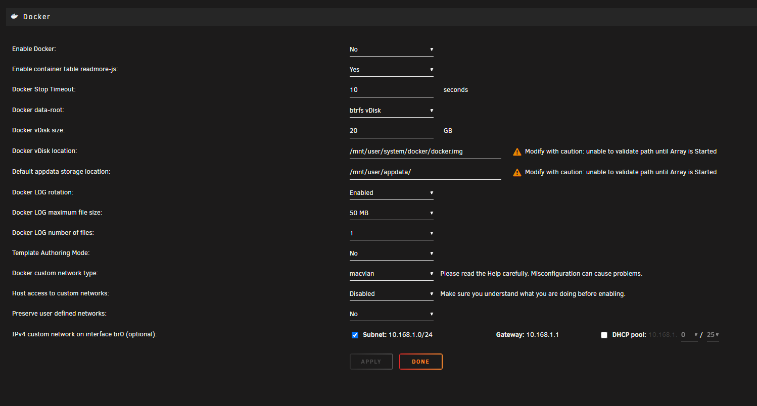

  12. Hey @JorgeB, I replaced my PSU and USB stick again this week but the problem persists - my first boot with the new hardware, I verified that Docker was set to ipvlan and started the array. Within a few moments it crashed. On the next boot, I went back to view docker settings, and as expected, the network type has reverted to macvlan - see image below. Any possible explanation for why this in particular seems to be resetting? if my docker.cfg or network settings are somehow corrupted, is there a way to restore? not making a lot of sense to me right now. This server has been running for many years, with lots of er, tinkering throughout that time it's quite possible I've done something odd with my network configs too, per edit 2 below. Any best practice to eliminate possible issues here? Edit - added diagnostics and the docker (after).cfg file from the flash, obtained on the 2nd boot. I also included docker (before) which is a copy of what I moved to my new flash drive last night. - you can see that a bunch of the docker settings are absent in the 'after' file. Edit 2 - looking at my docker (before), is DOCKER_CUSTOM_NETWORKS=" " a valid value to have in there? seems to be where the files first differ nostromo-diagnostics-20230923-0928.zip docker (before).cfg docker (after).cfg
