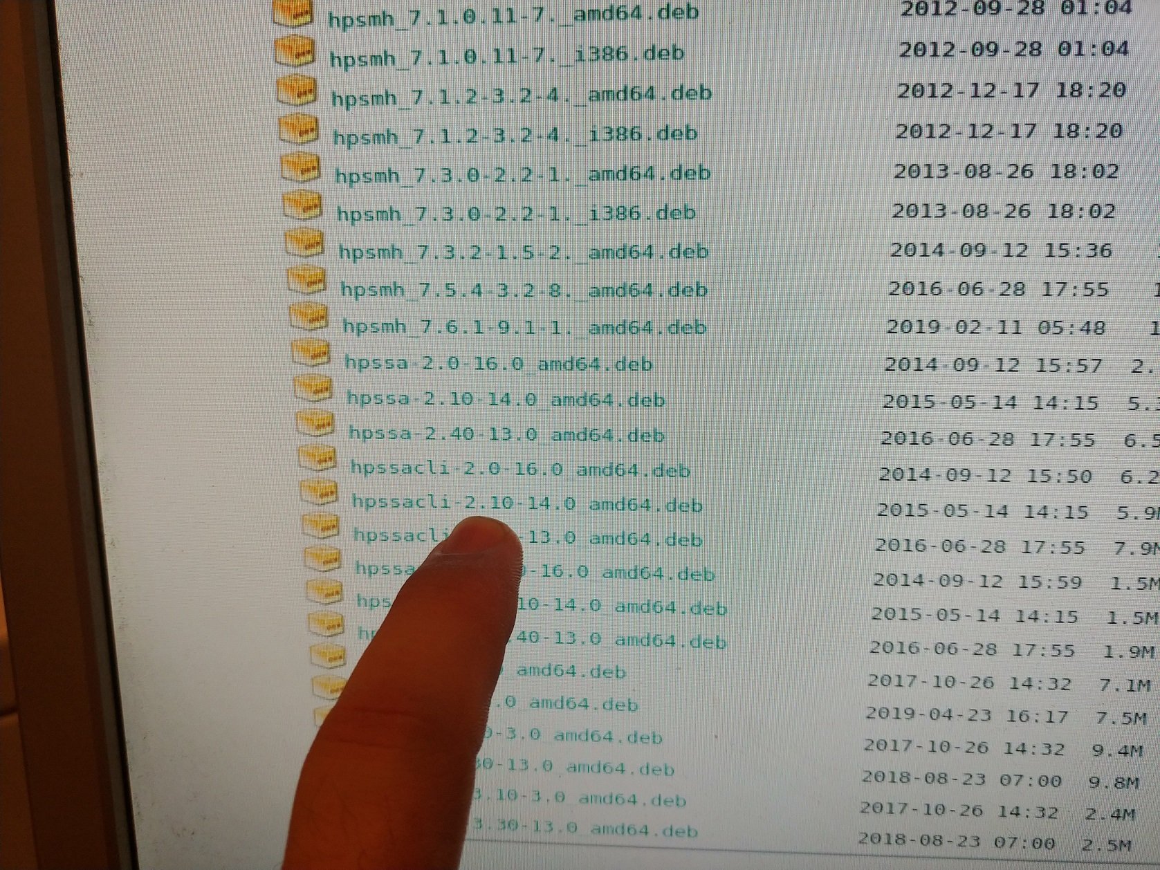

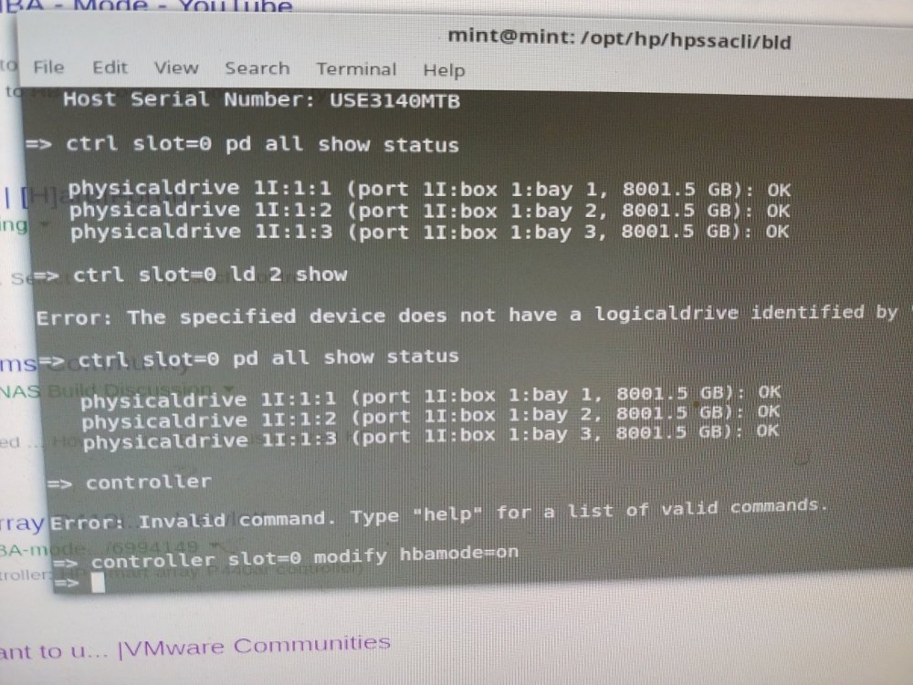

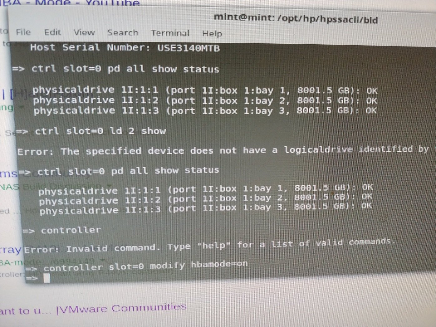

I figured it out. Here's what I did. Make a bootable Linux Mint USB. https://linuxmint.com/download.php Boot it up and go download hpssacli-2.10-14.0_amd64.deb from here. https://downloads.linux.hpe.com/SDR/repo/mcp/pool/non-free/ Install it and navigate to /opt/hp/hpssacli/bld and run this command: controller slot=0 modify hbamode=on You're done. This is exactly what I did and it worked for me. All my drives show up now except my cache SSD, even though it was before, but I don't know if this is related or not. I don't think it is.
