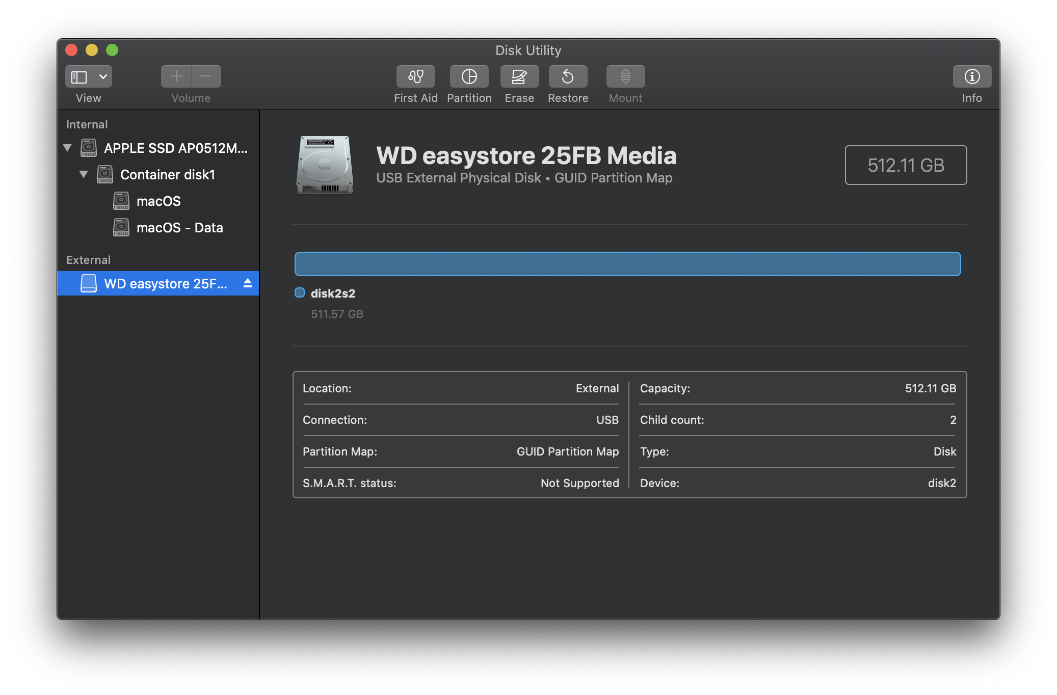

Sorry, should have known better. Attached. Here's what else I've found in the meantime: - Yesterday morning I added 2 new 12TB WD drives. I replaced the 2 10TB WD drives you see listed in my screenshot with the new ones. Parity is currently rebuilding. - I pulled out the SSD I am having an issue with and mounted it on macOS. macOS can't read/repair the disk, but it is labeled as "WD easystore 25FB Media" which is totally bizarre. tower-diagnostics-20200126-1057.zip

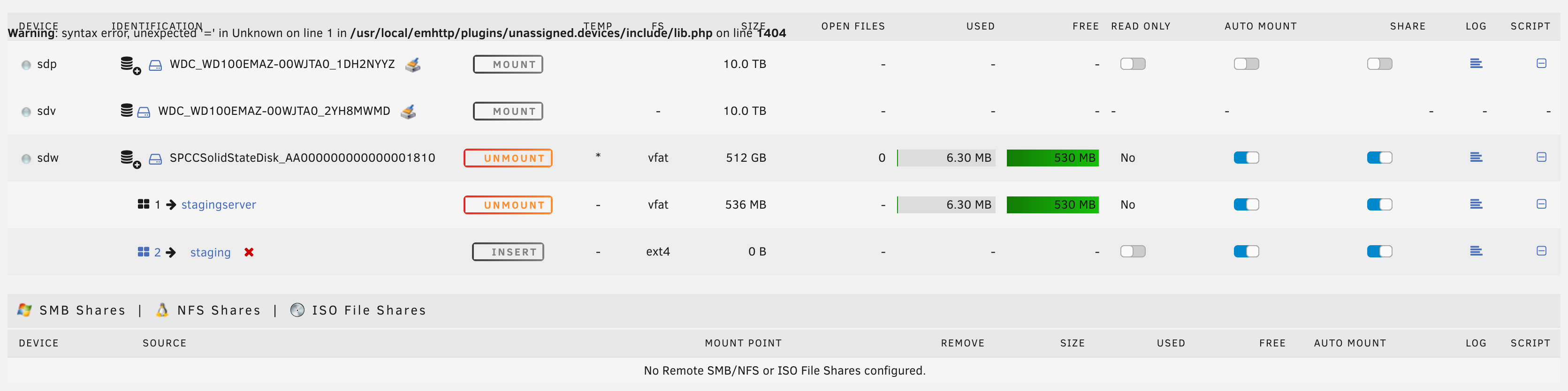

I've run into an issue where my Ubuntu Server VM is no longer mounting/loading the correct partition and I have no idea what/how it happened? Basically it's booting off of the EFI partition and wants to do a clean install. This is what I see on the Main page on Unraid (attached) Originally it was working when I had the vDisk location set to "/dev/disk/by-id/ata-SPCCSolidStateDisk_AA000000000000001810". Now that I see two paritions on the main screen, I've tried setting this to "/dev/disk/by-id/ata-SPCCSolidStateDisk_AA000000000000001810-part2", but no luck. How do I get UD to mount the correct parition?

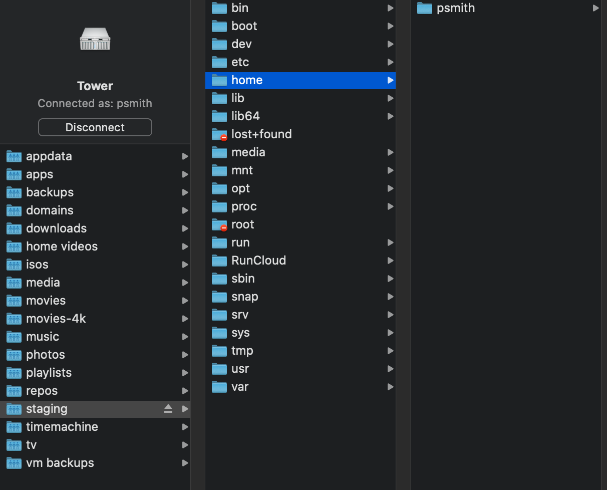

Is it possible to access my UD share with a different user/pass combo than I would be using for my main Unraid access? See attached image for a better explanation. - I am connecting to Unraid SMB as user psmith - I have a UD named staging shared. A Ubuntu VM is installed on the UD and also has a user psmith - I can access the UD over SMB, but I only have access to the psmith home folder. This all makes senes. - Ideally, I would like to mount the UD share locally as root (or any user other than psmith, for that matter)
