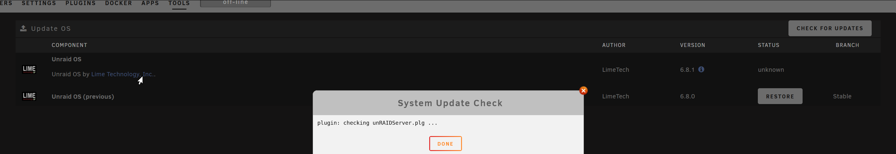

  10. I've had to move a few times over last couple of years and rack was offline for a while. Now plugging everything back in, I am trying to figure out what's the best way to update Unraid, plugins, and containers to most recent versions? OS update seems to get stuck on the below:

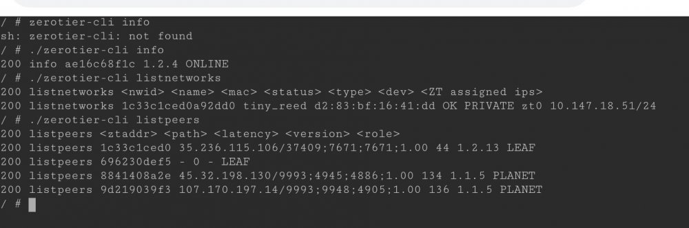

  14. oleg-123 started following Dmitry Spikhalskiy
