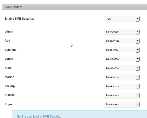

Here the output: games ftpjee ftpjee is a user, games not. All other user are not listed.
Only one [Config] section but nothing after the last smb user. [Config] smb_security = "yes" smb_admin = "no-access" smb_fred = "read-write" smb_delphine = "read-only" smb_yohan = "no-access" smb_dune = "no-access" smb_marine = "no-access" smb_backup = "no-access" smb_hp8600 = "no-access" smb_ftpuser = "no-access" smb_ftpjee = "no-access"
Click on the 'Help' button then click on the 'Download" button and download the log. Then post it so I can review it. here is the log file : i only want to mount and share the WD disk, i don't use the ST disk. Go to the command line and get a copy of this file: /etc/samba/unassigned-shares/BACKUP_DD.conf and post it. This will show the read and write privileges of the share. I don't understand : "invalid users = @users" => I enabled SMB Security in the Plugin settings and set R/W for me and Read-only for an other user! What that means is that unassigned devices does not think you have any valid users set. Check the settings in the Unassigned Devices Settings. I did a little testing and can't reproduce the problem. If it continues for you, give me more information on your user settings. Edit: I've added a log error message for this so this situation will be seen easily. Here a screenshot of my user settings in Unassigned. I use "fred" acces After many testing it's very strange: - if i set Read/write for the last user (ftpjee) i lost all acces to the share - if i disable SMB security i have Read/Write access - if i return to my user settings i have again read only acces I removed the plugin and installed it again but there is no change... unraid-unassigned.devices-20160125-0207.zip
Click on the 'Help' button then click on the 'Download" button and download the log. Then post it so I can review it. here is the log file : i only want to mount and share the WD disk, i don't use the ST disk. Go to the command line and get a copy of this file: /etc/samba/unassigned-shares/BACKUP_DD.conf and post it. This will show the read and write privileges of the share. I don't understand : "invalid users = @users" => I enabled SMB Security in the Plugin settings and set R/W for me and Read-only for an other user! BACKUP_DD.conf
