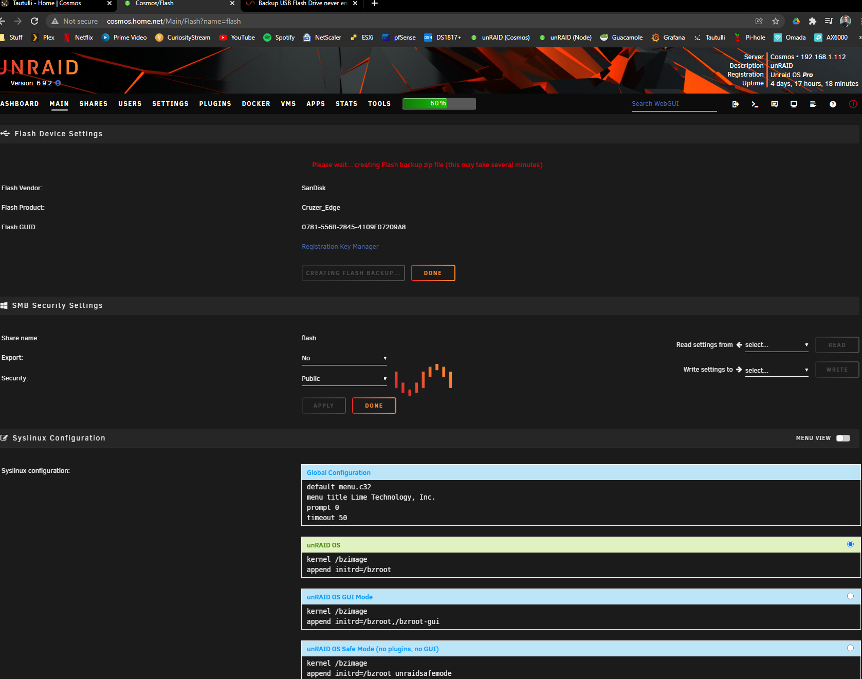

I'm having the same issue.  I'm just stuck at this page for hours on end.  I can access the flash drive and manually copy files off of it.  What's a good way to manually back things up and create the zip?
image.thumb.png.77312deb70f1520736cf3cc20f5f23d9.pngIs there a
