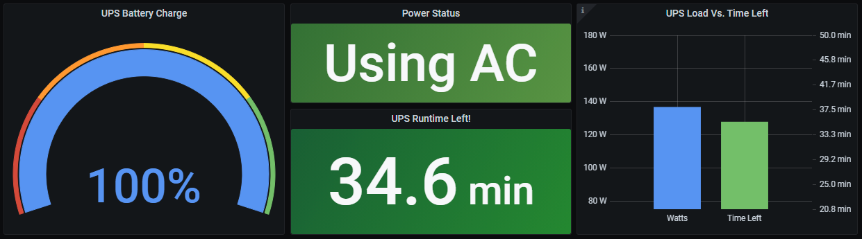

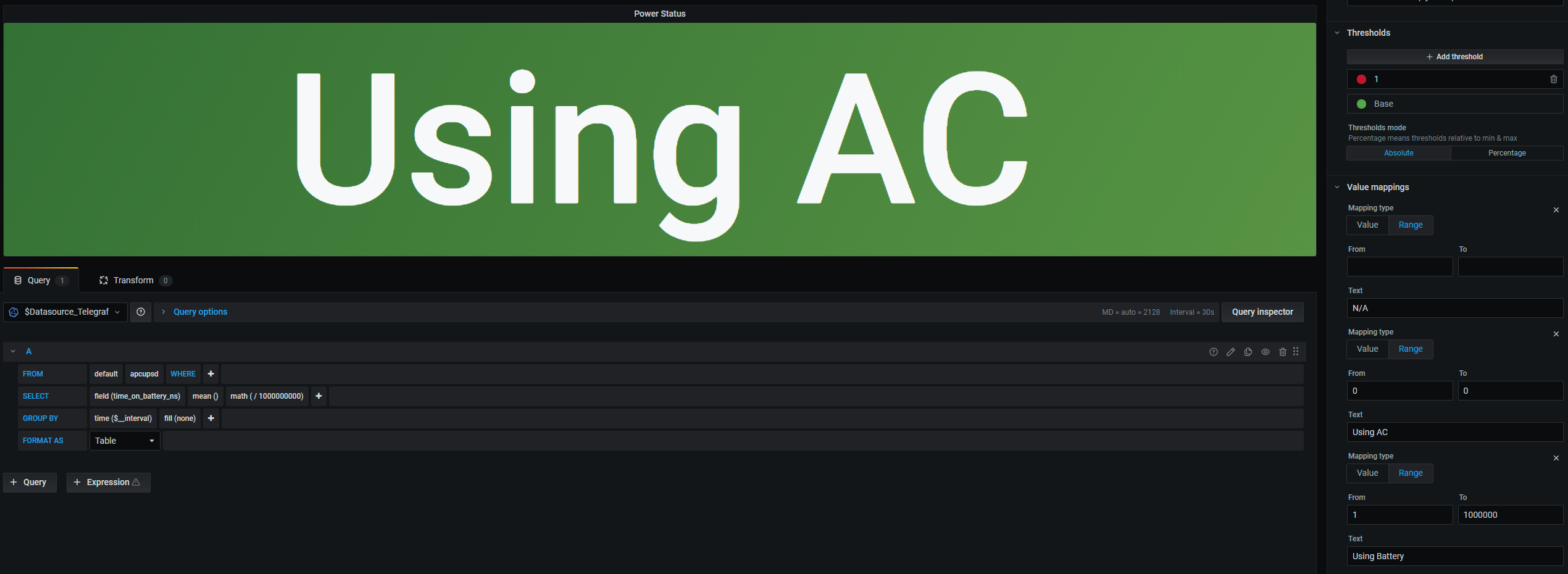

  2. IDK if anyone has done this with their Grafana Dashboard for this yet but I wanted to share it with everyone in case anyone else was curious. There are times when I am not home that I like to check on my server using Grafana and often wondered how I could tell if my UPS was using the AC or the Battery at any given time. I wondered this more so when I knew there was questionable weather near my house. Attached are screenshots of a Query I made that shows you whether or not your UPS is currently using the battery or if it is using the AC power. I'm not particularly good with grafana, I'm still learning, so I don't know if this will work for everyone's setup and UPS but if it does I hope you find it as useful as I do.
