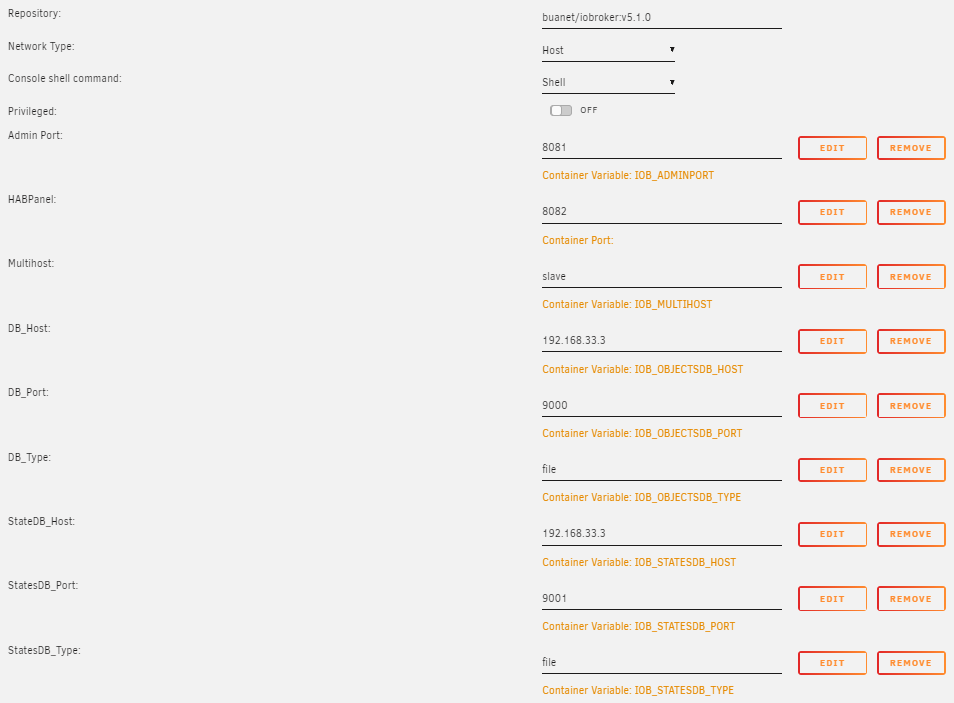

Strange. Now it is working. Do I have to manually connect before it can be used with the variables? Gesendet von meinem MI 8 mit Tapatalk

Exactly what I wanted to ask as well [emoji2] The Pi is set as master. Using the normal procedure with the help of the console is working. What about the password for connecting the slave to the master? How is this handled with the variables? I will add the output of the log tomorrow when I am back at my PC. Gesendet von meinem MI 8 mit Tapatalk

Hi, I am trying to get the docker working as a slave in a multihost system by setting the ENV variables. I am not getting it to work. I am not sure if I have set everything correctly: Any advice? Ty.
