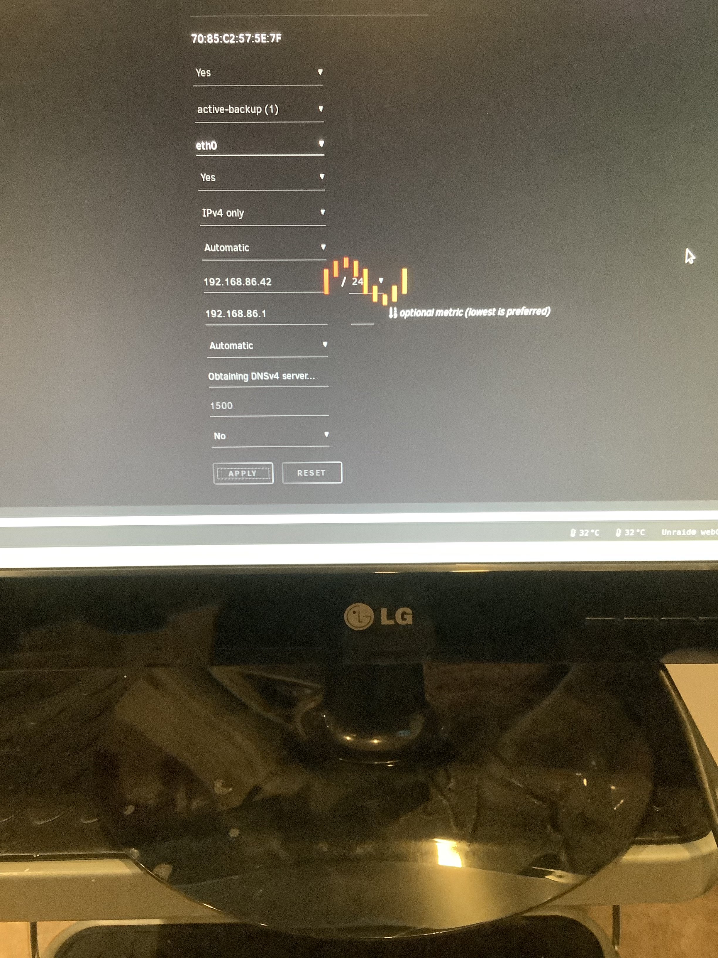

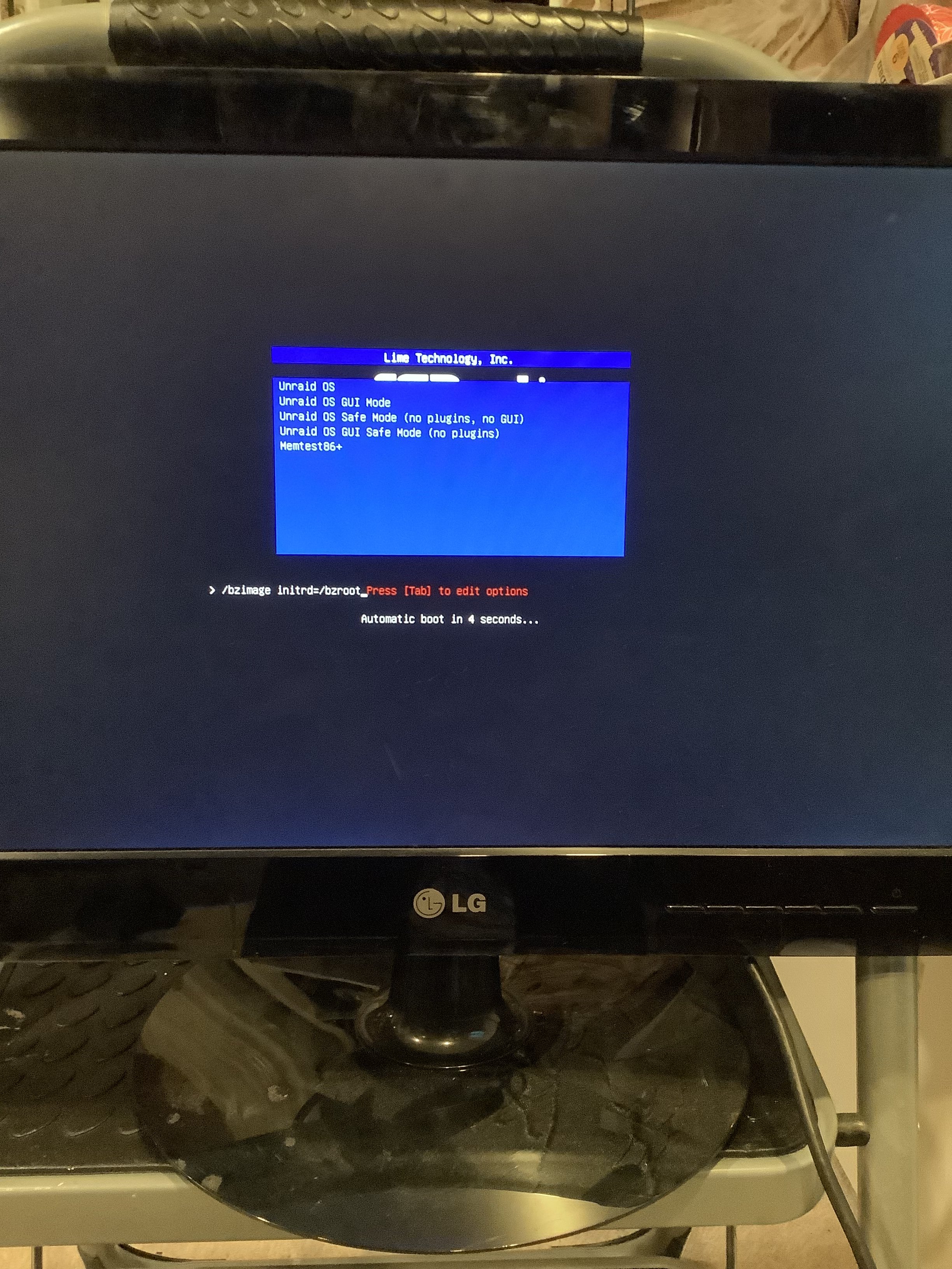

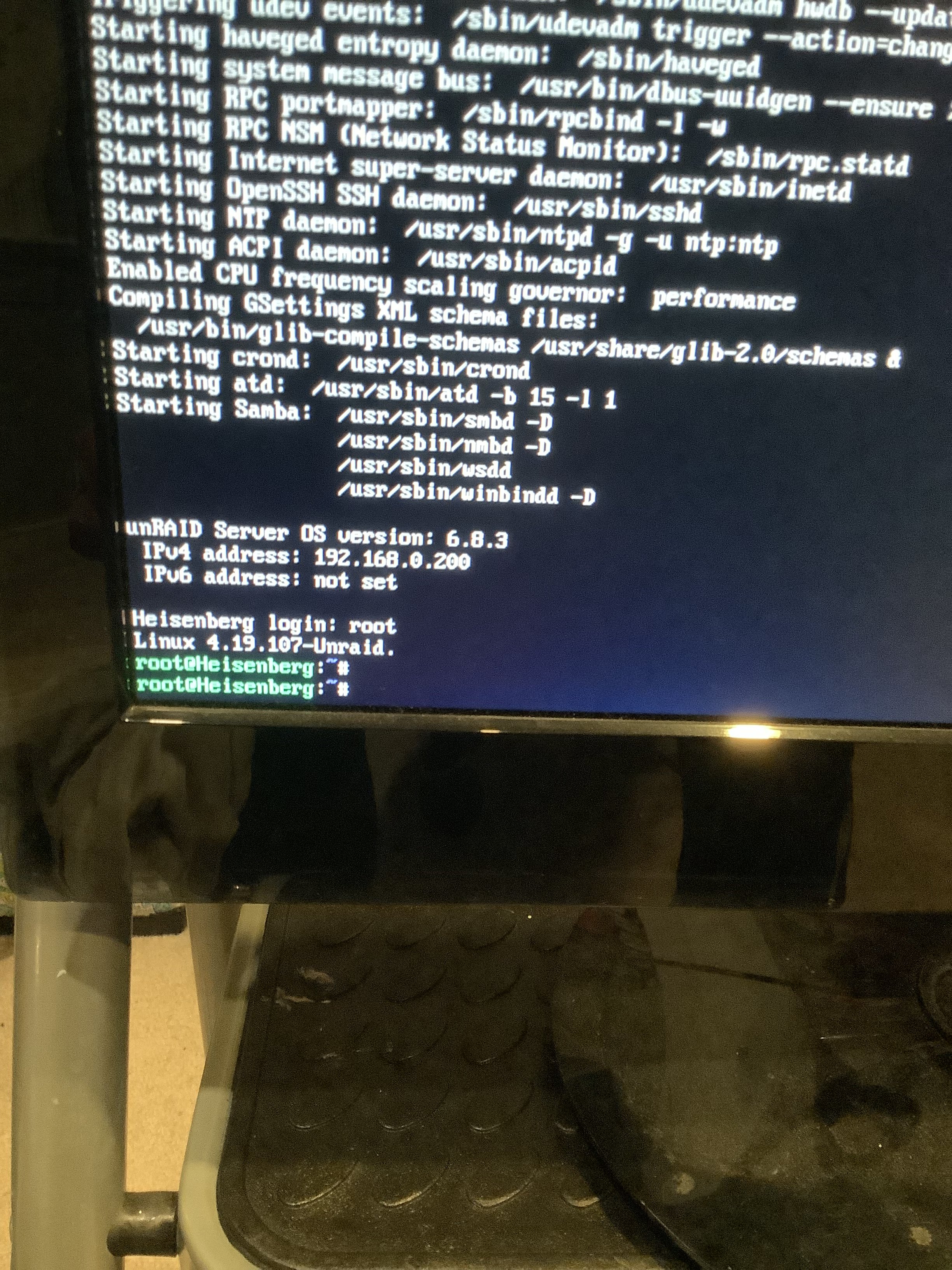

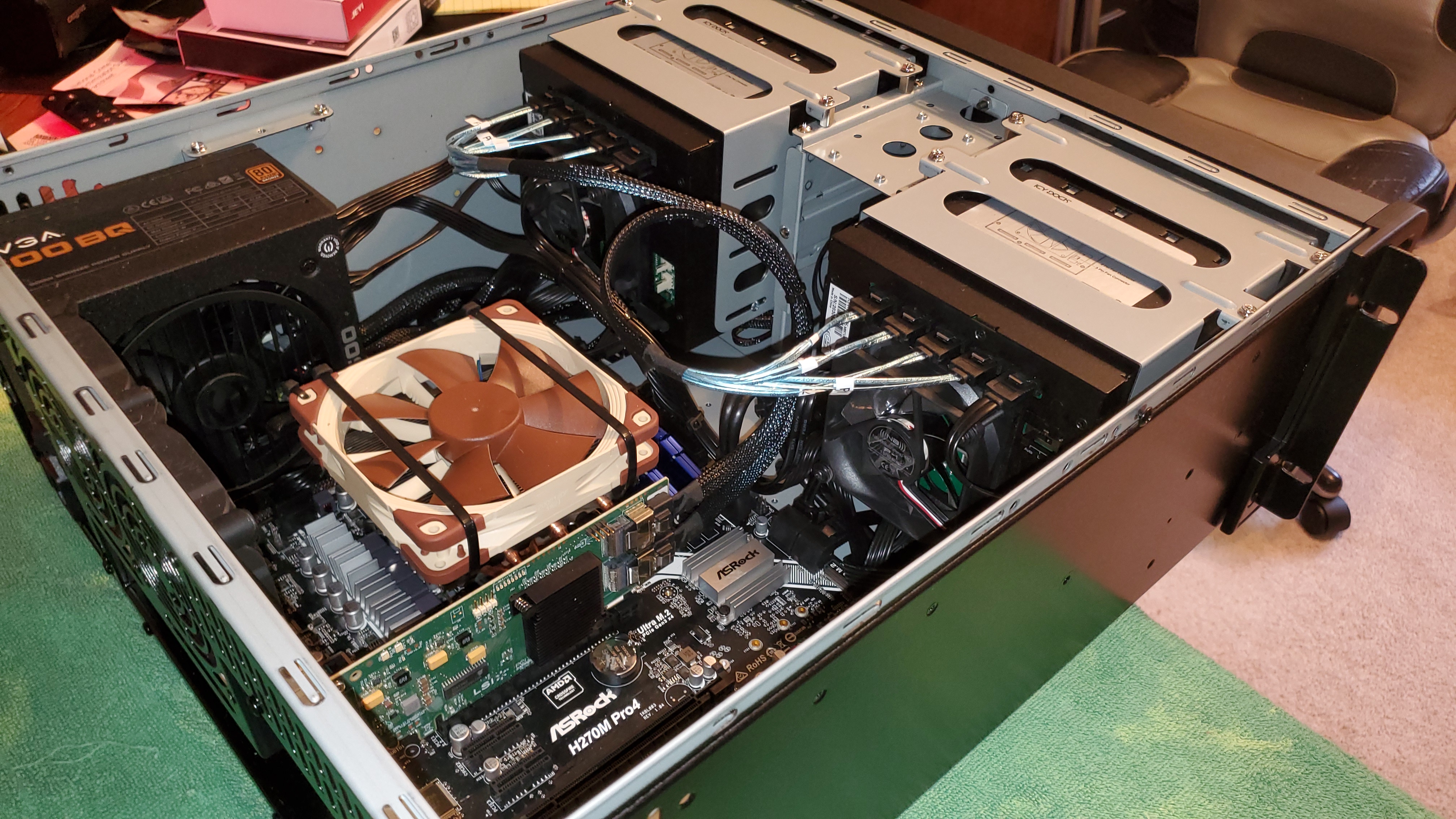

  1. It’s sorted, from here I got into “unRaid OS GUI mode” and clicked on network settings.
  2. Okay so on the 10th (or more) try it finally booted up and here’s where I’m at. That IPv4 adx is the original static IP. How can I change that to static from here?
  3. I have a UPS that shuts down the server 3 minutes after it goes on battery. I can not get to bios through VGA or HDMI.
  4. I knew I had to change my server from static IP to dynamic before I replaced my router but I forgot. I started to watch a movie last night and - no files. Knowing the problem was probably the IP address I went to shut down the server but instead of pulling the plug on the UPS and letting the machine initiate a proper shutdown I stupidly shut off the UPS which abruptly stopped the server. Now I can't get any video output from the server. I can't even get the bios to display. Things I have tried: Connected a monitor via VGA. Connected a 2nd monitor via VGA (just in case the 1st one was bad). Connected to a TV via HDMI. Removed unRAID USB stick from machine and tried HDMI again. Machine powers on and all lights work (power, HDD bays, SAS controller card, & ethernet port on MB). Machine shuts down with a long press of power button, reset button does not work. ANy insights would be helpful, thanks

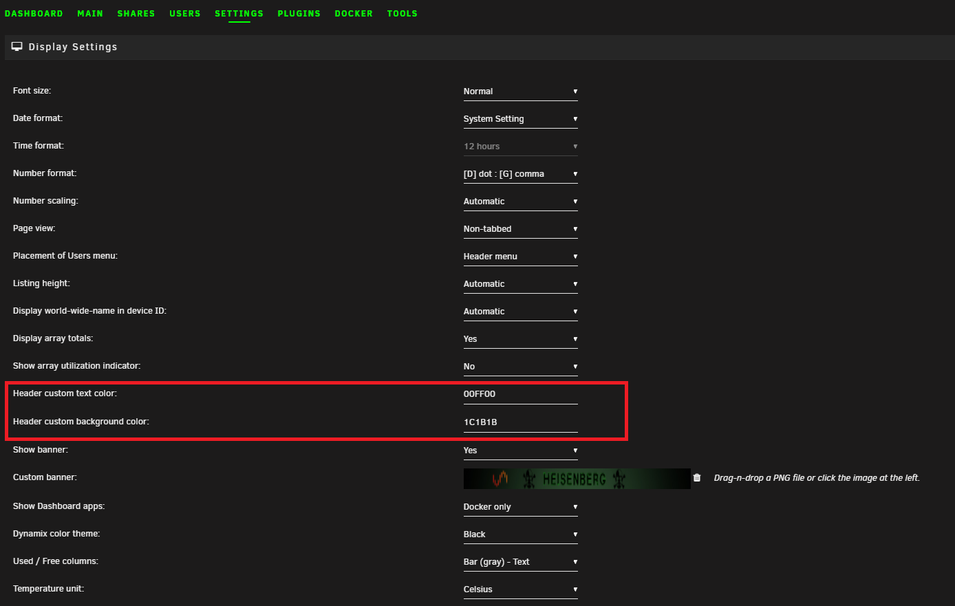

  11. In the display settings it's these 2 headings. To match the dashboard color I used MS snipping tool and grabbed a sample of the background color then went to this website https://html-color-codes.info/colors-from-image/ and uploaded the image. It will then generate the HTML code for the color that you enter into the "header custom background color" line. You can also find the codes for every other color on that site to create whatever font color you want.

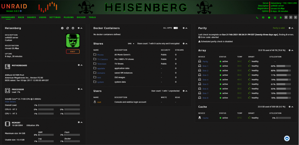

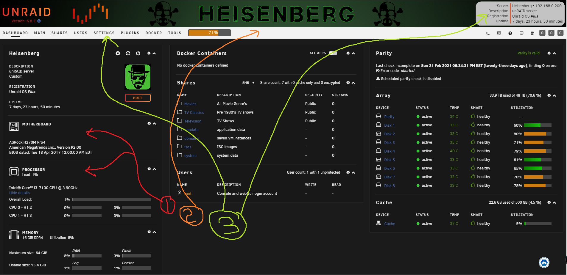

  13. I could use a little help please. I've been changing every setting back and forth for over 30 minutes and can't figure out these 3 things 1. How to add MB & CPU temp to dashboard 2. How to change color in this field 3. How to change font color for these items I have version 6.8.3 with no dockers

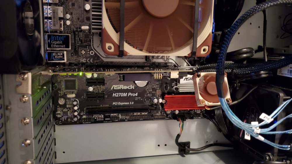

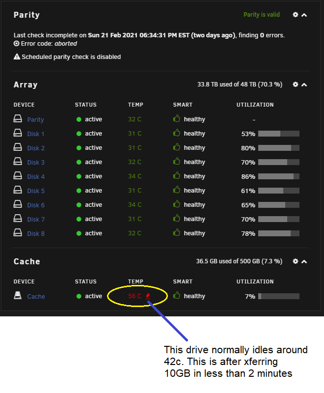

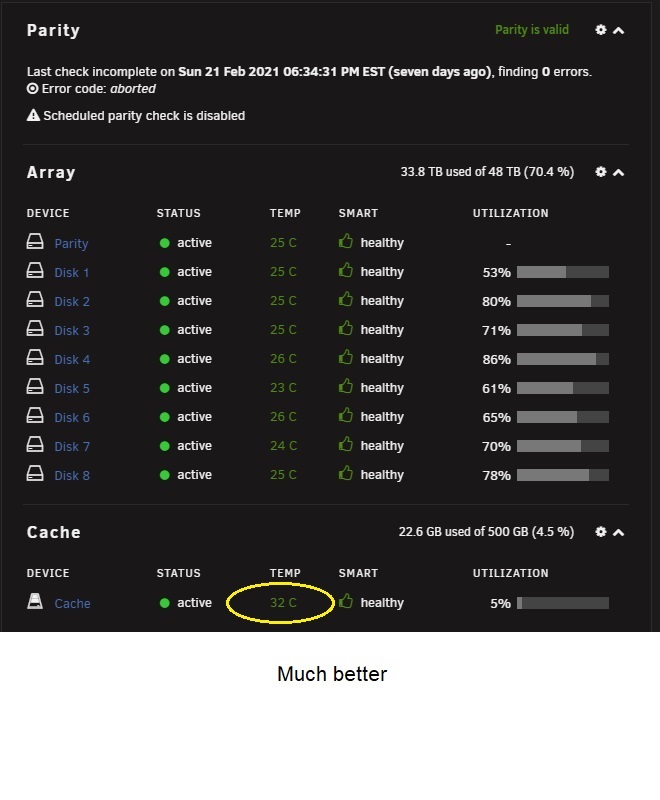

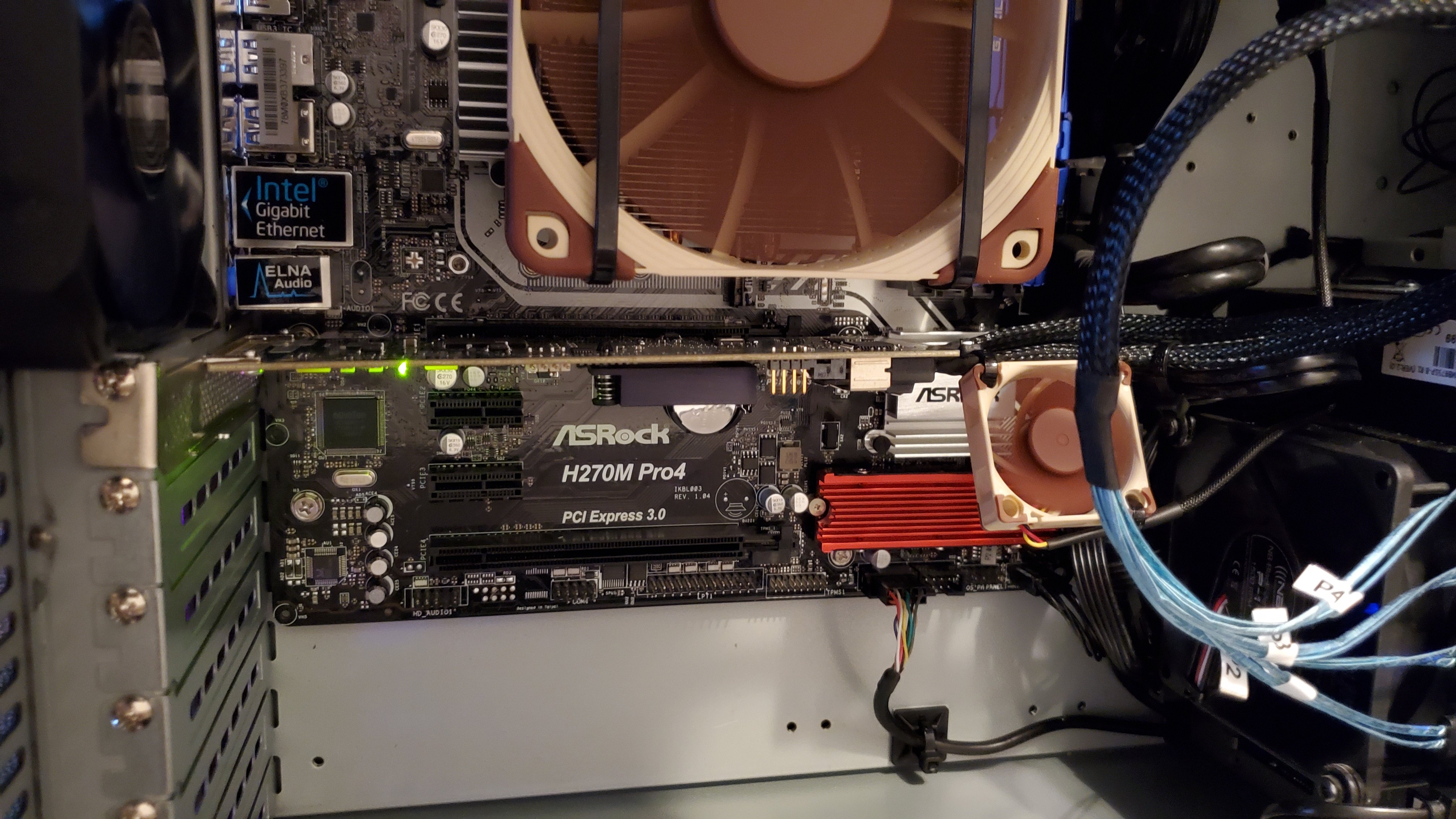

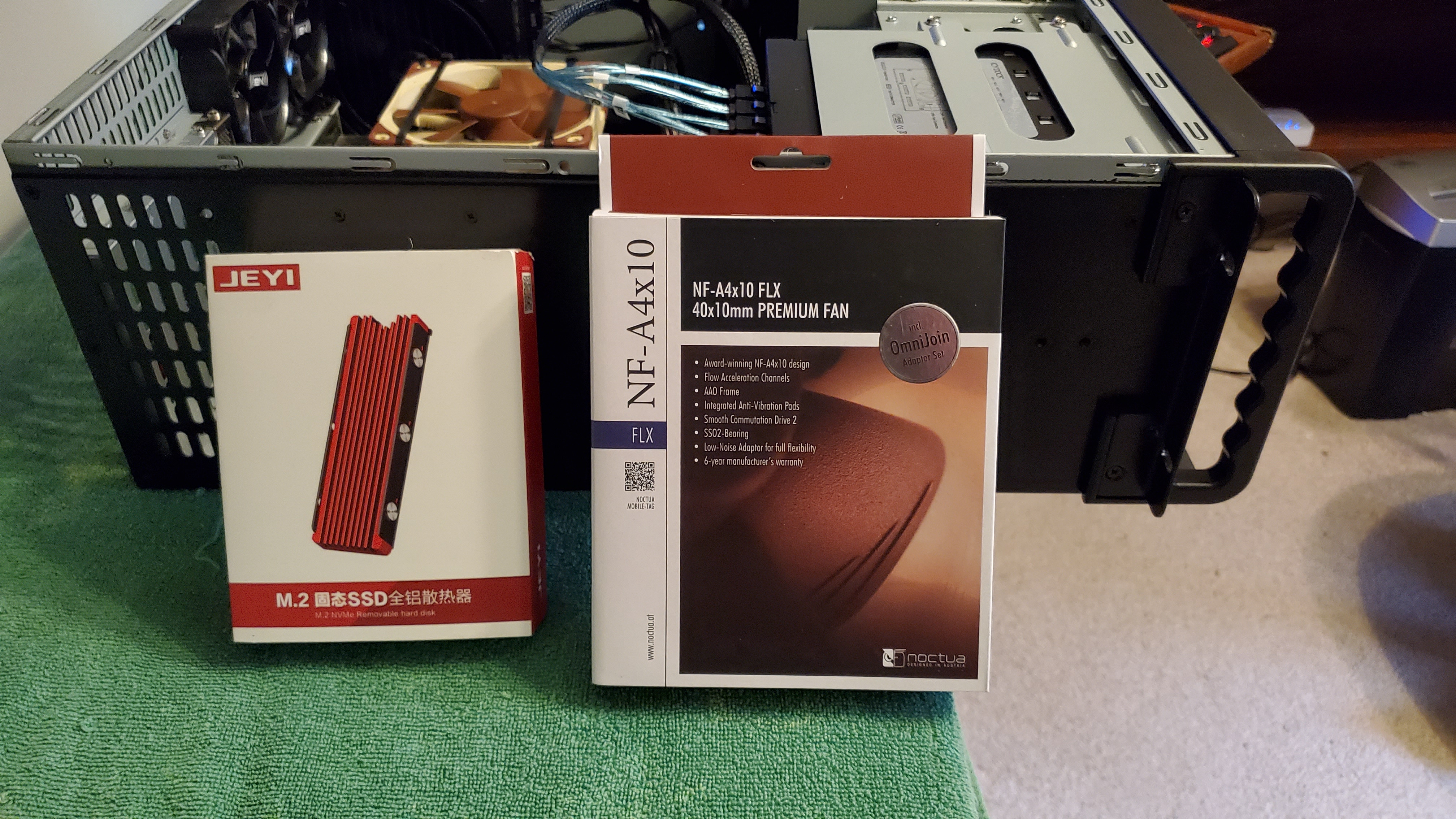

  14. I decided to try a heatsink and a fan which dropped the temps about 10C. I will have to test it under load next time I have something to transfer. Thanks for the tips.
