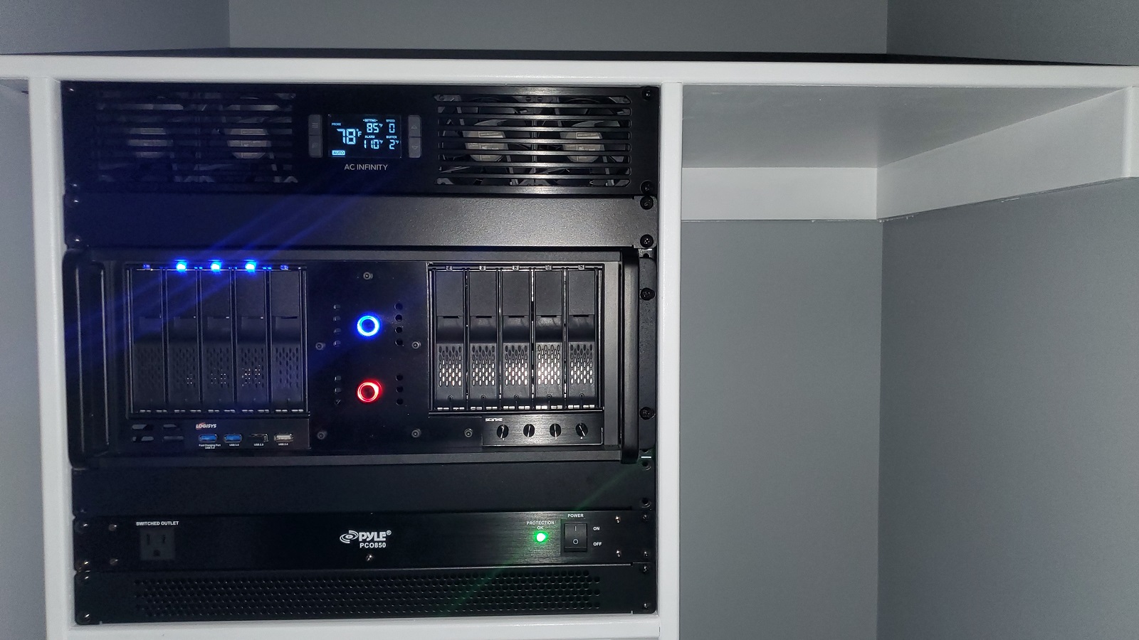

The bottom 1RU space is a vent. I also have a 3"x6" hole on the right side of the cabinet space towards the back to let air in (I can also reach the back of the server if need be). the the whole enclosed unit idles between 76f to 78f. I have the thermo controlled fan set to come on at 85f. This thing is brand new so I am in the process of moving about 38TB's of data from my old machine to this new one and with multiple disks spun up or while doing a parity check I can hear the fans come on occasionally but it cools back down to 80f within a minute or so. This closet is in my home office so I usually leave the door cracked open an inch or two. The one heat issue I am having is with my cache drive. I used a motherboard mounted Nvme drive and it gets very hot. I get multiple warnings from the unRAID dashboard while it's in use. Have any of you had this same issue or know if a heat sink would help? -

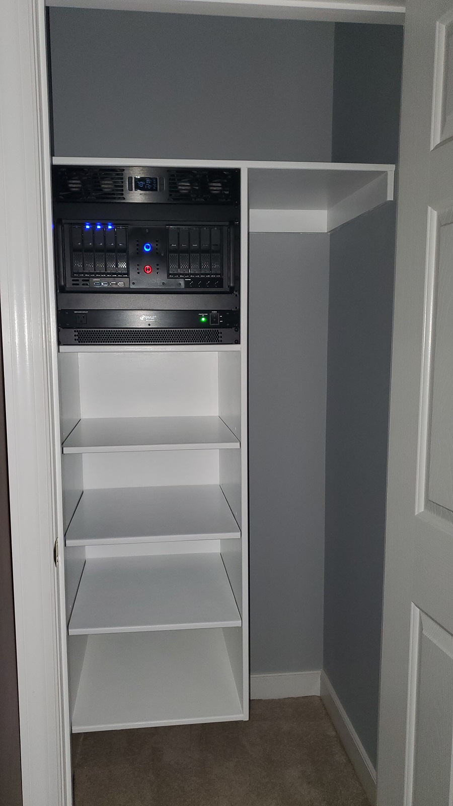

I had power on the other side of the wall in the living room so I jumped off that and installed a new outlet behind the rack. Unless your closet is on an exterior wall you probably have one close by. -

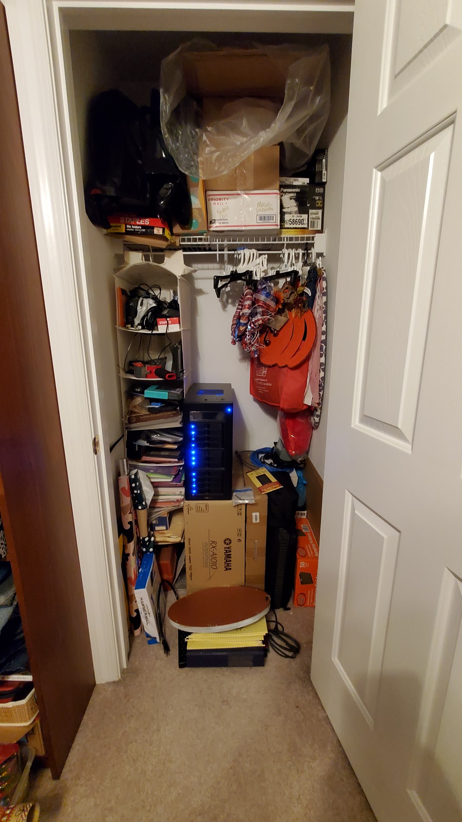

I just built a new rack style server to replace my 10 year old tower and did a server closet upgrade at the same time. before After -
