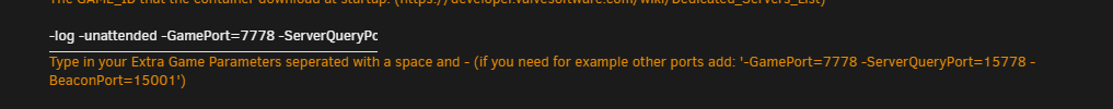

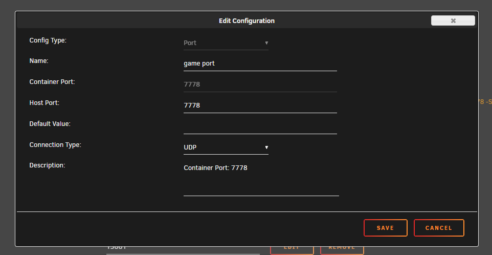

  8. Delete, create new one and set the extra game parameter. my look like this and it work:
  9. i try to run 2 satisfactory Server, too. I am able to run 2 Server, everyone has it´s own config and folder. This works. Important: you must DELETE the default three entrys in the docker config for the ports and create new one for 7778, 15778 and 15001. Then it will be work. I have made the same mistake in the first attempt´s. But my problem is, i can not connect to the second Server. The first run´s great with default ports. The second with modified Ports give me the error "invalid authentification token". i don´t know why...
