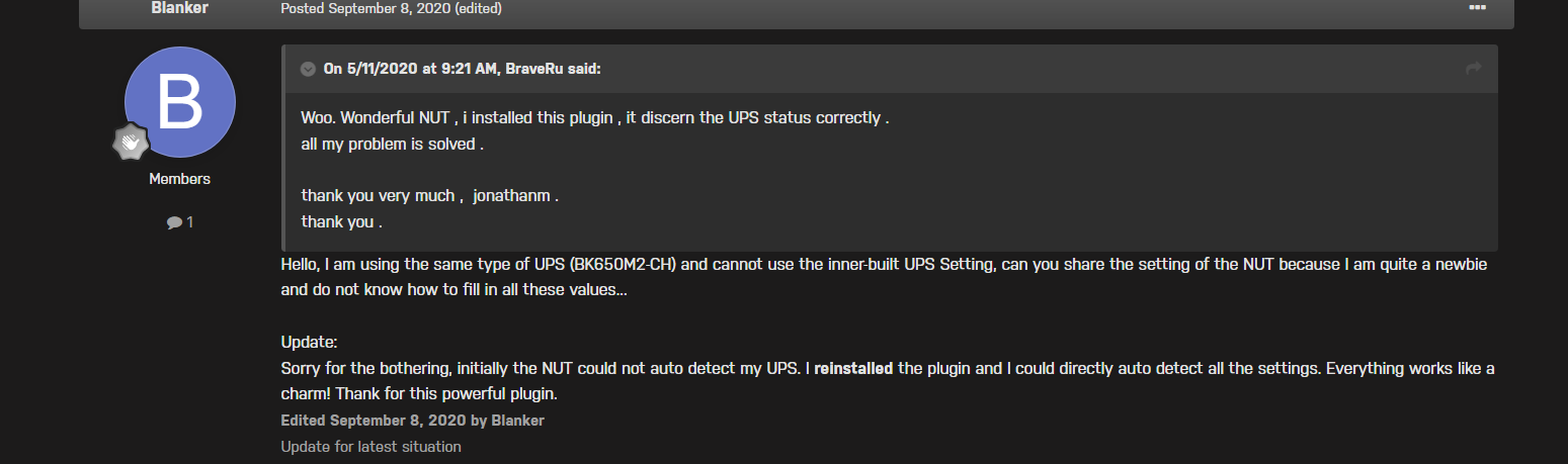

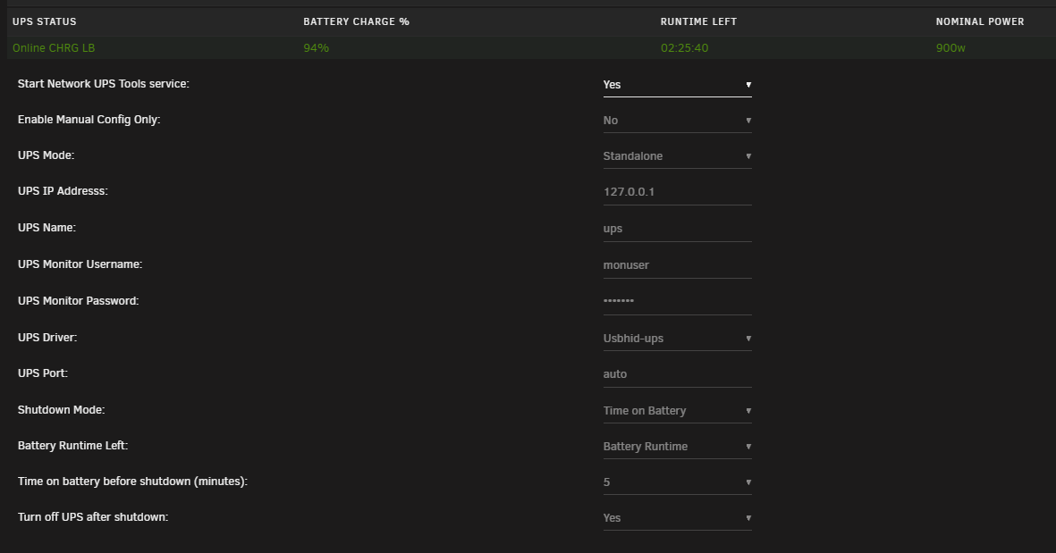

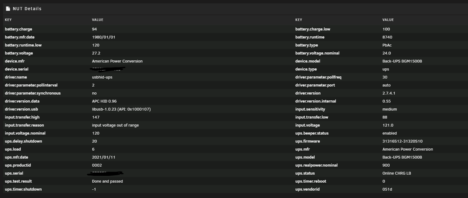

  3. So, I went back to the default UPS daemon and it reported that my ups was OFFLINE which made unraid shut off. I did a bit more digging Found this tread Which led me to this comment I re-installed NUT and everything is working as it should be, maybe a bug with NUT? No clue since my was detecting the UPS Anyway, thanks for the help! Just wanted to add this here in case someone else runs into this problem
  4. Very nice! Yeah man UPS-s are awesome when they work lol. Still trying to figure out this thing, I can't imagine it should be this difficult to setup, probobly gonna reach out to APC depending on how tomorrow goes, thanks for the help though!

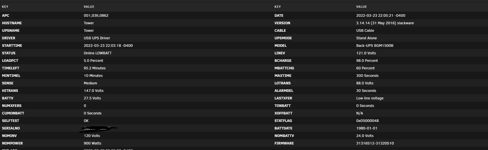

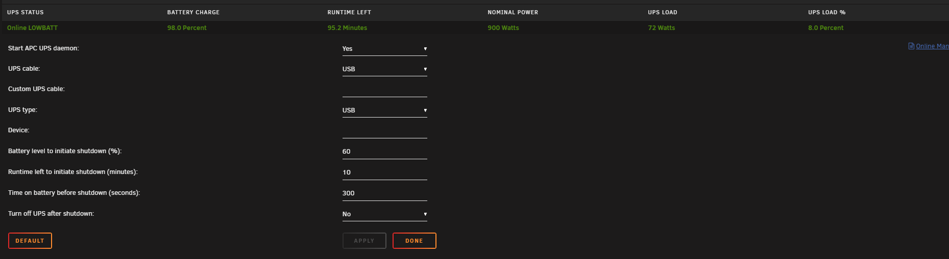

  5. I was able to test the new setup shown in the previous pictures just now and as soon as I flip the breaker off, the ups kicks to battery, Unraid starts a clean shutdown, despite the ups shutdown settings not being met. I do have my modem connected to the UPS and that hasn't power cycled once. I did this with the updated 300 second shutdown timer Maybe tomorrow I can turn off all the Unraid UPS daemons and test the ups, if it still shuts Unraid down then its a UPS problem, I think that makes sense

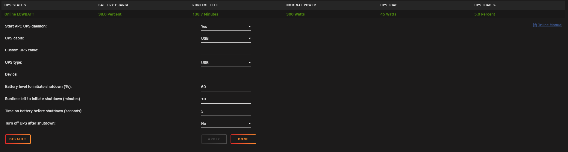

  6. Thanks! Just tried the built in one, and it set it like this: Gonna have to wait till tomorrow to shut the breaker to test it but hopefully it was that , Thanks for the pic Edit: I just saw Time b4 shutdown is in seconds on this one, whoops Here's updated version:
  7. I got this one: https://www.apc.com/shop/us/en/products/APC-Back-UPS-Pro-1500VA-for-Gaming-120V-Pure-Sinewave-LCD-Black-3-USB-charging-ports-10-NEMA-outlets-4-surge-/P-BGM1500B I did initially try to use the built it and it didn't seem to recognize it, I can give it another go though, good idea

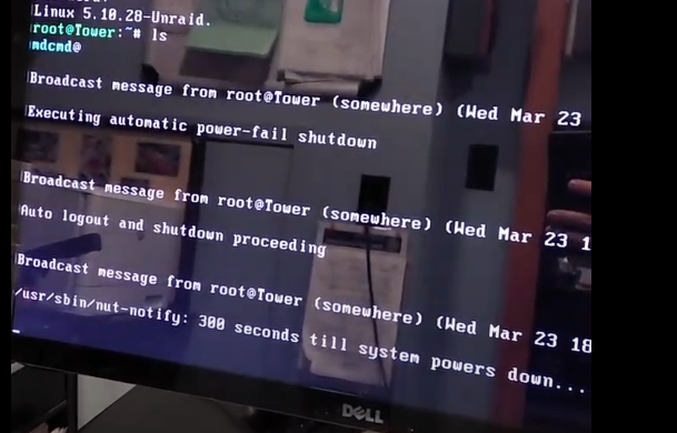

  8. Hello! So a few months back I got a UPS and finally got around to setting it up. My problem is as soon as the UPS switches to battery, the server shuts downs. Here is my NUT settings: I hooked up a monitor so I can watch what gets displayed on the terminal and it is this: After that it displays the normal shut down stuff and shuts down cleanly. From that picture it looks like two things are going one: 1: something is saying there is a power-fail and is forcing a shutdown 2: NUT is working and is attempting to wait for 5 mins before shutting down I jump to the idea that my UPS is not working correctly and the server sees a bad voltage for a second, but it is still on so it cant be that bad, can it? Anyone have a better idea, or see something I missed?
