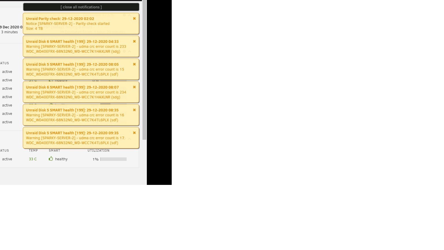

December 20, 20205 yr Hi everyone a week ago i have put 2 more Hard Drive in my system which were new and i have been getting this error below on disk 5 and 6 can anyone help please Edited December 27, 20205 yr by Sparky678911
December 20, 20205 yr Community Expert That's usually a bad SATA cable, replace but if it doesn't fix it please post the diagnostics, could also be a different issue, like a bad LSI firmware.

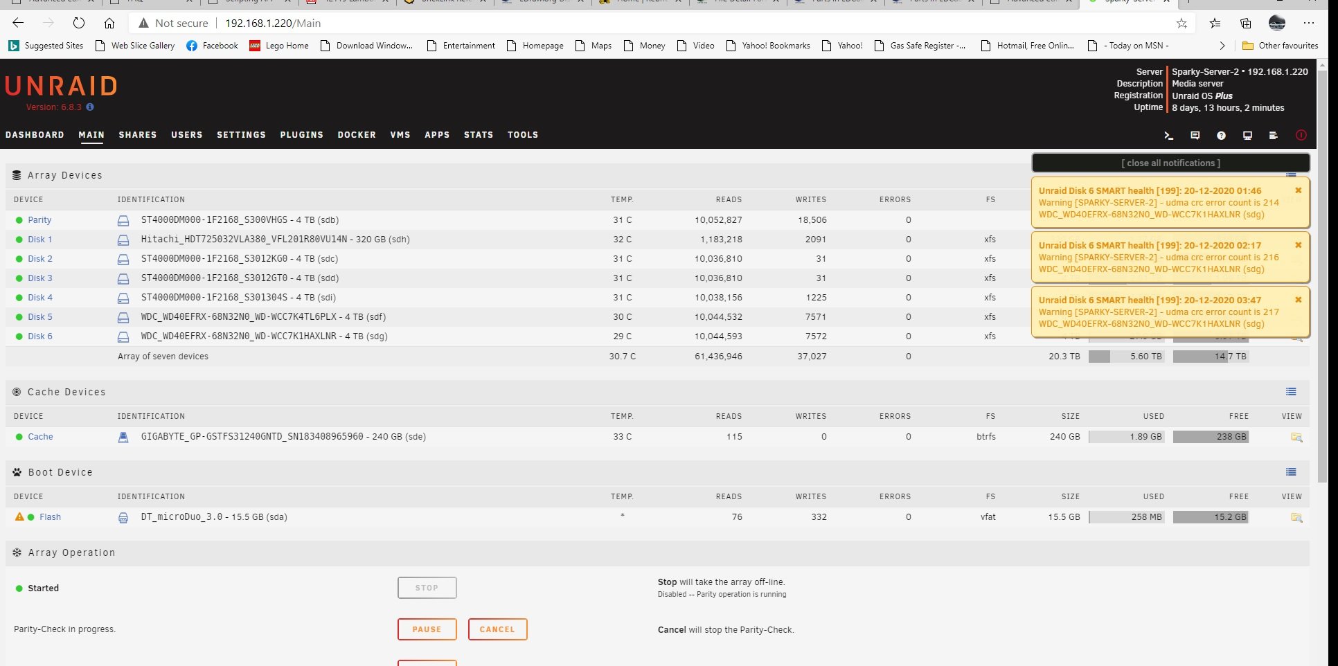

January 3, 20215 yr Author Hi ok so i have brought and added the new card and still get the same error sparky-server-2-diagnostics-20210103-2250.zip
January 4, 20215 yr Community Expert CRC errors don't reset, but if you're getting more it's likely a cable problem, or those disks don't like that controller, you can swap them with the other model you have an test.

January 4, 20215 yr Author I have replaced the cables and the card is there a program i can repair and scan Hard drive to repair the CRC error thanks
January 4, 20215 yr Community Expert You don't repair CRC errors, they don't reset, are they still increasing?
January 4, 20215 yr Community Expert 2 hours ago, Sparky678911 said: I have replaced the cables and the card is there a program i can repair and scan Hard drive to repair the CRC error thanks You can click on the SMART warning on the Dashboard page and it will let you Acknowledge the current count, then it will warn you again if it increases.
