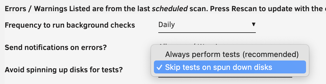

Did you ever figure out what was causing this? I'm also seeing it.
Hi CS, no, I didn't. After diagnosing the Plex library indexing thing, I monitored the unraid server occasionally, and the disks are sleeping most of the time. So I haven't bothered with the *.tmp files. If you figure it out, please do post :)
I've heared, that the MyServer Plugin might cause the disks to be spun up (was a problem before).
I believe I found the culprit - Fix Common Problems.
And here's the fix (I'm surprised it's not the default):
1407365105_ErrorsWarningsListedarefromthelastscheduledscan.PressRescantoupdatewiththe.thumb.png.ff28cd5e6e7157ba3a1ca386a78dd20a.png
