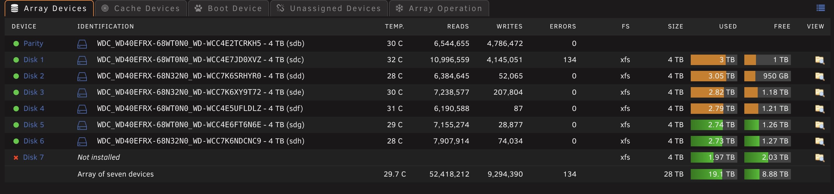

In doubt, I checked my disk 7 ... Why is there new data if it's not part of the array?
Don't understand what you mean, if you mean the emulated disk7 it's still part of the array, if you mean the old disk it will have whatever data it was there.
I have enough space to move my disk7 data to the others.
but I really don't understand why I have data here ??? It is identified as not installed
And after, What should I do ?
I really appreciate your help ...
When I connect to disk7 with Krusader, is there data from yesterday on it, but it's been several months since I took it out of the array.
When you removed the disk UnRAID started emulating it using the combination of the other data drives plus the parity drive.   Unraid is therefore treating it as if it is a ‘failed’ disk, and when you replace it with a physical disk UnRAID will rebuild onto that disk what it thinks should be there I.r. The contents of the emulated disk).
