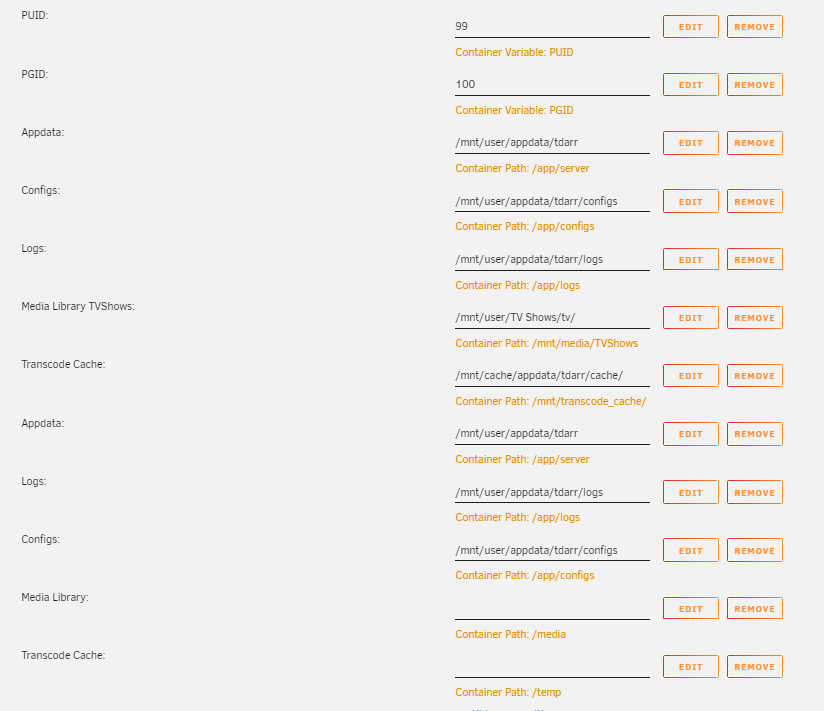

I thought I had hopefully resolved this, I only get the issue if running tdarr and keep finding all my shares missing causing me to reboot.
I had tdarr's media folder set to /mnt/user but changed it to /mnt/user/tvshows etc I managed 36 to find the shares gone again.
Can someone please take a look at my diags in case it is something else?  I really still do think it is tdarr but there are no paths set in the docker to use /mnt/user
That's still part of /mnt/user
Ah, I see!
That makes tdarr pretty much unusable then! 🥴
So from what I understand, until this issue is detected/fixed within unraid there is nothing I can do?
Edited by mbc0
It's an elusive issue, and not easy to reproduce, but those kind of dockers that directly manipulate files seem to be the ones that are more likely to cause this problem, but unless you can use disk shares for that (that would limit it to one disk or pool) don't known much else you can do.
