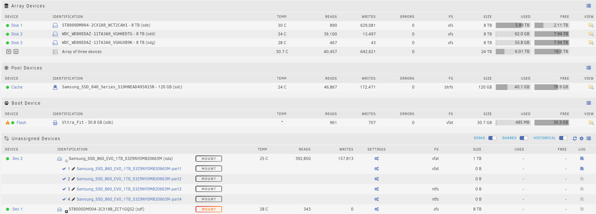

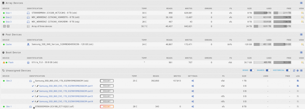

Here is a screenshot of my drives:

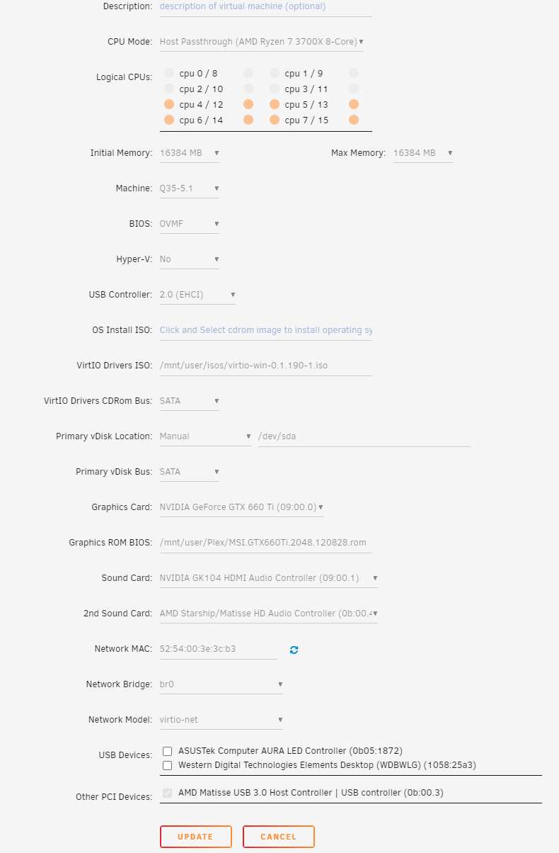

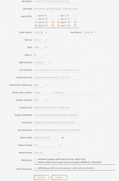

Here is screenshot of my Windows template: (the Western Digital is at the time of the screenshot not connected to the vm for a test)

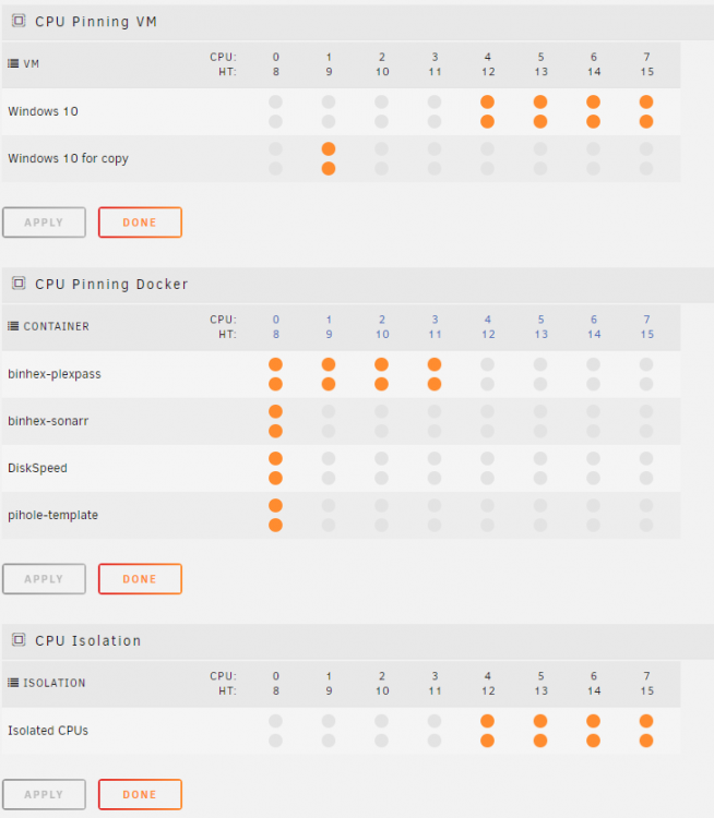

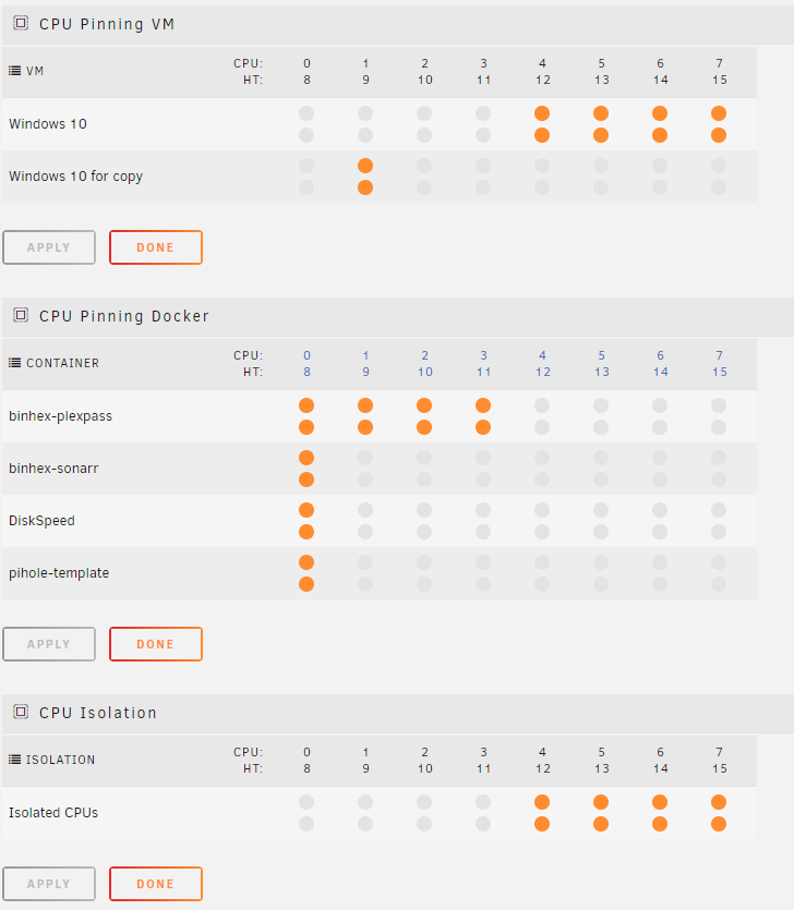

The cpu pinning:

I did forget to mention that I have already installed my Windows from scratch last saturday and it is using i400fx-5.2. Should i downgrade to 4.2? I can't seem to find a list that shows me the differences between those versions. Though I also have tried 4.2 before and got the same stuttering. But I could try it again.
I have never worked with the XML files. So I do not know what to do there and how to adjust your example. I will try to work out what to do later today or tomorrow.

As you can see in the VM template, I have passed through a ssd. /dev/sda.
I did more testing with cpu pinning. It has not helped yet.

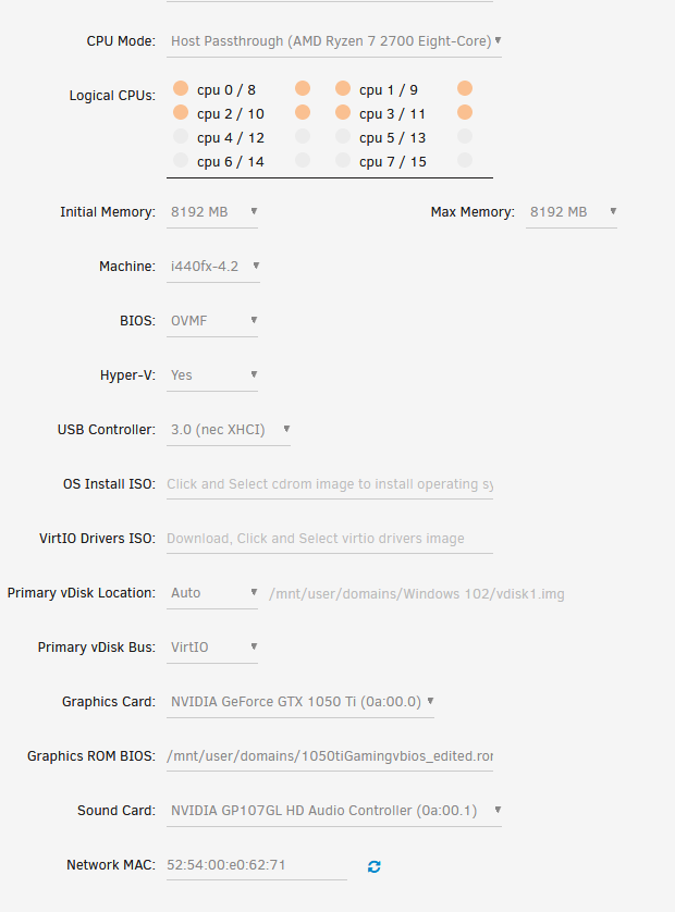

How about your memory? XMP profiles? I ditched the xmp and lowered my memory frequency fro increased stability. The performance difference is minimal.
Here is my fully working lag free vm template. Comparing it with yours can help.

Right. It has been a little while but a lot has happened.
I ordered a Samsung 970 EVO to install my Windows VM and changed my cache drive to the old ssd that my previous (laggy) install ran on. After booting Unraid suddely can't use my second GPU. It has no hardware ID. I also had a lot of trouble getting a new VM up and running. GPU passthrough just wouldn't work. However after rebooting a couple thousand times it did work. Surprisingly my new VM is snappy. There is no lag. So problem solved right? Nope.
My new VM does stutter when DisplayFusion is running. If I stop the program then the lag is gone. Strangely I did try turning that off (and even uninstalling it) with the previous install. It did not help there.
Since I use a 49 inch ultrawide, I do need DisplayFusion to run. So now the question is why that program slows my VM down.
I also noticed that dragging Bittorrent (with or without downloads running) will lag. However since I have Sonarr and Radarr running in Dockers, that is not an issue.
I have not tried setting emulator pins on my CPU yet. That will be my next step in figuring out why DisplayFusion is messing with my system.

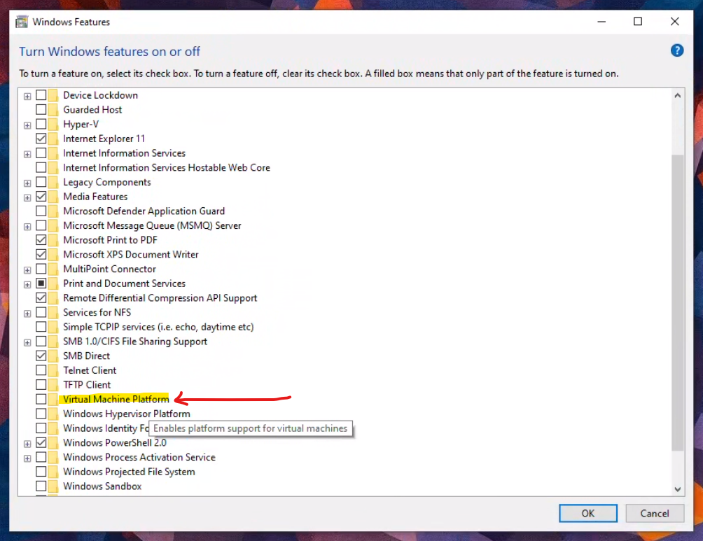

I can't believe it, but I fixed my severe Windows 10 VM stuttering issue. I was really hopeful that the MSI fix proposed above (I used MSI_util_v3.exe to enable msi, and set the interrupt priority to "High") was going to work for me, since lspci told me that my gpu+audio passthrough didn't have MSI enabled. Applied the fix, no dice.
Then I resumed my two-day Google-fu and read like a thousand and one posts with all sorts of purported arcane fixes. I'm one post removed from sacrificing a virgin and using his blood to consecrate my VM.
It turns out that this was my problem (see attached picture). I enabled this to run WSL, and I didn't suspect that it would cause a major issue with lag and stuttering. This was my last hail-mary, and I disabled it, rebooted the VM thinking it wouldn't do anything.
VOILA. SLICK BUTTERY GOODNESS.
Granted, I can't use WSL in my VM anymore but it wasn't that important compared to having the VM run smoothly. Now I'm streaming 4K videos on youtube on the VM through Parsec and everything works perfectly.
Host setup: i7-7820x, Gigabyte X299 Gaming 3, 32GB RAM, Gigabyte AORUS Xtreme 1080ti (Single GPU passthrough), UEFI boot, ixgbe network bridge.
VM setup: Windows 10, 4 isolated cores / 8 threads passthrough, GPU+HD Audio passthrough, 16GB RAM, network bridged to host ixgbe interface.
tl;dr: Killing "Virtual Machine Platform" under "Windows Features" fixed my extreme stuttering/lagging problem with my Windows 10 VM.
Edited by wilde.fyre
Here I am in 2024, after two days of pain trying to get my VM back working smoothly... version 6.11.5... tried a hundred things, but this was the thing that fixed the performance issues.  I am very grateful for this. RIP WSL.
