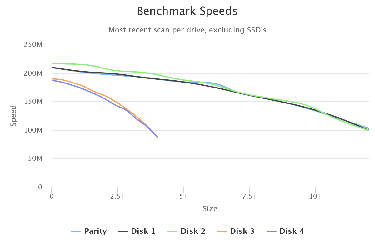

Unbalance was extremely slow (5MB/s) so I ended up stopping it to check drive speeds with the DiskSpeed docker. Everything looks fine:
Partiy, Disk 1, and Disk 2 are 12TB WD EasyStore shucked. Disk 1 is the one that keeps getting corrupted and that was added to my array in the past 3 weeks. Disk 3 and 4 are WD 4TB Reds. Disk 4 is on the LSI controller.
I also double checked short S.M.A.R.T. tests, every drive was okay. Also double checked XFS_Repair, every drive was okay except Disk 1 had like 2-3 errors that were fixed just fine. I still am not too sure if Disk 1 is the chirping because I've heard it before and it went away and I am not confident the first time I heard it wasn't before installing that drive. So I'm going to see if I can dial in which one is doing that. If it is Disk 1, I think I'll conclude Disk 1 is just bad and needs to be taken out of the array.

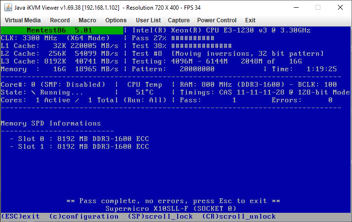

Edit: Running Memtest86+ from the Unraid boot menu. 1 pass so far with no errors but I'll leave it overnight just in case.

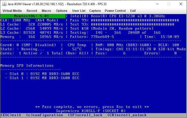

That makes sense. I'm not sure there's an option to disable ECC, what would the point of that be?
Regardless, I ran it overnight and it did 6 passes with zero errors:
