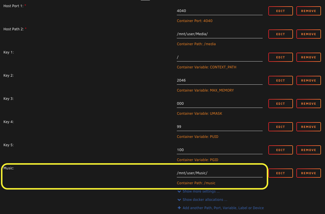

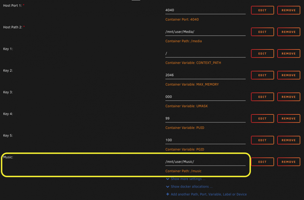

Thanks @binhex.  That worked!
I needed the copy over:
/db/
/airsonic.log
/airsonic.properties
I did not include the other folders( /thumbs, /index18, etc.).
One thing I had to go back and do is add in a new container path for Music (see attached) because my original music path from airsonic could not be found when I started airsonic-advanced.

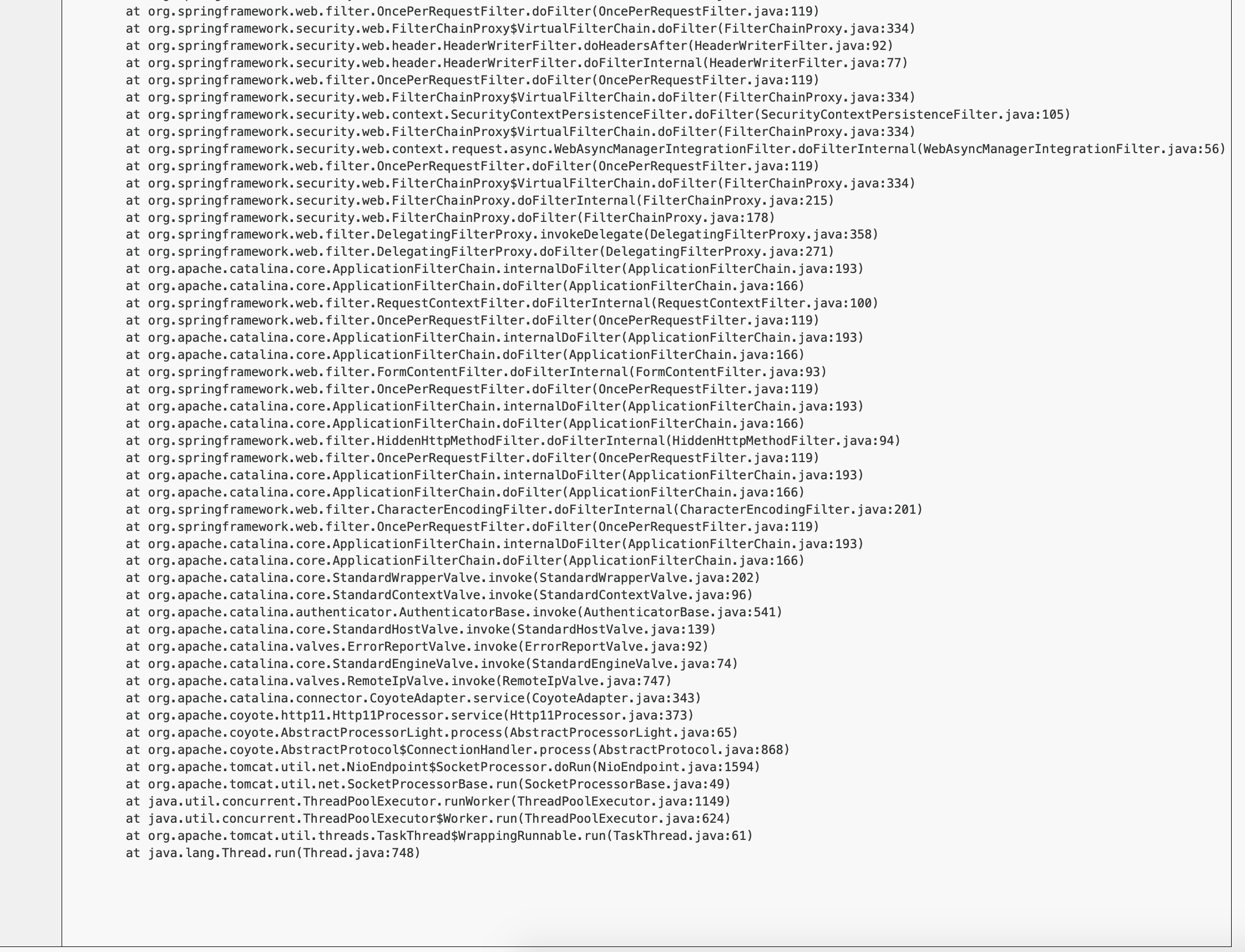

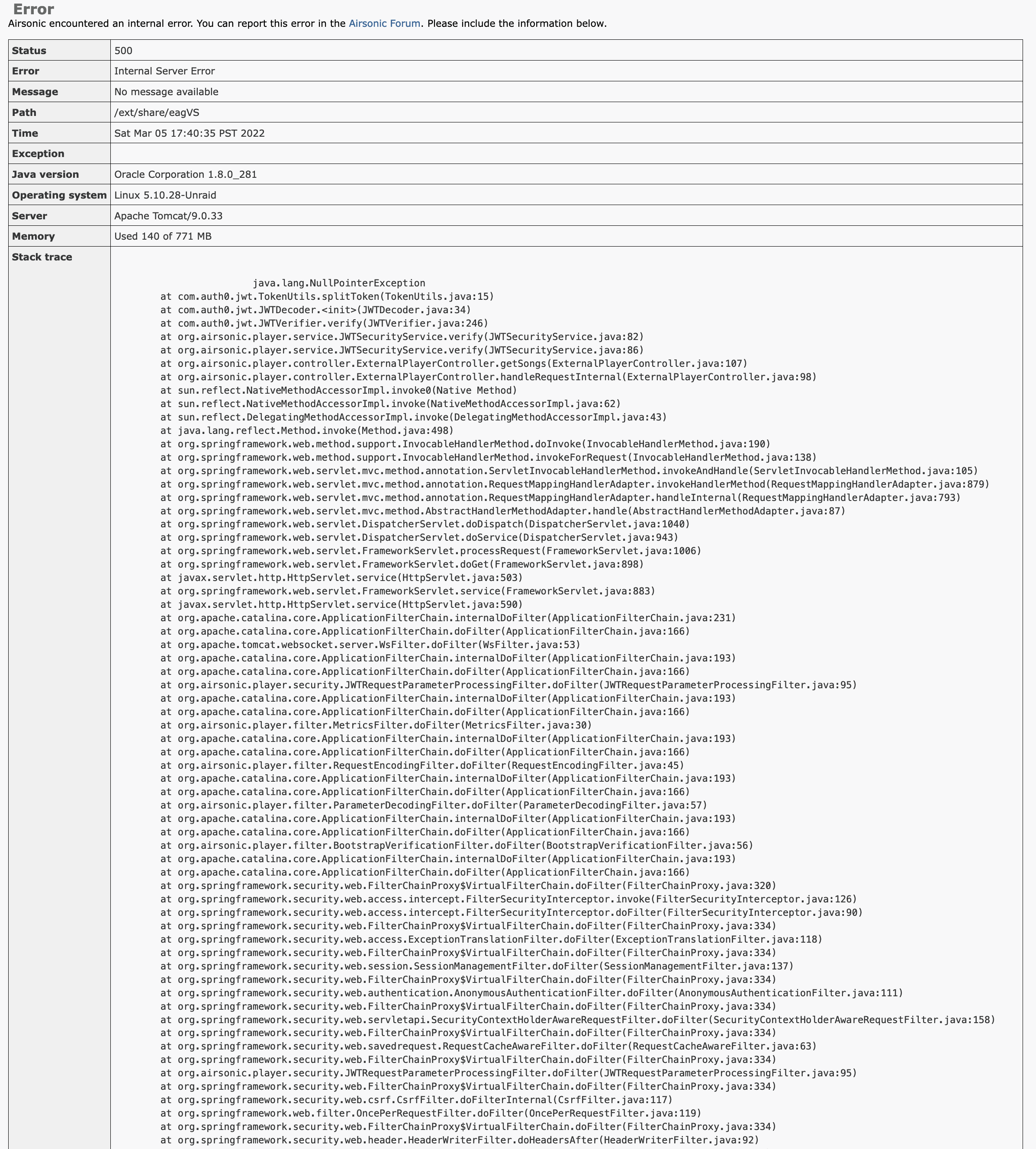

Just installed the docker and everything looks good. However when I use the share "Share" function the link generated causes an internal server error. Any ideas?
I noticed that even after generating the link, there's nothing showing under the "Shared Media" tab.
Status  500
Error   Internal Server Error
Message   No message available
Path   /ext/share/eagVS
Time   Sat Mar 05 17:40:35 PST 2022
Exception
Java version   Oracle Corporation 1.8.0_281
Operating system   Linux 5.10.28-Unraid
Server    Apache Tomcat/9.0.33
Memory   Used 140 of 771 MB
Same thing
