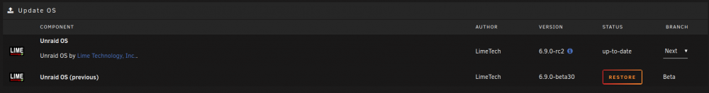

I am trying to downgrade back to the stable release "6.8.3" but when I go to 'Tool > Update OS' there is no option for me to go back to the Stable branch, I try to change the Branch 'Next' to 'Stable' but no option appears but just the previous 6.9-beta30 I was using. Please help, I regret using beta and just want to use stable :(
Just download the latest stable, unzip, and replace all the bz* files on flash with those in the zip.

Is there a different way to do it? I tried this but after doing so, it won't recognize my cache drive so it wants me to reformat after starting the array back up, but its already BTRFS, and I have over 300GB on it, so I had to go back to Beta where it would recognize the cache drive. Is this something to do with 6.8.3 and cache drives compared to 6.9 which is causing it to make me have to format the cache again after the downgrade? I really just want to go back to stable but would like a way to do without having to move all my cache drive data out first :(
Probably has something to do with the 1MB alignment on cache drives introduced in 6.9.0 beta 29 to fix the excessive write issue on certain SSDs. If you partitioned your cache drive that way.
I don't believe that sector alignment is compatible with 6.8.3.
You may have to do a replace cache drive procedure where you move everything to the array, reformat the cache drive, then move contents from array back to cache drive.
If you did nothing with changing the partition alignment or did not reformat the cache drive when upgrading, this is likely not the issue.
