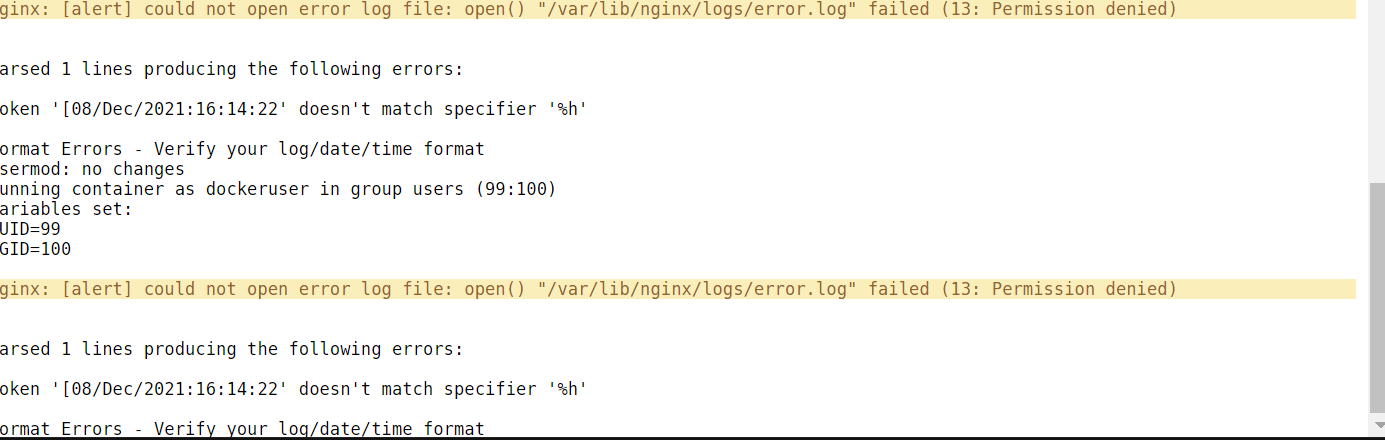

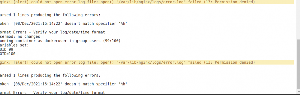

it doesnt work either way.
i also have these Problems :(
Parsed 1 lines producing the following errors:
Token '-' doesn't match specifier '%m'
Format Errors - Verify your log/date/time format
usermod: no changes
Running container as dockeruser in group users (99:100)
Variables set:
PUID=99
PGID=100
nginx: [alert] could not open error log file: open() "/var/lib/nginx/logs/error.log" failed (13: Permission denied)
usermod: no changes
Variables set:
PUID=99
PGID=100
No ideas?
