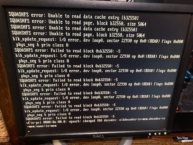

It has been years since I did the ACS override to BOTH to get my 4 port NIC into its acceptable iommu groups, so I figured I would remove that and see if anything has changed.
So, I removed the ACS override (BOTH) on the GUI only and restarted, selected GUI (pcie_acs_override=downstream,multifunction)
I then get boot issues (see scn shot) :
SQUASHFS error : Unable to read data cache entry, i/o error's etc etc and it just stops.
I took some video (too big to attach it seems) and a screenshot (attached).
If I add back the syslinux.cfg pcie_acs_override=downstream,multifunction , it all boots as normal.
I suspect the NIC is not being stubbed as it does not match, then the OS is doing something with the 4 port NIC ?
No diagnostics as it never boots, just hangs (see screenshot attached).
