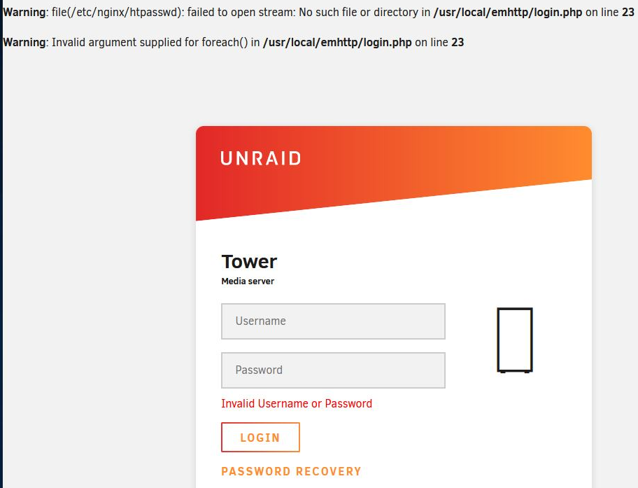

I'm a newbie with Unraid and need some help.  I recently updated to 6.9.1 from 6.8.3.  I wiped the USB Flash drive and installed 6.9.1 on to it. Now I get the error below when I try to login:
Warning: file(/etc/nginx/htpasswd): failed to open stream: No such file or directory in /usr/local/emhttp/login.php on line 23
Warning: Invalid argument supplied for foreach() in /usr/local/emhttp/login.php on line 23

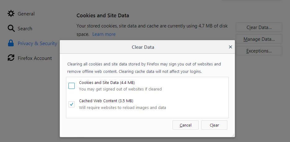

Clear your browser cache

if you wiped the flash drive and put a fresh 6.9.1 release on it without copying across your old configuration information then it would have reverted to having no password set.

Lastly, I will try tonight to clear out the cache for my FireFox browser in the window shown below:

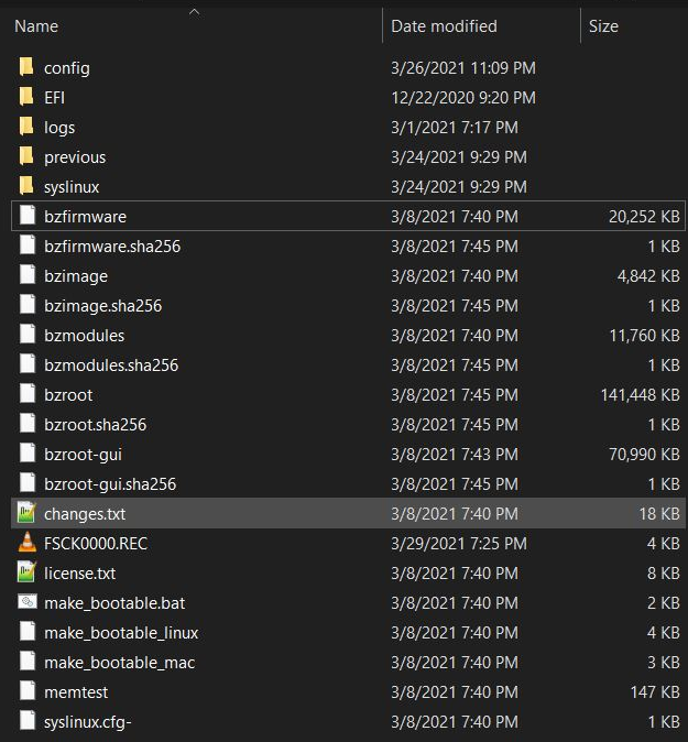

Thank you for the posts.  I did an eyeball comparison between the 6.83 CONFIG folder and the 6.9.1 CONFIG folder and they are definitely different. I also compared a bunch of files in other folders outside of the CONFIG folder and found too many file size differences between the files shown in the screen capture below:
In short, I elected to delete 6.9.1 from the USB stick and crossed over all the files I had originally zipped as a 6.8.3 version backup out of a concern that just crossing over the CONFIG folder was going to cause me some headaches.

this is what the backup option available by clicking on the Flash drive on the Main tab does.
It is really only the config folder that is important as all the files that are at the root of the flash drive are fixed for any given unRaid release - all user specific settings are in the config folder.
