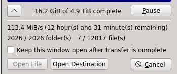

Ok... so I need to tranfser over the LAN
Started the transfer using NFS + Krusader, speed seems good

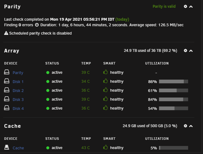

The migration process has been completed succefully!
Thank you all for your help!
