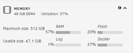

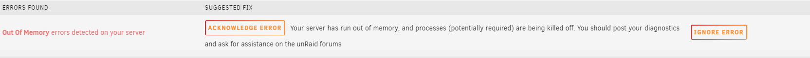

I am getting out of memory errors being reported so have attached my diags, if someone could help that would be great!  I am not seeing anything untoward though?

I set that size many years ago when I first installed unraid, never had an issue with it so never worried about it.
On a similar note, the usual reason for docker filling RAM is mapping a host path that isn't actual storage.
As above, not had any issues
