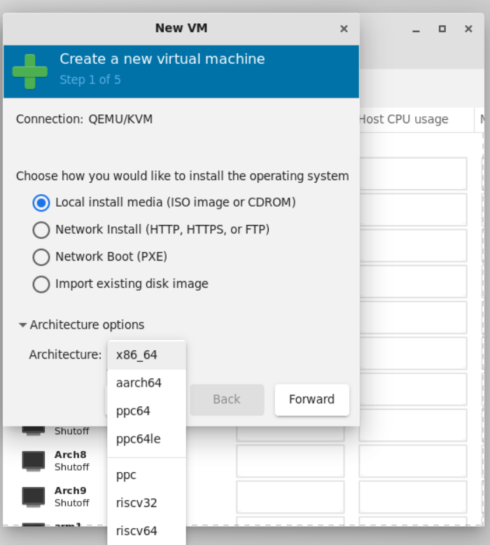

I dont suppose you know if you have SIO's MacInABox running (it adds the Virt-manager interface) if the Qemu-PPC and Qemu-Arm etc options show up in that? I'd love to have my unRAID box (when its back) run everything I could ever want ;-)
7 hours ago, methanoid said:
I missed the notification for this but not running unRAID right now but coming back V soon.
Sorry I dont run MacOS but do have virt manager running undrr docker will check.

is that the virt-man docker?
I usually have to grab proxmox QEMU code and use xml qemu commands to get this to work in unraid.
https://github.com/m-bers/docker-virt-manager
For some reason it no longer in the Comuntiy app store with lattest 6.12.10
I remember else where in another form post that the template floats.
flash drive \config\plugins\dockerMan\templates-user
my-Virt-Manager.xml
Yes this is my template.
