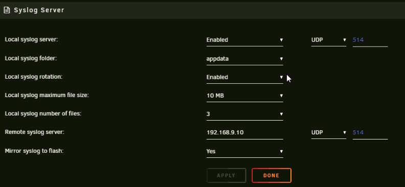

Here are my syslog settings

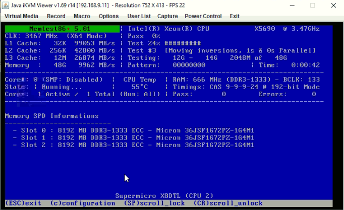

As I was gathering this information, it crashed again despite not using the system. I'm restarting the memtest. but for some reason it only shows 3 slots?
syslog-192.168.9.10.log
Nothing being logged about the crash usually points to a hardware problem, one more thing you can try it to boot the server in safe mode with all docker/VMs disable, let it run as a basic NAS for a few days, if it still crashes it's likely a hardware problem, if it doesn't start turning on the other services one by one.
Are you using a single CPU ?
No, dual xeons.
Interestingly, it does at least show the full capacity there: 48gb
You have ECC Memory.  The Memtest that comes with Unraid will not find any memory errors.  You need to create a boot stick with the updated one (google search.  Licensing prevents LT from including it in the OS)
Is that the one from PassMark or the open source one? Or does it matter?
The PassMark one is the one I've used to test ECC Memory. Be sure to boot to UEFI on the Memtest boot stick, not the traditional Memtest86 with the blue screen that is Legacy/BIOS boot. It will have both. The UEFI one is the one that did the trick for me testing ECC, i think the legacy one does not.

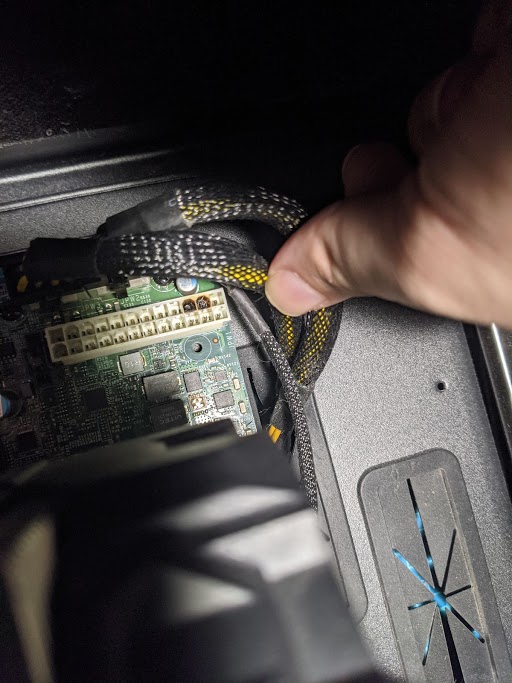

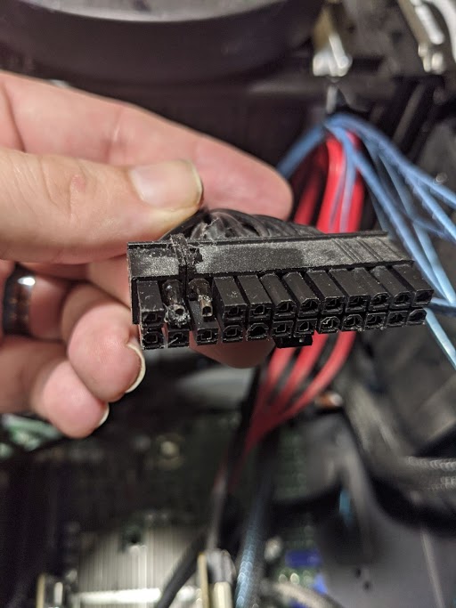

I figured out what is the cause of the server shutting off: https://imgur.com/a/RGSmkJz. Burnt 24 pin connector. Not sure if it's the power supply or the motherboard's fault. But time for some replacement parts. At least motherboard and power supply it seems.
Wonder if I should replace it with some newer hardware, and if so, which...
  • Majawat changed the title to [SOLVED] Recent Frequent Crashing (Not related to unRAID version or macvlan?)
Yes. That kind of damage is typically caused by a loose fit, where the metal on metal doesn't firmly hold, causing only a small spot to touch, causing high resistance and temperature. Technically the power supply end is what is supposed to provide the clamping and spring force, but the board tolerances probably didn't help. The motherboard could possibly be salvaged, by thoroughly cleaning the burnt parts on the metal posts inside the connector, but that would be a serious pain to do, probably with a very small bit on a dremel.
