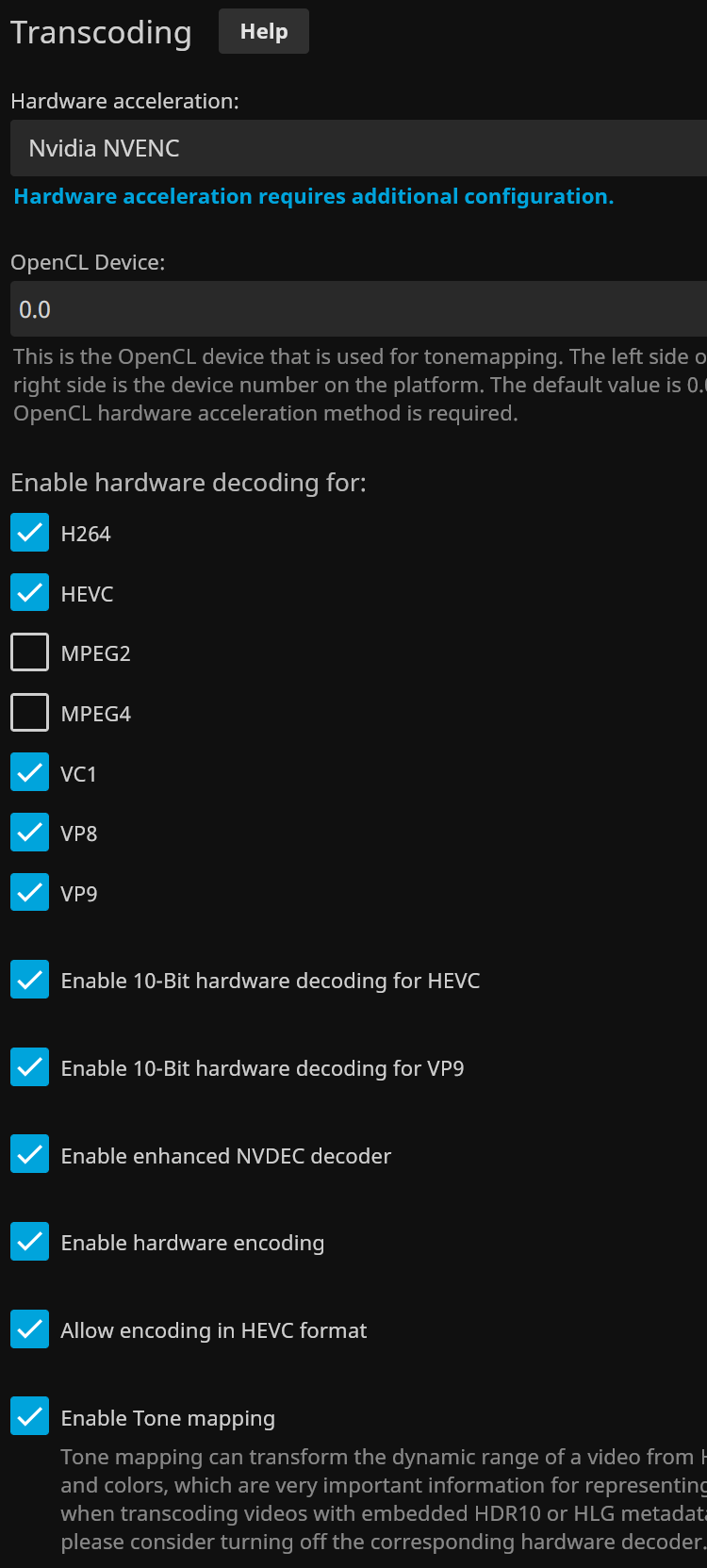

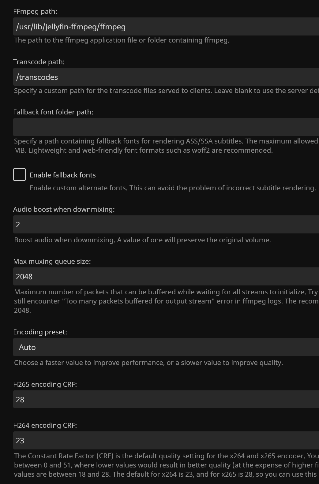

  8. Not sure of the decode/encode difference between P400 and T400, that may be a factor. But no, I just have it default. I've attached screen shots. Thanks for the quick reply, you are a great asset to this community!

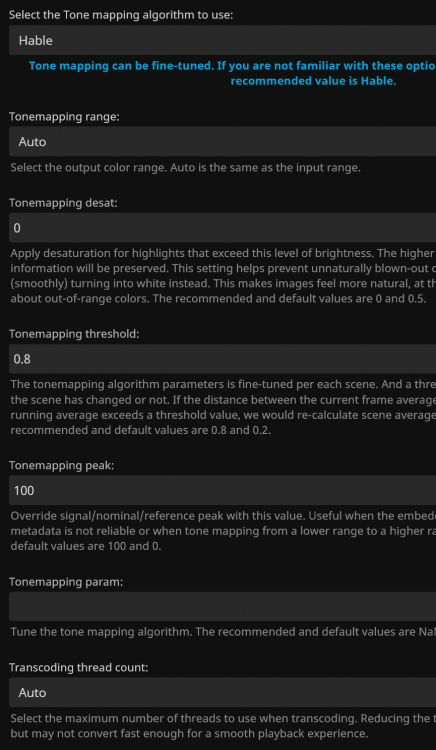

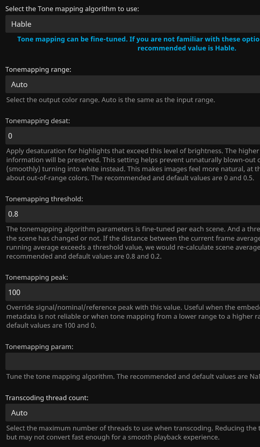

  9. Anyone have luck with tone mapping using a Quadro P400? Hardware transcoding seems to work fine as long as I disable tone mapping. It would be nice to have tone mapping, but obviously not a deal breaker. Just a slight annoyance since my 4K HDR content looks pretty bad if it is transcoded without tone mapping.
