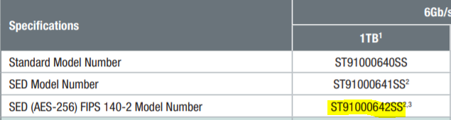

July 19, 20215 yr Looks like you have got the fips version which are sed enabled. You need to remove SED protection. SED FIPS 140-2 Models ST91000642SS ST9500622SS there is a PSID printed on the disk. i used this to reset the disk, by usng the below command where <PSIDNODASHS> is the PSID on the disk and device> is the device sedutil-cli --PSIDrevertAdminSP <PSIDNODASHS> /dev/<device> I am not sure where to get sedutil

July 20, 20215 yr See if you can replace the with the standard non encrypted model, these encrypted models can be a pain:
