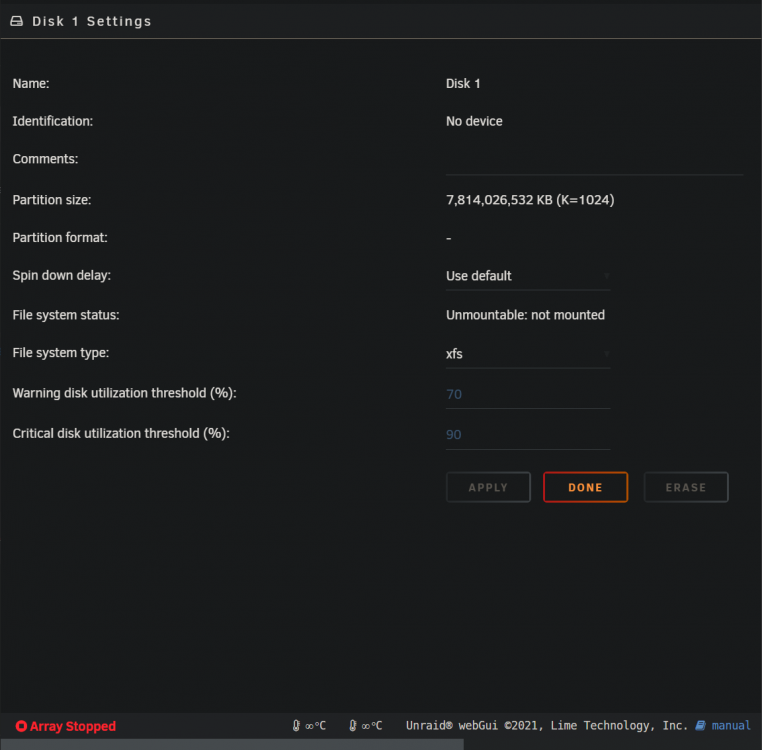

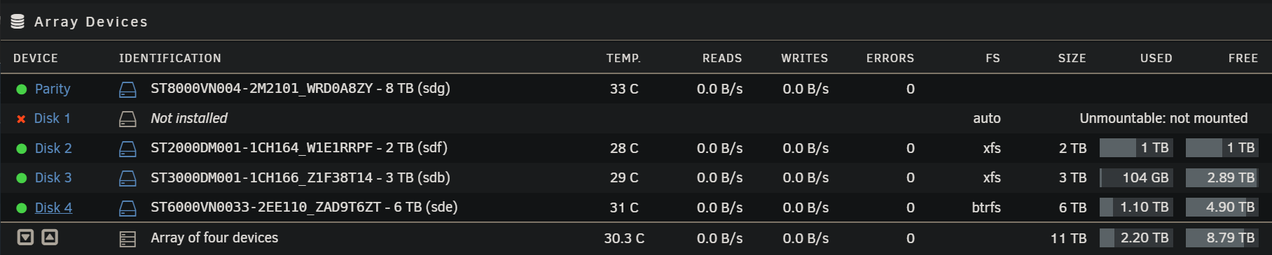

July 24, 20215 yr Author Hi guys, reporting from the front line. JorgeB: Your method worked - and didn't work at the same time. I was indeed able to start an array in maintenance mode while marking parity as good, get unRaid to accept Disk 2 as valid and then make it so that it shows it's emulating Disk 1 when I removed the replacement drive. Unfortunately, it can't mount the emulated disk and it wouldn't show up in the devices - so I can't even run a filesystem check on it. Am I missing something obvious? See screenshot below.
July 24, 20215 yr Community Expert 25 minutes ago, Jan Kuźniak said: so I can't even run a filesystem check on it. You can still run a filesystem check, using the console or GUI, for the latter first and with the array stopped click on it and set filesystem to xfs.
July 24, 20215 yr Community Expert Just now, JorgeB said: and set filesystem to xfs. Assuming it was xfs, I see you have a btrfs fs also.

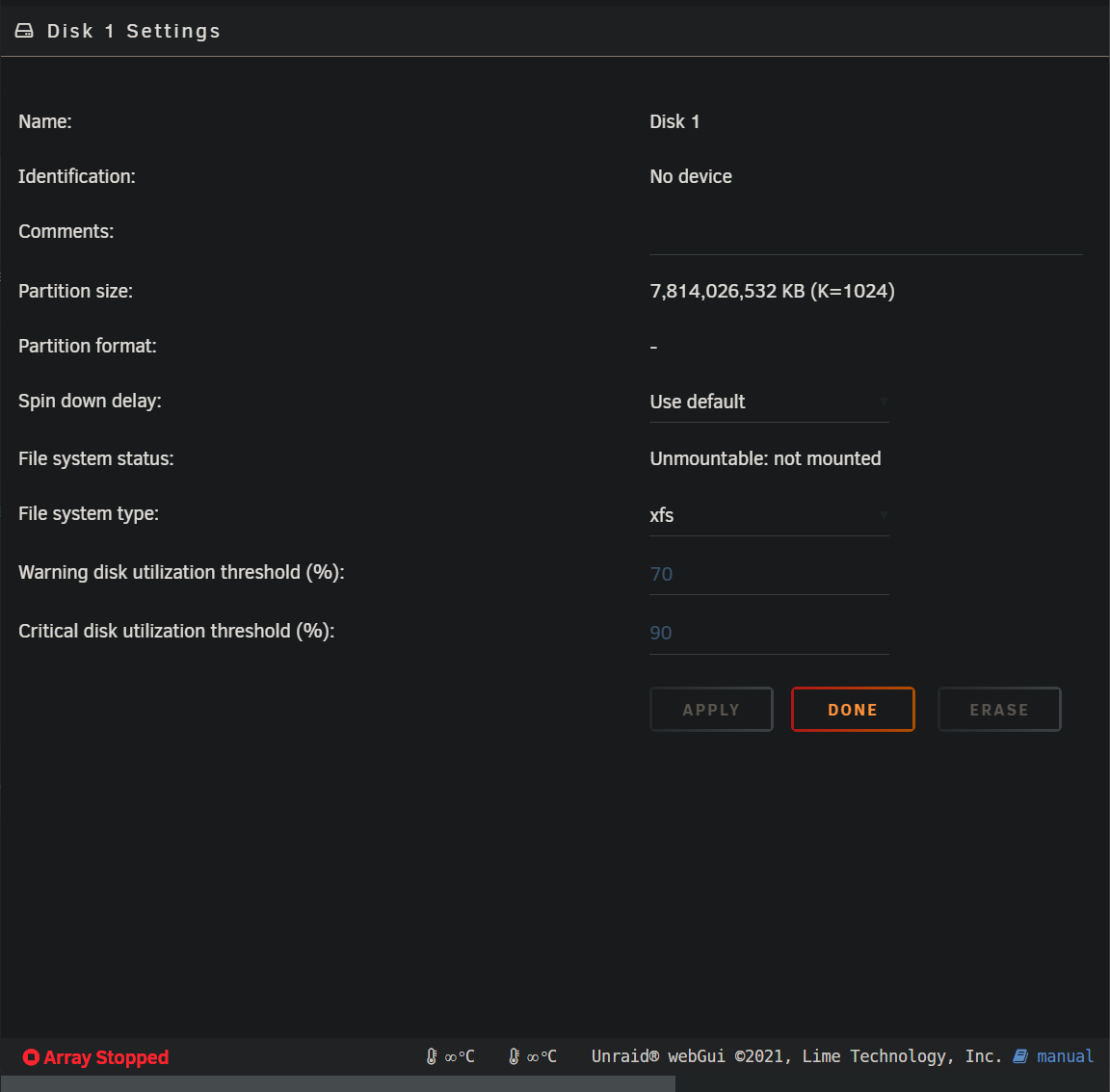

July 24, 20215 yr Author Yes, that disk was XFS. And here's an odd one - it wouldn't let me change the FS - the "apply" option is grayed out... Also, when I start the array in the maintenance mode, the "check filesystem status" section is missing. I'm tempted to try formatting the spare drive to XFS and re-doing the new config trick you posted at first - maybe that would fool the array into emulating the original FS? (double checking with you guys before I irreversibly fuck something up ;-))
July 24, 20215 yr Community Expert Use the console, start the array in maintenance mode and type: xfs_repair -v /dev/md1
July 24, 20215 yr Author Seems to have worked, you're my Hero! I'll attempt recovering the data and let you know how that went.
