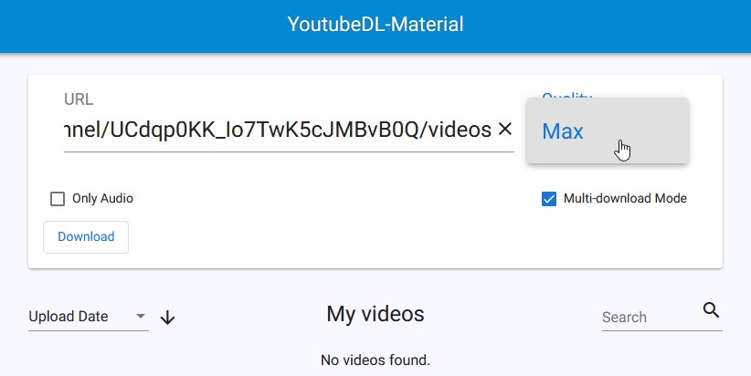

July 25, 20215 yr 48 minutes ago, TexasUnraid said: Tartube is the only youtube downloader I have found that allows you to download a channel AND select the quality of the downloaded videos Have you tried https://github.com/Tzahi12345/YoutubeDL-Material

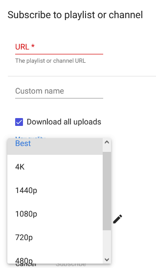

July 25, 20215 yr Author 7 minutes ago, jonathanm said: Have you tried https://github.com/Tzahi12345/YoutubeDL-Material Yes, the quality setting only has a "max" option. Not sure why it is even there honestly.
July 25, 20215 yr 1 hour ago, TexasUnraid said: Yes, the quality setting only has a "max" option. Not sure why it is even there honestly. ??
July 26, 20215 yr Author I am using the unraid CA docker for that program and this is all I get: I have like 6 or 7 dockers installed right now that download youtube and none of them let me select the quality sadly. 😪 Also after trying tartube on windows, it really is a step ahead of the rest as well would seem to make a good candidate for a docker.
July 26, 20215 yr 2 minutes ago, TexasUnraid said: I am using the unraid CA docker for that program and this is all I get: The dialog you are showing is for 1 off downloads, the subscription / playlist dialog has other options.
July 26, 20215 yr Author 5 minutes ago, jonathanm said: The dialog you are showing is for 1 off downloads, the subscription / playlist dialog has other options. Very interesting, the UI was too simple and I didn't even notice it had another area for downloads. Testing it now. Thanks for the heads up! I still think that tartube would make for a good docker though, in my quick testing of it I really liked the feature set and options compared to this one. Also more intuitive.

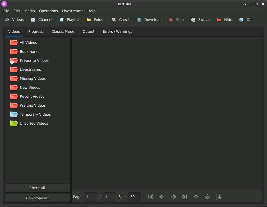

July 27, 20215 yr Author Ok, trying to setup the tartube in buster, took a bit to get all the dependencies sorted out but it seems to be working now. This issue now is that the user.sh script does not seem to be able to start tartube? If I run the script manually it starts it up perfectly but when I restart the container it does not? edit: after some trial and error I figured out part of the problem was that the user.sh script is run before the desktop is started. I tried to work around that by starting another script with a delay but that also failed for some reason. So I ended up using the built in startup option in debian and that seems to work. Edited July 27, 20215 yr by TexasUnraid
July 27, 20215 yr Author So looks like I have tartube running ok. I decided to commit the changes and create a new container so that an update would not wipe it. I am curious, is there an easy way to change the page title and icon for the VNC window?

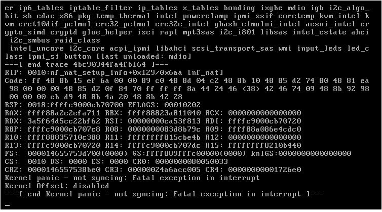

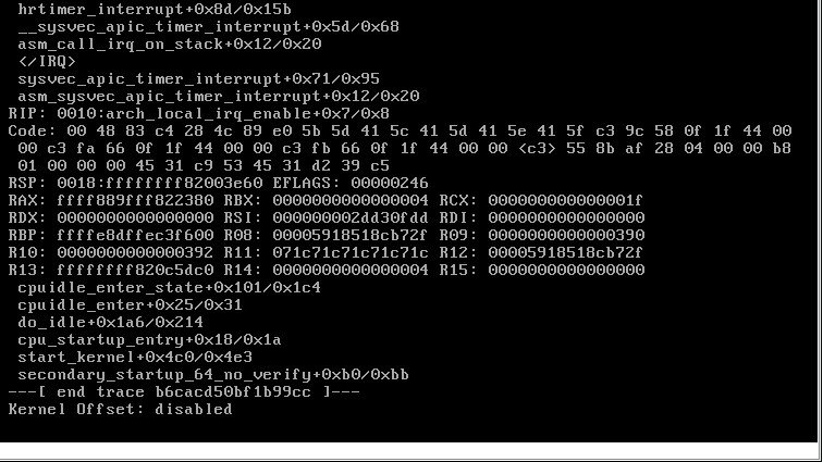

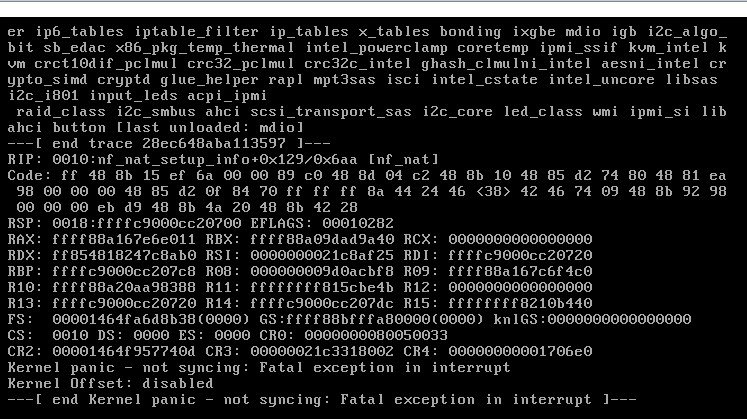

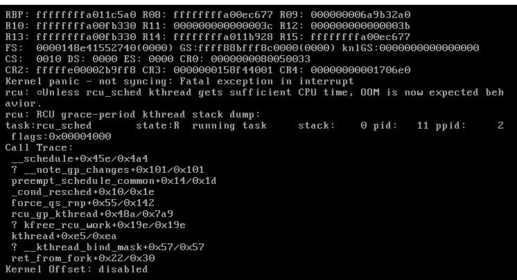

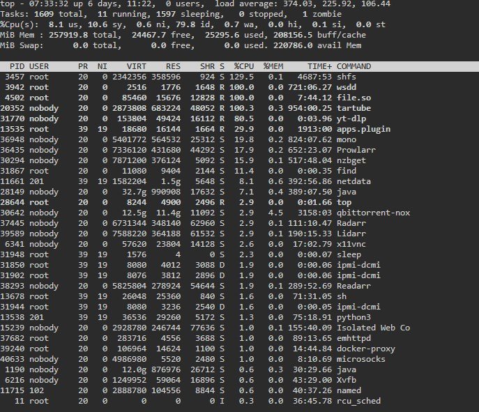

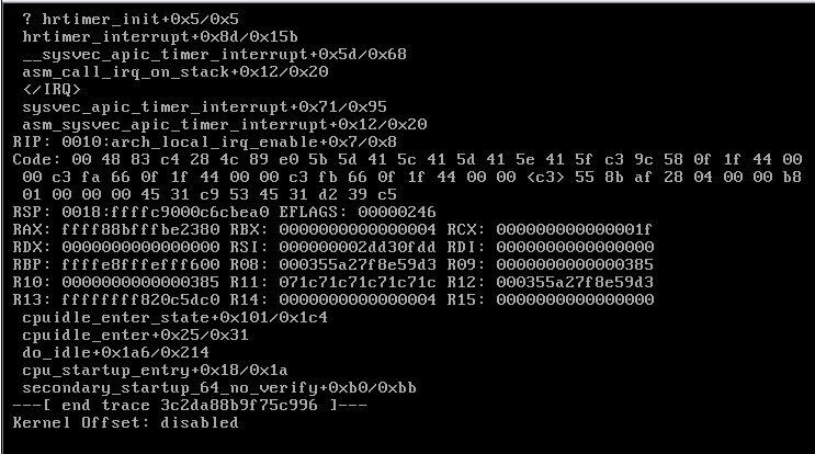

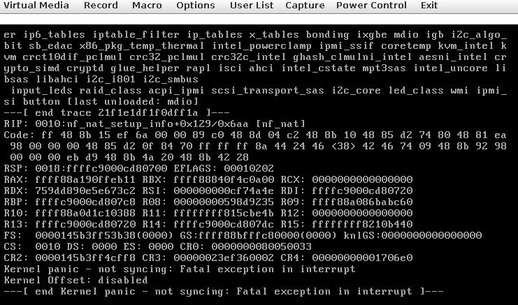

January 31, 20224 yr Author @ich777 TL:DR After ~6 months of testing and issues The Buster docker with tartube installed causes the entire server to crash with a kernel panic of some sort. I have some of the errors screen shotted if you want them. I was not aware this was even possible with how docker is setup? Is it possible to make a tartube docker that would not cause crashes like this? I have really fallen in love with the program after using it. I installed it in a VM and while it sort of works the slow SMB interface that unraid/linux has with small files seems to cause timeout issues beyond it simply taking forever to do stuff. the long version: So after using the buster docker with tartube for the last 6 months (which I love the program BTW), I think I FINALLY found what was causing my random kernel panics / crashes. It would sometimes last a week and others hours but sooner or later the whole system would hard crash and need a reboot. I started in safe mode and it never seemed to crash so I knew it was some kind of plugin but after testing all of those, it was still crashing. I was not aware that a docker could even crash the main system so I ignored them for a long time but then by chance I had a lot of dockers turned off while testing something else for a few weeks and noticed the long uptime but could not figure it out. After a lot of testing I think I narrowed it down to the tartube docker, I can't think of a time it crashed without it running. If I start it, it crashes at some point. The crashes also started about when I installed it in the first place.
January 31, 20224 yr 6 minutes ago, TexasUnraid said: I have some of the errors screen shotted if you want them. Sure, send them over please. 6 minutes ago, TexasUnraid said: I was not aware this was even possible with how docker is setup? A container can also crash the host if something goes terribly wrong... The best example is check_mk2.0 6 minutes ago, TexasUnraid said: Is it possible to make a tartube docker Have to look into this... EDIT: I also have to say that the Buster container is now outdated and the Bullseye container should be used, you can simply switch the repository in the template and everything should work right OOB.
January 31, 20224 yr Author 8 minutes ago, ich777 said: Sure, send them over please. A container can also crash the host if something goes terribly wrong... The best example is check_mk2.0 Have to look into this... Ok Thanks, here are the errors I was able to capture, the entire system would hard lock so I could not get the logs or anything. I did catch it mid-crash once and was able to extract this from the log before it died completely, this is actually what led me to suspect tartube was the issue due to the next image: ErrorWarningSystemArrayLogin Jan 16 07:29:58 NAS kernel: asm_call_irq_on_stack+0x12/0x20 Jan 16 07:29:58 NAS kernel: </IRQ> Jan 16 07:29:58 NAS kernel: sysvec_apic_timer_interrupt+0x71/0x95 Jan 16 07:29:58 NAS kernel: asm_sysvec_apic_timer_interrupt+0x12/0x20 Jan 16 07:29:58 NAS kernel: RIP: 0010:xas_descend+0x1e/0x49 Jan 16 07:29:58 NAS kernel: Code: 08 48 d3 e6 48 01 f0 48 89 47 08 c3 0f b6 0e 49 89 f9 48 8b 47 08 48 d3 e8 48 89 c1 83 e1 3f 89 c8 48 83 c0 04 4c 8b 44 c6 08 <48> 89 77 18 4c 89 c7 e8 77 ff ff ff 84 c0 74 13 49 c1 e8 02 44 89 Jan 16 07:29:58 NAS kernel: RSP: 0018:ffffc90034a67a38 EFLAGS: 00000216 Jan 16 07:29:58 NAS kernel: RAX: 0000000000000021 RBX: 0000000000000007 RCX: 000000000000001d Jan 16 07:29:58 NAS kernel: RDX: 0000000000000001 RSI: ffff88a28bc6c490 RDI: ffffc90034a67a48 Jan 16 07:29:58 NAS kernel: RBP: ffff88923c7c3358 R08: ffff88821d8eb688 R09: ffffc90034a67a48 Jan 16 07:29:58 NAS kernel: R10: ffffc90034a67a48 R11: 000000000000000e R12: ffff88821d8eb688 Jan 16 07:29:58 NAS kernel: R13: ffff88923c7c34c8 R14: 000000000001c05d R15: ffff88a64cb1ea68 Jan 16 07:29:58 NAS kernel: ? xas_descend+0x2a/0x49 Jan 16 07:29:58 NAS kernel: xas_load+0x2d/0x39 Jan 16 07:29:58 NAS kernel: find_get_entry+0x57/0xba Jan 16 07:29:58 NAS kernel: pagecache_get_page+0x20/0x13e Jan 16 07:29:58 NAS kernel: prepare_pages+0x73/0x133 Jan 16 07:29:58 NAS kernel: btrfs_buffered_write+0x285/0x5a2 Jan 16 07:29:58 NAS kernel: ? update_load_avg+0x39/0x2c4 Jan 16 07:29:58 NAS kernel: btrfs_file_write_iter+0x3cc/0x4b1 Jan 16 07:29:58 NAS kernel: do_iter_readv_writev+0x97/0xd7 Jan 16 07:29:58 NAS kernel: do_iter_write+0x7f/0xc0 Jan 16 07:29:58 NAS kernel: iter_file_splice_write+0x215/0x313 Jan 16 07:29:58 NAS kernel: direct_splice_actor+0x2e/0x2f Jan 16 07:29:58 NAS kernel: splice_direct_to_actor+0x125/0x1cd Jan 16 07:29:58 NAS kernel: ? generic_file_splice_read+0x15e/0x15e Jan 16 07:29:58 NAS kernel: do_splice_direct+0x94/0xbd Jan 16 07:29:58 NAS kernel: do_sendfile+0x185/0x24f Jan 16 07:29:58 NAS kernel: __do_sys_sendfile64+0x61/0xa7 Jan 16 07:29:58 NAS kernel: do_syscall_64+0x5d/0x6a Jan 16 07:29:58 NAS kernel: entry_SYSCALL_64_after_hwframe+0x44/0xa9 Jan 16 07:29:58 NAS kernel: RIP: 0033:0x7efe3948e68e Jan 16 07:29:58 NAS kernel: Code: c3 0f 1f 00 4c 89 d2 4c 89 c6 e9 bd fd ff ff 0f 1f 44 00 00 31 c0 c3 0f 1f 44 00 00 f3 0f 1e fa 49 89 ca b8 28 00 00 00 0f 05 <48> 3d 01 f0 ff ff 73 01 c3 48 8b 0d d2 a7 0c 00 f7 d8 64 89 01 48 Jan 16 07:29:58 NAS kernel: RSP: 002b:00007ffe62eb1b68 EFLAGS: 00000246 ORIG_RAX: 0000000000000028 Jan 16 07:29:58 NAS kernel: RAX: ffffffffffffffda RBX: 00007ffe62eb1c20 RCX: 00007efe3948e68e Jan 16 07:29:58 NAS kernel: RDX: 00007ffe62eb1c40 RSI: 0000000000000005 RDI: 0000000000000007 Jan 16 07:29:58 NAS kernel: RBP: 00007ffe62f31fb0 R08: 0000000000000000 R09: 000000000008871d Jan 16 07:29:58 NAS kernel: R10: 0000000000080000 R11: 0000000000000246 R12: 00007ffe62eb1c10 Jan 16 07:29:58 NAS kernel: R13: 00007ffe62eb1c40 R14: 00007ffe62eb1bd8 R15: 00007ffe62eb1bd0 Jan 16 07:32:58 NAS kernel: rcu: INFO: rcu_sched self-detected stall on CPU Jan 16 07:32:58 NAS kernel: rcu: 36-....: (420005 ticks this GP) idle=692/1/0x4000000000000000 softirq=29122084/29122084 fqs=104638 Jan 16 07:32:58 NAS kernel: (t=420006 jiffies g=214476629 q=4370531) Jan 16 07:32:58 NAS kernel: NMI backtrace for cpu 36 Jan 16 07:32:58 NAS kernel: CPU: 36 PID: 4502 Comm: file.so Tainted: G O 5.10.28-Unraid #1 Jan 16 07:32:58 NAS kernel: Hardware name: Supermicro X9DAX/X9DAX, BIOS 3.2a 06/30/2015 Jan 16 07:32:58 NAS kernel: Call Trace: Jan 16 07:32:58 NAS kernel: <IRQ> Jan 16 07:32:58 NAS kernel: dump_stack+0x6b/0x83 Jan 16 07:32:58 NAS kernel: ? lapic_can_unplug_cpu+0x8e/0x8e Jan 16 07:32:58 NAS kernel: nmi_cpu_backtrace+0x7d/0x8f Jan 16 07:32:58 NAS kernel: nmi_trigger_cpumask_backtrace+0x56/0xd3 Jan 16 07:32:58 NAS kernel: rcu_dump_cpu_stacks+0x9f/0xc6 Jan 16 07:32:58 NAS kernel: rcu_sched_clock_irq+0x1ec/0x543 Jan 16 07:32:58 NAS kernel: ? _raw_spin_unlock_irqrestore+0xd/0xe Jan 16 07:32:58 NAS kernel: update_process_times+0x50/0x6e Jan 16 07:32:58 NAS kernel: tick_sched_timer+0x36/0x64 Jan 16 07:32:58 NAS kernel: __hrtimer_run_queues+0xb7/0x10b Jan 16 07:32:58 NAS kernel: ? tick_sched_do_timer+0x39/0x39 Jan 16 07:32:58 NAS kernel: hrtimer_interrupt+0x8d/0x15b Jan 16 07:32:58 NAS kernel: __sysvec_apic_timer_interrupt+0x5d/0x68 Jan 16 07:32:58 NAS kernel: asm_call_irq_on_stack+0x12/0x20 Jan 16 07:32:58 NAS kernel: </IRQ> Jan 16 07:32:58 NAS kernel: sysvec_apic_timer_interrupt+0x71/0x95 Jan 16 07:32:58 NAS kernel: asm_sysvec_apic_timer_interrupt+0x12/0x20 Jan 16 07:32:58 NAS kernel: RIP: 0010:__page_cache_add_speculative.constprop.0+0x17/0x1f Jan 16 07:32:58 NAS kernel: Code: 00 00 48 89 ef e8 7a fd ff ff 48 89 ef 5d e9 87 fa ff ff 8b 57 34 85 d2 74 10 8d 4a 01 89 d0 f0 0f b1 4f 34 74 04 89 c2 eb ec <31> c0 85 d2 0f 95 c0 c3 41 54 65 48 8b 04 25 c0 7b 01 00 55 89 fd Jan 16 07:32:58 NAS kernel: RSP: 0018:ffffc90034a67a40 EFLAGS: 00000246 Jan 16 07:32:58 NAS kernel: RAX: ffff88821d8eb688 RBX: 0000000000000007 RCX: 000000000000001d Jan 16 07:32:58 NAS kernel: RDX: 0000000000000000 RSI: ffff88a28bc6c490 RDI: ffff88821d8eb688 Jan 16 07:32:58 NAS kernel: RBP: ffff88923c7c3358 R08: ffff88821d8eb688 R09: ffffc90034a67a48 Jan 16 07:32:58 NAS kernel: R10: ffffc90034a67a48 R11: 000000000000000e R12: ffff88821d8eb688 Jan 16 07:32:58 NAS kernel: R13: ffff88923c7c34c8 R14: 000000000001c05d R15: ffff88a64cb1ea68 Jan 16 07:32:58 NAS kernel: find_get_entry+0x7b/0xba Jan 16 07:32:58 NAS kernel: pagecache_get_page+0x20/0x13e Jan 16 07:32:58 NAS kernel: prepare_pages+0x73/0x133 Jan 16 07:32:58 NAS kernel: btrfs_buffered_write+0x285/0x5a2 Jan 16 07:32:58 NAS kernel: ? update_load_avg+0x39/0x2c4 Jan 16 07:32:58 NAS kernel: btrfs_file_write_iter+0x3cc/0x4b1 Jan 16 07:32:58 NAS kernel: do_iter_readv_writev+0x97/0xd7 Jan 16 07:32:58 NAS kernel: do_iter_write+0x7f/0xc0 Jan 16 07:32:58 NAS kernel: iter_file_splice_write+0x215/0x313 Jan 16 07:32:58 NAS kernel: direct_splice_actor+0x2e/0x2f Jan 16 07:32:58 NAS kernel: splice_direct_to_actor+0x125/0x1cd Jan 16 07:32:58 NAS kernel: ? generic_file_splice_read+0x15e/0x15e Jan 16 07:32:58 NAS kernel: do_splice_direct+0x94/0xbd Jan 16 07:32:58 NAS kernel: do_sendfile+0x185/0x24f Jan 16 07:32:58 NAS kernel: __do_sys_sendfile64+0x61/0xa7 Jan 16 07:32:58 NAS kernel: do_syscall_64+0x5d/0x6a Jan 16 07:32:58 NAS kernel: entry_SYSCALL_64_after_hwframe+0x44/0xa9 Jan 16 07:32:58 NAS kernel: RIP: 0033:0x7efe3948e68e Jan 16 07:32:58 NAS kernel: Code: c3 0f 1f 00 4c 89 d2 4c 89 c6 e9 bd fd ff ff 0f 1f 44 00 00 31 c0 c3 0f 1f 44 00 00 f3 0f 1e fa 49 89 ca b8 28 00 00 00 0f 05 <48> 3d 01 f0 ff ff 73 01 c3 48 8b 0d d2 a7 0c 00 f7 d8 64 89 01 48 Jan 16 07:32:58 NAS kernel: RSP: 002b:00007ffe62eb1b68 EFLAGS: 00000246 ORIG_RAX: 0000000000000028 Jan 16 07:32:58 NAS kernel: RAX: ffffffffffffffda RBX: 00007ffe62eb1c20 RCX: 00007efe3948e68e Jan 16 07:32:58 NAS kernel: RDX: 00007ffe62eb1c40 RSI: 0000000000000005 RDI: 0000000000000007 Jan 16 07:32:58 NAS kernel: RBP: 00007ffe62f31fb0 R08: 0000000000000000 R09: 000000000008871d Jan 16 07:32:58 NAS kernel: R10: 0000000000080000 R11: 0000000000000246 R12: 00007ffe62eb1c10 Jan 16 07:32:58 NAS kernel: R13: 00007ffe62eb1c40 R14: 00007ffe62eb1bd8 R15: 00007ffe62eb1bd0 Jan 16 07:33:04 NAS nginx: 2022/01/16 07:33:04 [error] 38735#38735: *1873274 upstream timed out (110: Connection timed out) while reading upstream, client: 192.168.1.20, server: , request: "GET /favicon.ico HTTP/2.0", upstream: "fastcgi://unix:/var/run/php5-fpm.sock:", host: "nas.local", referrer: "https://nas.local/logging.htm" Jan 16 07:35:58 NAS kernel: rcu: INFO: rcu_sched self-detected stall on CPU Jan 16 07:35:58 NAS kernel: rcu: 36-....: (600008 ticks this GP) idle=692/1/0x4000000000000000 softirq=29122084/29122084 fqs=149437 Jan 16 07:35:58 NAS kernel: (t=600009 jiffies g=214476629 q=6281381) Jan 16 07:35:58 NAS kernel: NMI backtrace for cpu 36 Jan 16 07:35:58 NAS kernel: CPU: 36 PID: 4502 Comm: file.so Tainted: G O 5.10.28-Unraid #1 Jan 16 07:35:58 NAS kernel: Hardware name: Supermicro X9DAX/X9DAX, BIOS 3.2a 06/30/2015 Jan 16 07:35:58 NAS kernel: Call Trace: Jan 16 07:35:58 NAS kernel: <IRQ> Jan 16 07:35:58 NAS kernel: dump_stack+0x6b/0x83 Jan 16 07:35:58 NAS kernel: ? lapic_can_unplug_cpu+0x8e/0x8e Jan 16 07:35:58 NAS kernel: nmi_cpu_backtrace+0x7d/0x8f Jan 16 07:35:58 NAS kernel: nmi_trigger_cpumask_backtrace+0x56/0xd3 Jan 16 07:35:58 NAS kernel: rcu_dump_cpu_stacks+0x9f/0xc6 Jan 16 07:35:58 NAS kernel: rcu_sched_clock_irq+0x1ec/0x543 Jan 16 07:35:58 NAS kernel: ? _raw_spin_unlock_irqrestore+0xd/0xe Jan 16 07:35:58 NAS kernel: update_process_times+0x50/0x6e Jan 16 07:35:58 NAS kernel: tick_sched_timer+0x36/0x64 Jan 16 07:35:58 NAS kernel: __hrtimer_run_queues+0xb7/0x10b Jan 16 07:35:58 NAS kernel: ? tick_sched_do_timer+0x39/0x39 Jan 16 07:35:58 NAS kernel: hrtimer_interrupt+0x8d/0x15b Jan 16 07:35:58 NAS kernel: __sysvec_apic_timer_interrupt+0x5d/0x68 Jan 16 07:35:58 NAS kernel: asm_call_irq_on_stack+0x12/0x20 Jan 16 07:35:58 NAS kernel: </IRQ> Jan 16 07:35:58 NAS kernel: sysvec_apic_timer_interrupt+0x71/0x95 Jan 16 07:35:58 NAS kernel: asm_sysvec_apic_timer_interrupt+0x12/0x20 Jan 16 07:35:58 NAS kernel: RIP: 0010:find_get_entry+0x62/0xba Jan 16 07:35:58 NAS kernel: Code: 20 00 00 00 00 48 c7 44 24 28 00 00 00 00 48 c7 44 24 18 03 00 00 00 48 89 e7 e8 8d c0 26 00 48 3d 06 04 00 00 49 89 c4 74 e4 <48> 3d 02 04 00 00 74 dc 48 85 c0 74 27 a8 01 75 23 48 89 c7 e8 b8 Jan 16 07:35:58 NAS kernel: RSP: 0018:ffffc90034a67a48 EFLAGS: 00000286 Jan 16 07:35:58 NAS kernel: RAX: ffff88821d8eb688 RBX: 0000000000000007 RCX: 000000000000001d Jan 16 07:35:58 NAS kernel: RDX: 0000000000000000 RSI: ffff88a28bc6c490 RDI: ffff88821d8eb688 Jan 16 07:35:58 NAS kernel: RBP: ffff88923c7c3358 R08: ffff88821d8eb688 R09: ffffc90034a67a48 Jan 16 07:35:58 NAS kernel: R10: ffffc90034a67a48 R11: 000000000000000e R12: ffff88821d8eb688 Jan 16 07:35:58 NAS kernel: R13: ffff88923c7c34c8 R14: 000000000001c05d R15: ffff88a64cb1ea68 Jan 16 07:35:58 NAS kernel: ? find_get_entry+0x57/0xba Jan 16 07:35:58 NAS kernel: pagecache_get_page+0x20/0x13e Jan 16 07:35:58 NAS kernel: prepare_pages+0x73/0x133 Jan 16 07:35:58 NAS kernel: btrfs_buffered_write+0x285/0x5a2 Jan 16 07:35:58 NAS kernel: ? update_load_avg+0x39/0x2c4 Jan 16 07:35:58 NAS kernel: btrfs_file_write_iter+0x3cc/0x4b1 Jan 16 07:35:58 NAS kernel: do_iter_readv_writev+0x97/0xd7 Jan 16 07:35:58 NAS kernel: do_iter_write+0x7f/0xc0 Jan 16 07:35:58 NAS kernel: iter_file_splice_write+0x215/0x313 Jan 16 07:35:58 NAS kernel: direct_splice_actor+0x2e/0x2f Jan 16 07:35:58 NAS kernel: splice_direct_to_actor+0x125/0x1cd Jan 16 07:35:58 NAS kernel: ? generic_file_splice_read+0x15e/0x15e Jan 16 07:35:58 NAS kernel: do_splice_direct+0x94/0xbd Jan 16 07:35:58 NAS kernel: do_sendfile+0x185/0x24f Jan 16 07:35:58 NAS kernel: __do_sys_sendfile64+0x61/0xa7 Jan 16 07:35:58 NAS kernel: do_syscall_64+0x5d/0x6a Jan 16 07:35:58 NAS kernel: entry_SYSCALL_64_after_hwframe+0x44/0xa9 Jan 16 07:35:58 NAS kernel: RIP: 0033:0x7efe3948e68e Jan 16 07:35:58 NAS kernel: Code: c3 0f 1f 00 4c 89 d2 4c 89 c6 e9 bd fd ff ff 0f 1f 44 00 00 31 c0 c3 0f 1f 44 00 00 f3 0f 1e fa 49 89 ca b8 28 00 00 00 0f 05 <48> 3d 01 f0 ff ff 73 01 c3 48 8b 0d d2 a7 0c 00 f7 d8 64 89 01 48 Jan 16 07:35:58 NAS kernel: RSP: 002b:00007ffe62eb1b68 EFLAGS: 00000246 ORIG_RAX: 0000000000000028 Jan 16 07:35:58 NAS kernel: RAX: ffffffffffffffda RBX: 00007ffe62eb1c20 RCX: 00007efe3948e68e Jan 16 07:35:58 NAS kernel: RDX: 00007ffe62eb1c40 RSI: 0000000000000005 RDI: 0000000000000007 Jan 16 07:35:58 NAS kernel: RBP: 00007ffe62f31fb0 R08: 0000000000000000 R09: 000000000008871d Jan 16 07:35:58 NAS kernel: R10: 0000000000080000 R11: 0000000000000246 R12: 00007ffe62eb1c10 Jan 16 07:35:58 NAS kernel: R13: 00007ffe62eb1c40 R14: 00007ffe62eb1bd8 R15: 00007ffe62eb1bd0 Jan 16 07:37:14 NAS nginx: 2022/01/16 07:37:14 [error] 38735#38735: *1874493 upstream timed out (110: Connection timed out) while reading upstream, client: 192.168.1.20, server: , request: "GET /Dashboard HTTP/2.0", upstream: "fastcgi://unix:/var/run/php5-fpm.sock:", host: "nas.local", referrer: "https://nas.local/script" Jan 16 07:38:58 NAS kernel: rcu: INFO: rcu_sched self-detected stall on CPU Jan 16 07:38:58 NAS kernel: rcu: 36-....: (780011 ticks this GP) idle=692/1/0x4000000000000000 softirq=29122084/29122084 fqs=194300 Jan 16 07:38:58 NAS kernel: (t=780012 jiffies g=214476629 q=8153649) Jan 16 07:38:58 NAS kernel: NMI backtrace for cpu 36 Jan 16 07:38:58 NAS kernel: CPU: 36 PID: 4502 Comm: file.so Tainted: G O 5.10.28-Unraid #1 Jan 16 07:38:58 NAS kernel: Hardware name: Supermicro X9DAX/X9DAX, BIOS 3.2a 06/30/2015 Jan 16 07:38:58 NAS kernel: Call Trace: Jan 16 07:38:58 NAS kernel: <IRQ> Jan 16 07:38:58 NAS kernel: dump_stack+0x6b/0x83 Jan 16 07:38:58 NAS kernel: ? lapic_can_unplug_cpu+0x8e/0x8e Jan 16 07:38:58 NAS kernel: nmi_cpu_backtrace+0x7d/0x8f Jan 16 07:38:58 NAS kernel: nmi_trigger_cpumask_backtrace+0x56/0xd3 Jan 16 07:38:58 NAS kernel: rcu_dump_cpu_stacks+0x9f/0xc6 Jan 16 07:38:58 NAS kernel: rcu_sched_clock_irq+0x1ec/0x543 Jan 16 07:38:58 NAS kernel: ? _raw_spin_unlock_irqrestore+0xd/0xe Jan 16 07:38:58 NAS kernel: update_process_times+0x50/0x6e Jan 16 07:38:58 NAS kernel: tick_sched_timer+0x36/0x64 Jan 16 07:38:58 NAS kernel: __hrtimer_run_queues+0xb7/0x10b Jan 16 07:38:58 NAS kernel: ? tick_sched_do_timer+0x39/0x39 Jan 16 07:38:58 NAS kernel: hrtimer_interrupt+0x8d/0x15b Jan 16 07:38:58 NAS kernel: __sysvec_apic_timer_interrupt+0x5d/0x68 Jan 16 07:38:58 NAS kernel: asm_call_irq_on_stack+0x12/0x20 Jan 16 07:38:58 NAS kernel: </IRQ> Jan 16 07:38:58 NAS kernel: sysvec_apic_timer_interrupt+0x71/0x95 Jan 16 07:38:58 NAS kernel: asm_sysvec_apic_timer_interrupt+0x12/0x20 Jan 16 07:38:58 NAS kernel: RIP: 0010:xa_is_sibling+0x6/0x1a Jan 16 07:38:58 NAS kernel: Code: 10 c3 c6 07 00 0f 1f 40 00 c3 48 89 f8 83 e0 03 48 83 f8 02 0f 94 c0 48 81 ff 00 10 00 00 0f 97 c2 21 d0 c3 48 89 f8 83 e0 03 <48> 83 f8 02 0f 94 c0 48 81 ff fd 00 00 00 0f 96 c2 21 d0 c3 40 f6 Jan 16 07:38:58 NAS kernel: RSP: 0018:ffffc90034a67a30 EFLAGS: 00000202 Jan 16 07:38:58 NAS kernel: RAX: 0000000000000002 RBX: 0000000000000007 RCX: 000000000000001c Jan 16 07:38:58 NAS kernel: RDX: 0000000000000001 RSI: ffff88a3f19fc490 RDI: ffff88a28bc6e482 Jan 16 07:38:58 NAS kernel: RBP: ffff88923c7c3358 R08: ffff88a28bc6e482 R09: ffffc90034a67a48 Jan 16 07:38:58 NAS kernel: R10: ffffc90034a67a48 R11: 000000000000000e R12: ffff88821d8eb688 Jan 16 07:38:58 NAS kernel: R13: ffff88923c7c34c8 R14: 000000000001c05d R15: ffff88a64cb1ea68 Jan 16 07:38:58 NAS kernel: xas_descend+0x2a/0x49 Jan 16 07:38:58 NAS kernel: xas_load+0x2d/0x39 Jan 16 07:38:58 NAS kernel: find_get_entry+0x57/0xba Jan 16 07:38:58 NAS kernel: pagecache_get_page+0x20/0x13e Jan 16 07:38:58 NAS kernel: prepare_pages+0x73/0x133 Jan 16 07:38:58 NAS kernel: btrfs_buffered_write+0x285/0x5a2 Jan 16 07:38:58 NAS kernel: ? update_load_avg+0x39/0x2c4 Jan 16 07:38:58 NAS kernel: btrfs_file_write_iter+0x3cc/0x4b1 Jan 16 07:38:58 NAS kernel: do_iter_readv_writev+0x97/0xd7 Jan 16 07:38:58 NAS kernel: do_iter_write+0x7f/0xc0 Jan 16 07:38:58 NAS kernel: iter_file_splice_write+0x215/0x313 Jan 16 07:38:58 NAS kernel: direct_splice_actor+0x2e/0x2f Jan 16 07:38:58 NAS kernel: splice_direct_to_actor+0x125/0x1cd Jan 16 07:38:58 NAS kernel: ? generic_file_splice_read+0x15e/0x15e Jan 16 07:38:58 NAS kernel: do_splice_direct+0x94/0xbd Jan 16 07:38:58 NAS kernel: do_sendfile+0x185/0x24f Jan 16 07:38:58 NAS kernel: __do_sys_sendfile64+0x61/0xa7 Jan 16 07:38:58 NAS kernel: do_syscall_64+0x5d/0x6a Jan 16 07:38:58 NAS kernel: entry_SYSCALL_64_after_hwframe+0x44/0xa9 Jan 16 07:38:58 NAS kernel: RIP: 0033:0x7efe3948e68e Jan 16 07:38:58 NAS kernel: Code: c3 0f 1f 00 4c 89 d2 4c 89 c6 e9 bd fd ff ff 0f 1f 44 00 00 31 c0 c3 0f 1f 44 00 00 f3 0f 1e fa 49 89 ca b8 28 00 00 00 0f 05 <48> 3d 01 f0 ff ff 73 01 c3 48 8b 0d d2 a7 0c 00 f7 d8 64 89 01 48 Jan 16 07:38:58 NAS kernel: RSP: 002b:00007ffe62eb1b68 EFLAGS: 00000246 ORIG_RAX: 0000000000000028 Jan 16 07:38:58 NAS kernel: RAX: ffffffffffffffda RBX: 00007ffe62eb1c20 RCX: 00007efe3948e68e Jan 16 07:38:58 NAS kernel: RDX: 00007ffe62eb1c40 RSI: 0000000000000005 RDI: 0000000000000007 Jan 16 07:38:58 NAS kernel: RBP: 00007ffe62f31fb0 R08: 0000000000000000 R09: 000000000008871d Jan 16 07:38:58 NAS kernel: R10: 0000000000080000 R11: 0000000000000246 R12: 00007ffe62eb1c10 Jan 16 07:38:58 NAS kernel: R13: 00007ffe62eb1c40 R14: 00007ffe62eb1bd8 R15: 00007ffe62eb1bd0 Jan 16 07:39:09 NAS shutdown[8721]: shutting down for system halt Jan 16 07:39:09 NAS init: Switching to runlevel: 0 Jan 16 07:39:09 NAS init: Trying to re-exec init Jan 16 07:39:10 NAS root: Starting Run at Shutdown script Jan 16 07:39:10 NAS root: Stopping Dockers Jan 16 07:40:14 NAS kernel: rcu: INFO: rcu_sched detected expedited stalls on CPUs/tasks: { 36-... } 63968 jiffies s: 2909 root: 0x4/. Jan 16 07:40:14 NAS kernel: rcu: blocking rcu_node structures: l=1:28-39:0x100/. Jan 16 07:40:14 NAS kernel: Task dump for CPU 36: Jan 16 07:40:14 NAS kernel: task:file.so state:R running task stack: 0 pid: 4502 ppid: 11242 flags:0x0000000e Jan 16 07:40:14 NAS kernel: Call Trace: Jan 16 07:40:14 NAS kernel: ? do_iter_readv_writev+0x97/0xd7 Jan 16 07:40:14 NAS kernel: ? do_iter_write+0x7f/0xc0 Jan 16 07:40:14 NAS kernel: ? iter_file_splice_write+0x215/0x313 Jan 16 07:40:14 NAS kernel: ? direct_splice_actor+0x2e/0x2f Jan 16 07:40:14 NAS kernel: ? splice_direct_to_actor+0x125/0x1cd Jan 16 07:40:14 NAS kernel: ? generic_file_splice_read+0x15e/0x15e Jan 16 07:40:14 NAS kernel: ? do_splice_direct+0x94/0xbd Jan 16 07:40:14 NAS kernel: ? do_sendfile+0x185/0x24f Jan 16 07:40:14 NAS kernel: ? __do_sys_sendfile64+0x61/0xa7 Jan 16 07:40:14 NAS kernel: ? do_syscall_64+0x5d/0x6a Jan 16 07:40:14 NAS kernel: ? entry_SYSCALL_64_after_hwframe+0x44/0xa9 The rest are just screen shots of the IPMI screen after the crash, they are all pretty simular just with slight variations of the errors. Most of them mention kernel panic and sync errors. I have more if you think they would help. Edited January 31, 20224 yr by TexasUnraid
