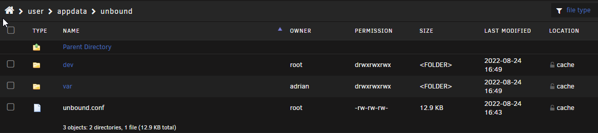

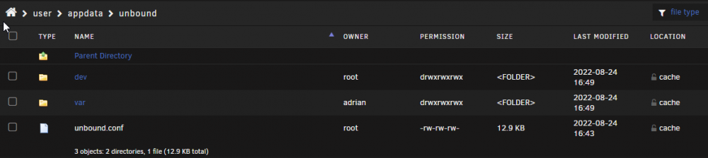

August 24, 20224 yr Has anyone figured out the permissions issues with the config folder? I have set permissions to RW-RW-RW and set the owner to 'root' for every folder including the parent and it still cannot access the files. Docker APP Config Permissions and ownership on parent folder Permissions and ownership on folder contents ********************** LOG FILE OUTPUT ********************************** [1661374194] libunbound[22:0] error: udp connect failed: Cannot assign requested address for 2001:500:a8::e port 53 [1661374194] libunbound[22:0] error: udp connect failed: Cannot assign requested address for 2001:500:a8::e port 53 [1661374194] libunbound[22:0] error: udp connect failed: Cannot assign requested address for 2001:500:12::d0d port 53 [1661374194] libunbound[22:0] error: udp connect failed: Cannot assign requested address for 2001:500:2::c port 53 [1661374194] libunbound[22:0] error: udp connect failed: Cannot assign requested address for 2001:500:2d::d port 53 [1661374194] libunbound[22:0] error: udp connect failed: Cannot assign requested address for 2001:500:2d::d port 53 [1661374195] libunbound[22:0] error: udp connect failed: Cannot assign requested address for 2001:500:1::53 port 53 [1661374195] libunbound[22:0] error: udp connect failed: Cannot assign requested address for 2001:503:c27::2:30 port 53 [1661374195] libunbound[22:0] error: udp connect failed: Cannot assign requested address for 2001:500:2d::d port 53 [1661374195] libunbound[22:0] error: udp connect failed: Cannot assign requested address for 2001:500:a8::e port 53 /opt/unbound/etc/unbound/unbound.conf:293: error: cannot open include file '/opt/unbound/etc/unbound/a-records.conf': No such file or directory /opt/unbound/etc/unbound/unbound.conf:294: error: cannot open include file '/opt/unbound/etc/unbound/srv-records.conf': No such file or directory /opt/unbound/etc/unbound/unbound.conf:300: error: cannot open include file '/opt/unbound/etc/unbound/forward-records.conf': No such file or directory read /opt/unbound/etc/unbound/unbound.conf failed: 3 errors in configuration file [1661374195] unbound[1:0] fatal error: Could not read config file: /opt/unbound/etc/unbound/unbound.conf. Maybe try unbound -dd, it stays on the commandline to see more errors, or unbound-checkconf ** Press ANY KEY to close this window ** Edited August 24, 20224 yr by aglyons
August 26, 20224 yr On 8/24/2022 at 2:52 PM, aglyons said: Has anyone figured out the permissions issues with the config folder? I have set permissions to RW-RW-RW and set the owner to 'root' for every folder including the parent and it still cannot access the files. Docker APP Config Permissions and ownership on parent folder Permissions and ownership on folder contents ********************** LOG FILE OUTPUT ********************************** [1661374194] libunbound[22:0] error: udp connect failed: Cannot assign requested address for 2001:500:a8::e port 53 [1661374194] libunbound[22:0] error: udp connect failed: Cannot assign requested address for 2001:500:a8::e port 53 [1661374194] libunbound[22:0] error: udp connect failed: Cannot assign requested address for 2001:500:12::d0d port 53 [1661374194] libunbound[22:0] error: udp connect failed: Cannot assign requested address for 2001:500:2::c port 53 [1661374194] libunbound[22:0] error: udp connect failed: Cannot assign requested address for 2001:500:2d::d port 53 [1661374194] libunbound[22:0] error: udp connect failed: Cannot assign requested address for 2001:500:2d::d port 53 [1661374195] libunbound[22:0] error: udp connect failed: Cannot assign requested address for 2001:500:1::53 port 53 [1661374195] libunbound[22:0] error: udp connect failed: Cannot assign requested address for 2001:503:c27::2:30 port 53 [1661374195] libunbound[22:0] error: udp connect failed: Cannot assign requested address for 2001:500:2d::d port 53 [1661374195] libunbound[22:0] error: udp connect failed: Cannot assign requested address for 2001:500:a8::e port 53 /opt/unbound/etc/unbound/unbound.conf:293: error: cannot open include file '/opt/unbound/etc/unbound/a-records.conf': No such file or directory /opt/unbound/etc/unbound/unbound.conf:294: error: cannot open include file '/opt/unbound/etc/unbound/srv-records.conf': No such file or directory /opt/unbound/etc/unbound/unbound.conf:300: error: cannot open include file '/opt/unbound/etc/unbound/forward-records.conf': No such file or directory read /opt/unbound/etc/unbound/unbound.conf failed: 3 errors in configuration file [1661374195] unbound[1:0] fatal error: Could not read config file: /opt/unbound/etc/unbound/unbound.conf. Maybe try unbound -dd, it stays on the commandline to see more errors, or unbound-checkconf ** Press ANY KEY to close this window ** I'm no expert. Trying to get mine working too. But, did you do this; "The container is looking for 3 files that are missing which are referenced in the default 'unbound.conf' file that was placed there. You can download/create the missing 'a-records.conf', 'forward-records.conf', and 'srv-records.conf' files. https://github.com/MatthewVance/unbound-docker/tree/master/1.10.1 The github repository (version 1.10.1 is the current version at the time of this writing) has the 3 files you need. Just go into each file and Right-Click the Raw button and Save As in order to download the 3 files. Copy them into the appdata/unbound folder and restart the container." Pay attention to the "right click in Raw" I chased my tail for a while before realizing I'd DL'ed the html version.

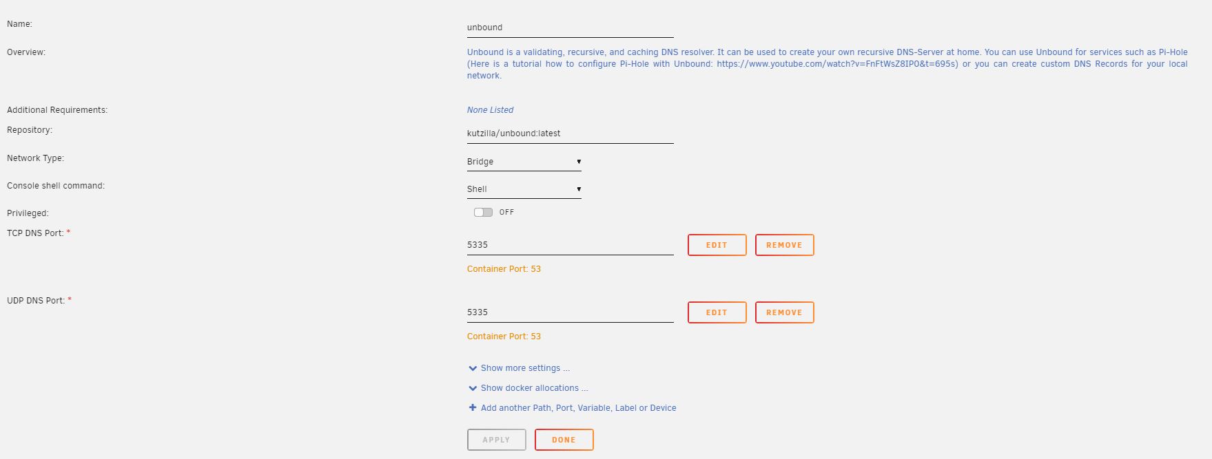

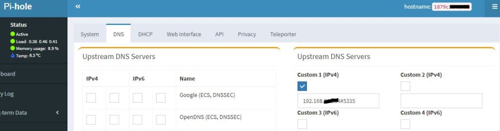

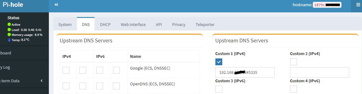

September 10, 20224 yr I have a rPi 4 and running pi-hole in a docker container - I used GitHub - geerlingguy/internet-pi: Raspberry Pi config for all things Internet to set it up. That part seemed to work fine and I just pointed the upstream to my existing zentyal host (which has firewall access to get out of the house). That works great. I can browse, dig, nslookup, etc. I read the guide (unbound - Pi-hole documentation) to setup unbound with the intention of retiring the zentyal host and when I setup as directed, everything times out. During the setup, I did succeed in running the dig tests and they worked find. As soon as I changed the upstream DNS via the pi-hole web interface, everything started timing out. I managed to troubleshoot a bit and did find that I had forgotten I only allowed the zentyal host out and replies to come back to his internally natted IP address. Adjusted my juniper firewall to allow the pi-hole as well and no longer see firewall deny messages in splunk. So I'm fairly confident that the request to whatever upstream is the default is going out and the return traffic should be coming back as well. When I look at the query log via the web UI, I see the entry "forwarded to localhost#5335" so I know that part is working but I never see an entry saying "OK (cached)" which I would expect if it gets a good answer. I searched the web and found other recent threads about unbound on pi-hole but they didn't help my issue. Time should be good as I have my own NTP source (another rPi with GPS connection (rPi Stratum-1 NTP Server) and it shows synched. If I set the upstream DNS to include my zentyal host (.172), then everything works great and I can see in the log that host is answering the queries. Here's the pi info and configs. pi@inet-pi:~$ lsb_release -d Description: Debian GNU/Linux 11 (bullseye) pi@inet-pi:~$ sudo apt policy openresolv openresolv: Installed: 3.12.0-1 Candidate: 3.12.0-1 Version table: *** 3.12.0-1 500 500 http://deb.debian.org/debian bullseye/main arm64 Packages 500 http://deb.debian.org/debian bullseye/main armhf Packages 100 /var/lib/dpkg/status pi@inet-pi:~$ ls -l /etc/unbound/unbound.conf.d/ total 8 -rw-r--r-- 1 root root 3048 Sep 7 16:12 pi-hole.conf -rw-r--r-- 1 root root 190 Feb 9 2021 root-auto-trust-anchor-file.conf pi@inet-pi:~$ cat /etc/resolvconf.conf # Configuration for resolvconf(8) # See resolvconf.conf(5) for details resolv_conf=/etc/resolv.conf # If you run a local name server, you should uncomment the below line and # configure your subscribers configuration files below. #name_servers=127.0.0.1 # Mirror the Debian package defaults for the below resolvers # so that resolvconf integrates seemlessly. dnsmasq_resolv=/var/run/dnsmasq/resolv.conf pdnsd_conf=/etc/pdnsd.conf #unbound_conf=/etc/unbound/unbound.conf.d/resolvconf_resolvers.conf pi@inet-pi:~$ cat /etc/resolv.conf # Generated by resolvconf search home-lan.net nameserver 10.20.15.176 nameserver fe80::cac7:50ff:fef3:2525%wlan0 pi@inet-pi:~$ sudo cat /etc/dhcpcd.conf # A sample configuration for dhcpcd. # See dhcpcd.conf(5) for details. # Allow users of this group to interact with dhcpcd via the control socket. #controlgroup wheel # Inform the DHCP server of our hostname for DDNS. hostname # Use the hardware address of the interface for the Client ID. clientid # or # Use the same DUID + IAID as set in DHCPv6 for DHCPv4 ClientID as per RFC4361. # Some non-RFC compliant DHCP servers do not reply with this set. # In this case, comment out duid and enable clientid above. #duid # Persist interface configuration when dhcpcd exits. persistent # Rapid commit support. # Safe to enable by default because it requires the equivalent option set # on the server to actually work. option rapid_commit # A list of options to request from the DHCP server. option domain_name_servers, domain_name, domain_search, host_name option classless_static_routes # Respect the network MTU. This is applied to DHCP routes. option interface_mtu # Most distributions have NTP support. #option ntp_servers # A ServerID is required by RFC2131. require dhcp_server_identifier # Generate SLAAC address using the Hardware Address of the interface #slaac hwaddr # OR generate Stable Private IPv6 Addresses based from the DUID slaac private # Example static IP configuration: interface eth0 static ip_address=10.20.15.176/24 static routers=10.20.15.254 static domain_name_servers=10.20.15.176 static search=home-lan.net static domain_search=home-lan.net # It is possible to fall back to a static IP if DHCP fails: # define static profile #profile static_eth0 #static ip_address=192.168.1.23/24 #static routers=192.168.1.1 #static domain_name_servers=192.168.1.1 # fallback to static profile on eth0 #interface eth0 #fallback static_eth0 I did turn on all of my tracelogging and flow debugging in my juniper and could see the outbound packets heading off to the internet port 53. I also see the firewall accept packet in splunk which is where I send my juniper syslogs to. So I'm pretty confident that it's something on the pi itself. So I turned off unbound as an upstream and checked the two google IPV4 boxes and it works. Further troubleshooting shows a query coming from my desktop to pi-hole looking for bolt.dropbox. That request then goes out to 8.8.8.8:53 (this is with the two google IPV4 checkboxes off and just 127.0.0.1#5335 turned on) and shortly I see the packet come back in. pi@inet-pi:~$ sudo tcpdump -nn port 5335 or port 53 07:14:48.699512 IP 10.20.15.132.49194 > 10.20.15.176.53: 59636+ A? bolt.dropbox.com. (34) 07:14:49.703916 IP 10.20.15.132.49194 > 10.20.15.176.53: 59636+ A? bolt.dropbox.com. (34) 07:14:51.707041 IP 10.20.15.132.49194 > 10.20.15.176.53: 59636+ A? bolt.dropbox.com. (34) 07:14:55.711211 IP 10.20.15.132.49194 > 10.20.15.176.53: 59636+ A? bolt.dropbox.com. (34) 07:15:02.643189 IP 10.20.15.176.38102 > 8.8.8.8.53: 61962+ PTR? 8.8.8.8.in-addr.arpa. (38) 07:15:02.659272 IP 8.8.8.8.53 > 10.20.15.176.38102: 61962 1/0/0 PTR dns.google. (62) 07:15:03.714237 IP 10.20.15.132.49194 > 10.20.15.176.53: 59636+ A? bolt.dropbox.com. (34) 07:15:16.671592 IP 10.20.15.176.59564 > 8.8.8.8.53: 59765+ PTR? 4.4.8.8.in-addr.arpa. (38) 07:15:16.688305 IP 8.8.8.8.53 > 10.20.15.176.59564: 59765 1/0/0 PTR dns.google. (62) I noticed that I never see the port 5335 packet even though it shows up in the pi-hole query log (can't post a screen shot of it). I am wondering if there should be an entry in the pi-hole's iptables to allow for the port 5335 traffic? Currently there is none just entries for port 53: pi@inet-pi:~$ sudo iptables --list --line-number --numeric Chain INPUT (policy ACCEPT) num target prot opt source destination Chain FORWARD (policy DROP) num target prot opt source destination 1 DOCKER-USER all -- 0.0.0.0/0 0.0.0.0/0 2 DOCKER-ISOLATION-STAGE-1 all -- 0.0.0.0/0 0.0.0.0/0 3 ACCEPT all -- 0.0.0.0/0 0.0.0.0/0 ctstate RELATED,ESTABLISHED 4 DOCKER all -- 0.0.0.0/0 0.0.0.0/0 5 ACCEPT all -- 0.0.0.0/0 0.0.0.0/0 6 ACCEPT all -- 0.0.0.0/0 0.0.0.0/0 7 ACCEPT all -- 0.0.0.0/0 0.0.0.0/0 ctstate RELATED,ESTABLISHED 8 DOCKER all -- 0.0.0.0/0 0.0.0.0/0 9 ACCEPT all -- 0.0.0.0/0 0.0.0.0/0 10 ACCEPT all -- 0.0.0.0/0 0.0.0.0/0 11 ACCEPT all -- 0.0.0.0/0 0.0.0.0/0 ctstate RELATED,ESTABLISHED 12 DOCKER all -- 0.0.0.0/0 0.0.0.0/0 13 ACCEPT all -- 0.0.0.0/0 0.0.0.0/0 14 ACCEPT all -- 0.0.0.0/0 0.0.0.0/0 15 ACCEPT all -- 0.0.0.0/0 0.0.0.0/0 ctstate RELATED,ESTABLISHED 16 DOCKER all -- 0.0.0.0/0 0.0.0.0/0 17 ACCEPT all -- 0.0.0.0/0 0.0.0.0/0 18 ACCEPT all -- 0.0.0.0/0 0.0.0.0/0 Chain OUTPUT (policy ACCEPT) num target prot opt source destination Chain DOCKER (4 references) num target prot opt source destination 1 ACCEPT tcp -- 0.0.0.0/0 172.18.0.2 tcp dpt:9100 2 ACCEPT tcp -- 0.0.0.0/0 172.21.0.2 tcp dpt:443 3 ACCEPT tcp -- 0.0.0.0/0 172.18.0.3 tcp dpt:9115 4 ACCEPT tcp -- 0.0.0.0/0 172.21.0.2 tcp dpt:80 5 ACCEPT udp -- 0.0.0.0/0 172.21.0.2 udp dpt:67 6 ACCEPT tcp -- 0.0.0.0/0 172.18.0.5 tcp dpt:9090 7 ACCEPT tcp -- 0.0.0.0/0 172.21.0.2 tcp dpt:53 8 ACCEPT tcp -- 0.0.0.0/0 172.18.0.6 tcp dpt:9798 9 ACCEPT udp -- 0.0.0.0/0 172.21.0.2 udp dpt:53 10 ACCEPT tcp -- 0.0.0.0/0 172.18.0.4 tcp dpt:3000 Chain DOCKER-ISOLATION-STAGE-1 (1 references) num target prot opt source destination 1 DOCKER-ISOLATION-STAGE-2 all -- 0.0.0.0/0 0.0.0.0/0 2 DOCKER-ISOLATION-STAGE-2 all -- 0.0.0.0/0 0.0.0.0/0 3 DOCKER-ISOLATION-STAGE-2 all -- 0.0.0.0/0 0.0.0.0/0 4 DOCKER-ISOLATION-STAGE-2 all -- 0.0.0.0/0 0.0.0.0/0 5 RETURN all -- 0.0.0.0/0 0.0.0.0/0 Chain DOCKER-ISOLATION-STAGE-2 (4 references) num target prot opt source destination 1 DROP all -- 0.0.0.0/0 0.0.0.0/0 2 DROP all -- 0.0.0.0/0 0.0.0.0/0 3 DROP all -- 0.0.0.0/0 0.0.0.0/0 4 DROP all -- 0.0.0.0/0 0.0.0.0/0 5 RETURN all -- 0.0.0.0/0 0.0.0.0/0 Chain DOCKER-USER (1 references) num target prot opt source destination 1 RETURN all -- 0.0.0.0/0 0.0.0.0/0 The other odd thing is that if I manually lookup something via dig pointing to unbound, it works! pi@inet-pi:~$ dig @127.0.0.1 -p5335 www.google.com ; <<>> DiG 9.16.27-Debian <<>> @127.0.0.1 -p5335 www.google.com ; (1 server found) ;; global options: +cmd ;; Got answer: ;; ->>HEADER<<- opcode: QUERY, status: NOERROR, id: 50429 ;; flags: qr rd ra; QUERY: 1, ANSWER: 1, AUTHORITY: 0, ADDITIONAL: 1 ;; OPT PSEUDOSECTION: ; EDNS: version: 0, flags:; udp: 1232 ;; QUESTION SECTION: ;www.google.com. IN A ;; ANSWER SECTION: www.google.com. 300 IN A 142.250.73.228 ;; Query time: 39 msec ;; SERVER: 127.0.0.1#5335(127.0.0.1) ;; WHEN: Sat Sep 10 07:48:20 EDT 2022 ;; MSG SIZE rcvd: 59 So I'm still confused but convinced it's something on the pi and not in my network. Any help pointing me in another direction to look would be appreciated. Edited September 11, 20224 yr by ShosMeister A couple of typos
January 16, 20233 yr You should probably check the unbound.conf in the appdata/unbound folder and check there the listening ports. Adjust them to your docker config accordingly.

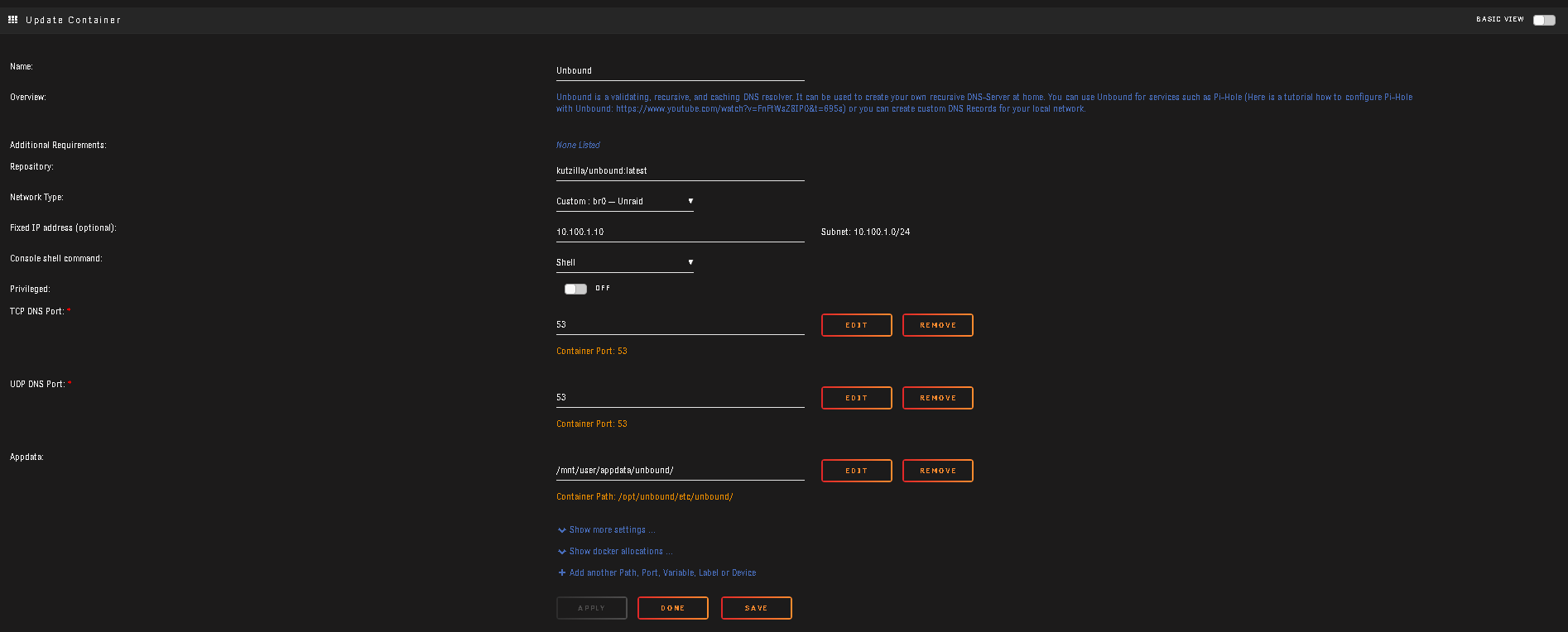

April 12, 20233 yr Has anyone been able to get Unbound to work on 6.11.5 using the auto-trust-anchor-file: "/opt/unbound/etc/unbound/root.key" file? I have the file in the unbound directory, but no matter what permutation I use for the anchor file or chroot (including chroot: "") I'm not able to get it to start (without the root.key file it works fine). ChatGPT can't even figure it out! I saw an old Reddit post about adding in 'username: "_unbound" into the unbound.conf but not even that is working. # unbound-anchor -a /opt/unbound/etc/unbound/root.key [1681261500] libunbound[80:0] error: failed to read /opt/unbound/etc/unbound/root.key [1681261500] libunbound[80:0] error: error reading auto-trust-anchor-file: /opt/unbound/etc/unbound/root.key [1681261500] libunbound[80:0] error: validator: error in trustanchors config [1681261500] libunbound[80:0] error: validator: could not apply configuration settings. [1681261500] libunbound[80:0] error: module init for module validator failed
June 17, 20233 yr Anyone know or manage to resolves the following warning and error? [1687011499] unbound[1:0] warning: setrlimit: Operation not permitted [1687011499] unbound[1:0] warning: cannot increase max open fds from 40960 to 57568 [1687011499] unbound[1:0] warning: continuing with less udp ports: 5820 [1687011499] unbound[1:0] warning: increase ulimit or decrease threads, ports in config to remove this warning [1687011499] unbound[1:0] error: Could not open logfile /dev/null: Permission denied

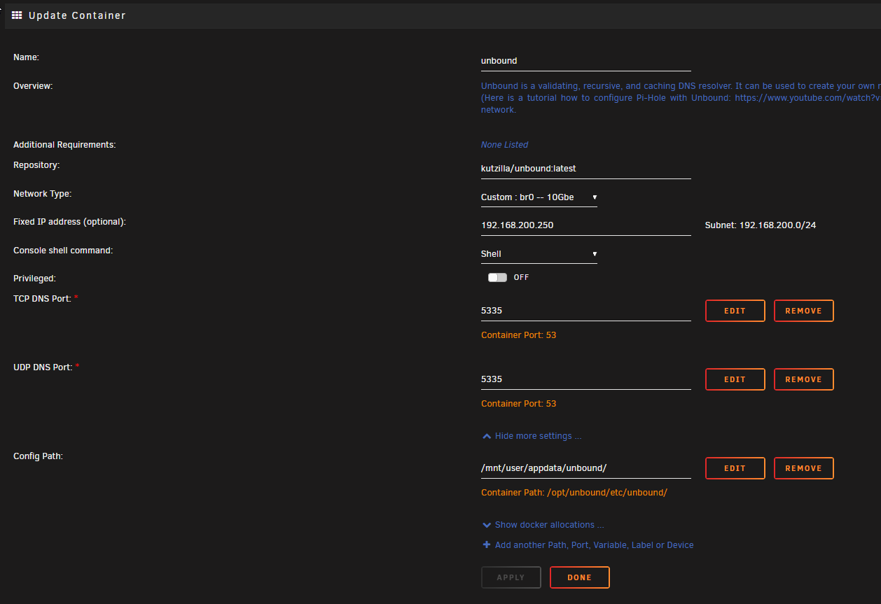

February 12, 20251 yr On 3/23/2022 at 4:04 PM, boomam said: Is it possible to get the repo/image updated to the latest release please? @kutzilla Has this container been abandoned? If not, would it possible to update it semi-annually (or at minimum, annually)? The latest release of unbound at the time of this comment is 1.22. Based on the log output, it looks like this container is running Unbound version 1.13.1 which was released Feb 9, 2021 which is now over 4 years old. [1738914858] unbound[1:0] info: start of service (unbound 1.13.1). Last year there were only 7 releases so bi-annual updates would likely be enough to keep this container within 3-4 releases of current.
February 12, 20251 yr On 9/5/2024 at 9:02 AM, Kira said: Anyone got any recommendation for a new Unbound docker as I think this is no longer being updated? also how do you do this "As for "error: Could not open logfile /dev/null: Permission denied", I've sorted this by creating the "unbound.log" inside the chroot directory, which is the mapped appdata directory that I mapped the unbound docker to." ? not sure what is the steps to do "creating the "unbound.log" inside the chroot directory" . I took a look at the github repo corresponding to this docker image. It is a fork of a well-maintained image that receives regular updates from mvance. You can switch this template to use that image instead of the out-of-date / abandoned one by replacing the "Repository" field with: "mvance/unbound:latest" If you compare the other fields in the Unraid template to the fields mentioned in the instructions for setting up mvance's docker image on Unraid contained in this reddit post they match up exactly so it's no surprise that the template is compatible with mvance's image. Furthermore, if you look at the diff between the downstream image and the upstream image, only the README has been changed and only to update links to point to the forked repo rather than the parent repo. I have submitted a pull request to update the repository reference in the container template to point to the regularly maintained image. Hopefully @kutzilla will merge it so that users of this template are able to receive regular updates without his ongoing involvement. If he is MIA, the other option would be to publish a new Unbound template which points to the mvance Repository and formally deprecate & abandon this one.
February 20, 20251 yr On 2/12/2025 at 8:54 AM, pants said: I took a look at the github repo corresponding to this docker image. It is a fork of a well-maintained image that receives regular updates from mvance. You can switch this template to use that image instead of the out-of-date / abandoned one by replacing the "Repository" field with: "mvance/unbound:latest" If you compare the other fields in the Unraid template to the fields mentioned in the instructions for setting up mvance's docker image on Unraid contained in this reddit post they match up exactly so it's no surprise that the template is compatible with mvance's image. Furthermore, if you look at the diff between the downstream image and the upstream image, only the README has been changed and only to update links to point to the forked repo rather than the parent repo. I have submitted a pull request to update the repository reference in the container template to point to the regularly maintained image. Hopefully @kutzilla will merge it so that users of this template are able to receive regular updates without his ongoing involvement. If he is MIA, the other option would be to publish a new Unbound template which points to the mvance Repository and formally deprecate & abandon this one. That worked for me, though I wasn't having any issues, yet.
March 31, 20251 yr [1687011499] unbound[1:0] warning: setrlimit: Operation not permitted [1687011499] unbound[1:0] warning: cannot increase max open fds from 40960 to 57568 [1687011499] unbound[1:0] warning: continuing with less udp ports: 5820 [1687011499] unbound[1:0] warning: increase ulimit or decrease threads, ports in config to remove this warning For anyone who would like to solve the above error, the main issue is actually "setrlimit: Operation not permitted" all you need to do on the docker is enable privileged and all warning resolve
July 29, 20251 yr On 3/31/2025 at 4:22 AM, Kira said:[1687011499] unbound[1:0] warning: setrlimit: Operation not permitted[1687011499] unbound[1:0] warning: cannot increase max open fds from 40960 to 57568[1687011499] unbound[1:0] warning: continuing with less udp ports: 5820[1687011499] unbound[1:0] warning: increase ulimit or decrease threads, ports in config to remove this warning For anyone who would like to solve the above error, the main issue is actually "setrlimit: Operation not permitted" all you need to do on the docker is enable privileged and all warning resolveI fixed the same issue by adding --ulimit nofile=65536:65536 to Extra Parameters which is way safer. Edited July 29, 20251 yr by Thedinotamer
