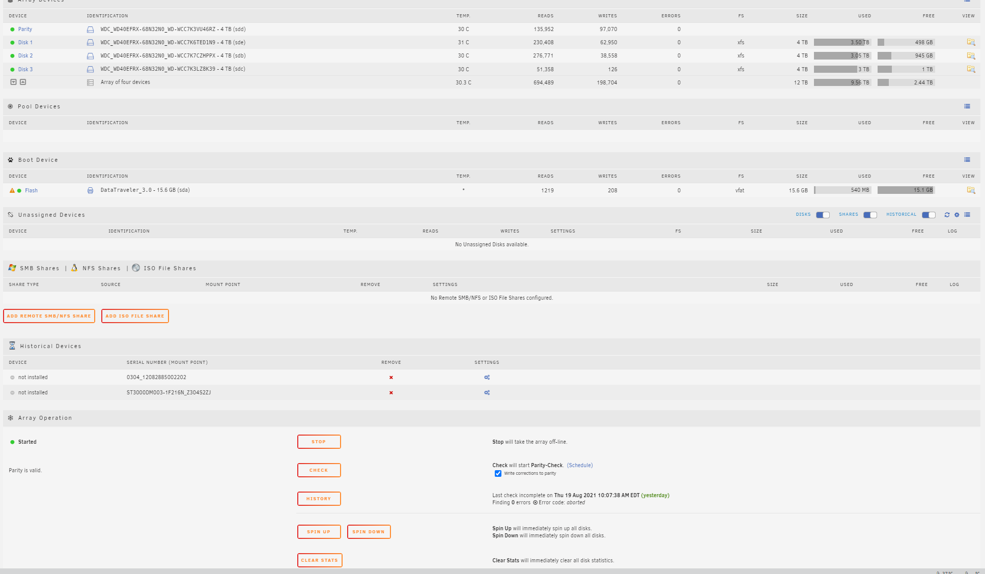

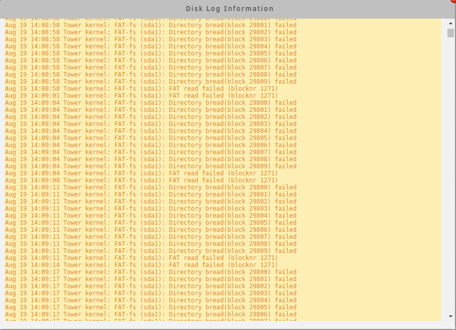

it would seem that after a short power out with the UPS kicking in I get a flash device error.
i scanned it with windows and no errors are on the disk not sure what wrong.
do i have a Fatal flash drive error when i open app page on the server.
please help.
Not quite sure what you have done?    Are you saying you can no longer boot from the flash drive?  What you said implies you might have removed the flash drive while UnRaid was running?   You cannot do this without upsetting UnRaid - the flash drive must be plugged in all the time Unraid is running.
Unless the USB port you're plugged into lost power (highly unlikely) during the power cut, it wasn't related.  You probably only noticed it when going to the Apps tab.  Use a different port, ideally USB2.  And as itimpi stated, you cannot pull the flash drive out without first shutting down the server
no i had a power outage and ups kicked in and no flash drive is not recognized
seems like my usb is failed?
what would you recommend to get my back up and running

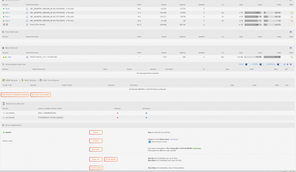

 USB is not even recognized on my main comp
Do you have a backup of the flash drive?     Can you see it’s contents when plugged into Windows?

The registered GUID does not match the USB Flash boot device GUID
Your license only works with the original flash drive it was registered to. You have to transfer the license.

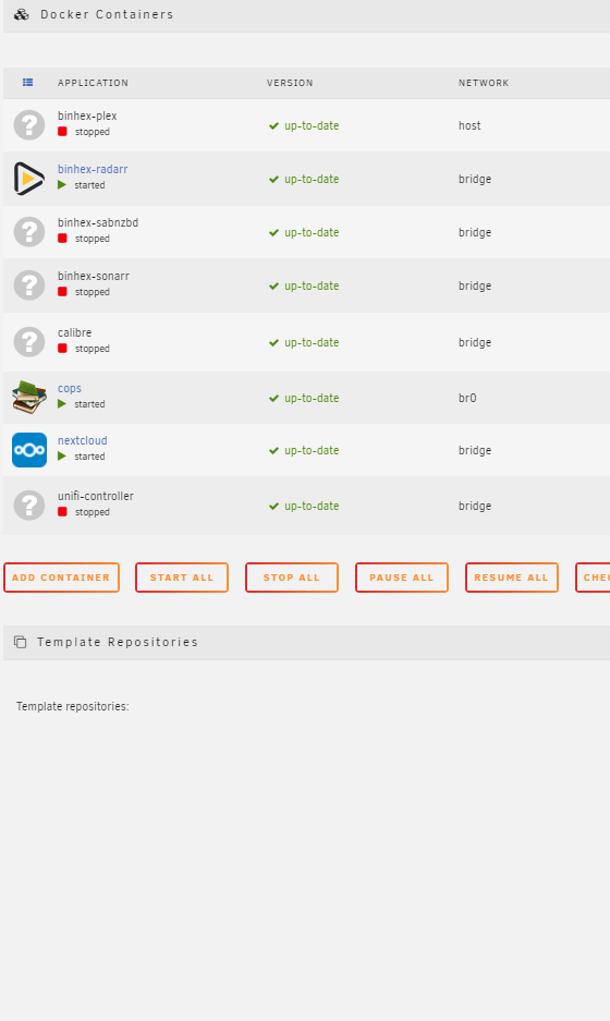

now i have a problem that my dockers are not all working i stopped the ones that do not work.
i cant edit them or lunch the WEBUI
