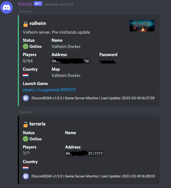

The problem with the Valheim server turned out to be a combination of a wrongly placed "," and no write permissions in Discord.

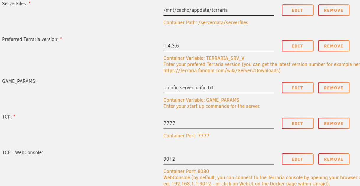

The Terraria server has the game port (7777) forwarded with both the TCP and UDP protocols. This is what I can see in the Terraria config;
How can I see what the correct query type and port is? I tried setting the server.json to use the sourcequery, but that did not help.

so if you port forward the UDP port on your router be sure that the port is getting forwarded to your container aswell.
looks like in the picture that its only forwarding TCP if you trust the description

I went on the Discord community of that bot and they told me that the bot will only display server information if the game supports a few different query types. Turnes out that Terraria (and Satisfactory and Wreckfest) are just not supported.
They said that I can change the query type to "fake" in the servers.json and that managed to sort of fix it;
The downside of the "fake" query is that the online/offline status are not always up to date and it can't display much more than that. But this is enough for me.
Guess that the bot itself is rather limited in what servers it supports. Sure, Gamedigquery has a long list of supported servers, but there are plenty more that are not supported (yet)

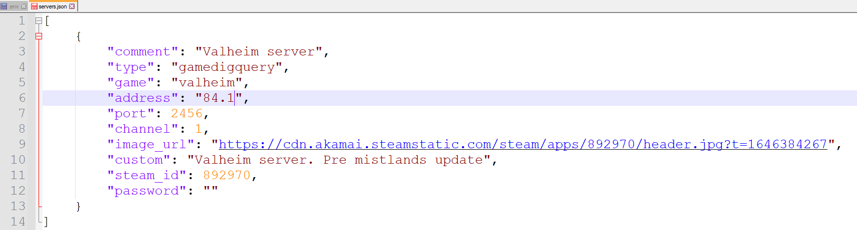

Hey, your servers.json has wrong entities
don’t just use the example file, delete those rows you don’t need or don’t use. Then it will work fine
if you can’t find the error you can post your file here and I will take a look at it
I get the hang on it, you are absolutly right, thank you for confirming my thoughts. i had to many not working rows for Valheim, now it works just fine. A fun and nice Docker, we dont need to Pin any server datas like Morons anymore. We are Bot upper Class citiziens now.

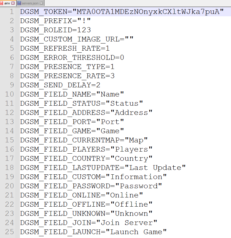

I did all the steps needed, and the bot is connected to my server. But when I start the container in Unraid, I get this error:
I do not know how to debug this. Could you help me figure this out?

I did take another look at the config files, but can't find any problem. I made sure to look at any comma's as well, and that the tokens were correct.
Here are screenshots of the config files (with sensitive information deleted from them)
i hope this is not your actually discord token. if so, change it immediately.
i tested the classic versions. i think your discord bot id could be incorret. not sure
It is part of the full bot token. The full token is much longer. I just removed the middle part for the screenshot.
I have created new tokens multiple times and copied them into the .env file. I still get the error. I have removed the bot, and all files from my Unraid server, then installed the classic container again, did all the installation steps again, and started the bot. No error, and it told me that it created the .enf and configuration files. I only added the bot token to the .env file, and started it again, but got the padding error again.
I don't know where to look, since the bot token is the same in the file and in the Discord development console.
Could this be because I updated my system to Unraid 6.11.2 a while back, and then downgraded back to 6.9?
i dont think so that this is the reason.
the error message says that there is a format issue with (probably) your token.

Would it be possible for me to send you the .env file with full token so you can see if there is a problem in there? As long as I immediately change the actual token in the Discord development console, it should be safe right? That way you have the token I am trying now, but not the new one.
Edited by workermaster
i dont think that this would make a difference. you could try creating a completly new bot and with a new token.
I have tried making a new bot and new token a couple of times, but still get the same error. I've attached the unedited .env file here (and changed the bot token after sharing so nobody can abuse it) .env
The new gameserver monitor that you made does work (at least a few days ago when I tried it), but I was missing a few options for adding text, that's why I wanted to try the classic version again.
i really dont know whats the issue, i do not develop this programm. i made no changes to this image since at least 7 month. so i am not really sure.
