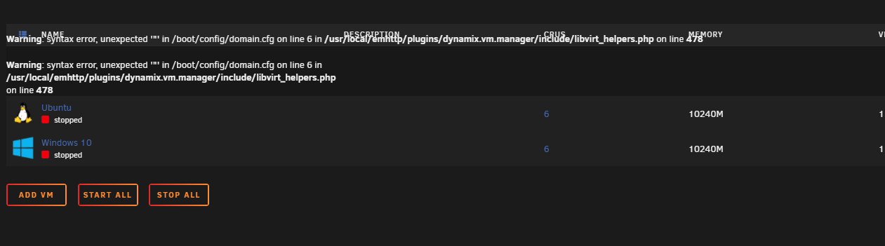

    I have been wrapping my brain around trying to install my unraid server on a new USB drive. This all started when I received an error on my unraid dashboard (first image). After some research I concluded that the flash drive was faulty. I purchased a Samsung BAR Plus after watching some reviews on which USB to use.

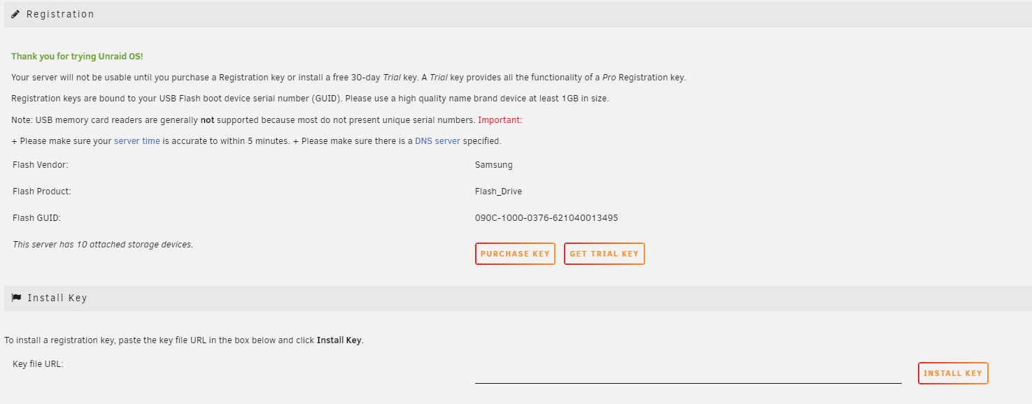

5. Use the Unraid Flash Creator with a fresh Stable release. This loads correctly but gives me a 169 ipv4 address. ifconfig shows the correct 192 address under br0 and I am able to access the UI. However, I cannot successful get my pro.key to install. There is only a Purchase and Trial buttons.
    I am extremely afraid I just lost all my data if I have to start with a new Unraid OS. The data is on the HDDs, but the array is no longer available with the USB drive issues I am having. I have no idea how or where to pull the systemlogs from the CLI and I see no logs file on the flash drive.

I see the network working. Maybe its my network settings? I can post those if requested. Also, help replacing my key would be appreciated. Do I need to reach out to Unraid support to get a link? There is no replace key button.
Edited by ItsRaining
Have you put your old .key file into the 'config' folder?  This is needed to initiate the licence transfer process.
Thank you for the information to get the registration key to work. I cannot believe I missed such a simple step. I successfully registered my new USB. Using a new install of Unraid seems to have broken all my dockers and VMs but I will gladly remake them. All my data is still available and that is what I care about most. I still am not sure if I have resolved the GUI issue when I restart. I am running a parity check and once finished I will try restarting the server. Hopefully the ipv4 registers.
