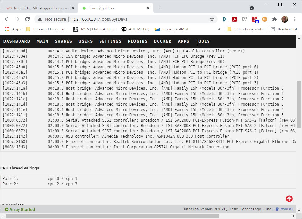

I have tried four different cards in the two PCIe x1 slots.  Looking at the System Devices tab in unRAID it shows the Intel NIC as shown below.
If I go into the UEFI BIOS and disable the onboard Realtek controller it won't connect or show any activity lights on the Intel controller with the ethernet cable attached.  I get an error message at the very end of the boot screen saying it can't find eth0.  I was looking at the network-rules.cfg file and it shows the following info:
