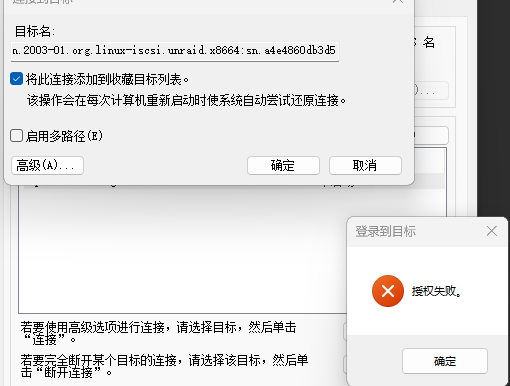

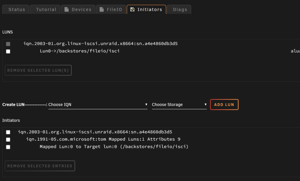

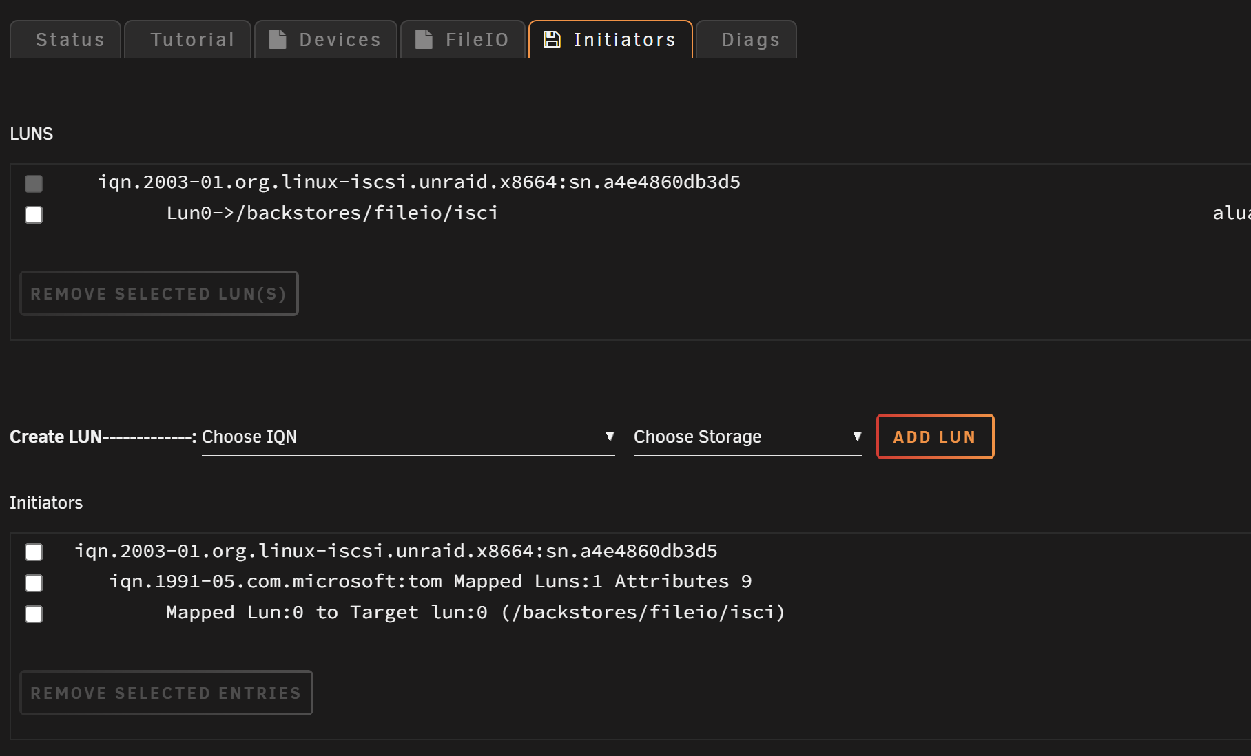

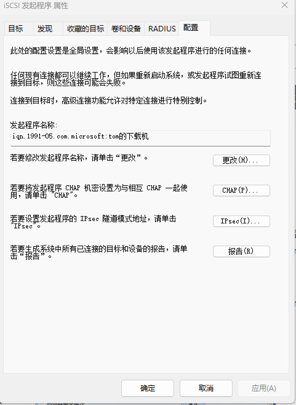

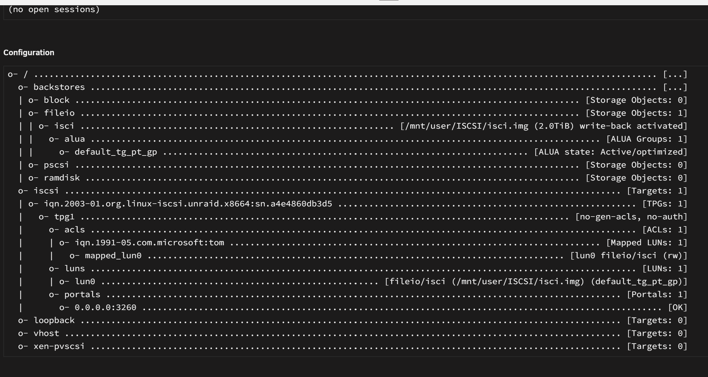

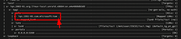

Hello, I just tried to mount iscsi on window11 but I'm having some problems, when I mount it I get an authorization failure message, I've compared the correct settings but I can't find the problem.

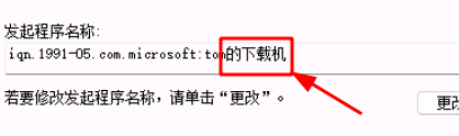

Could this be the issue:
The name doesn't match.

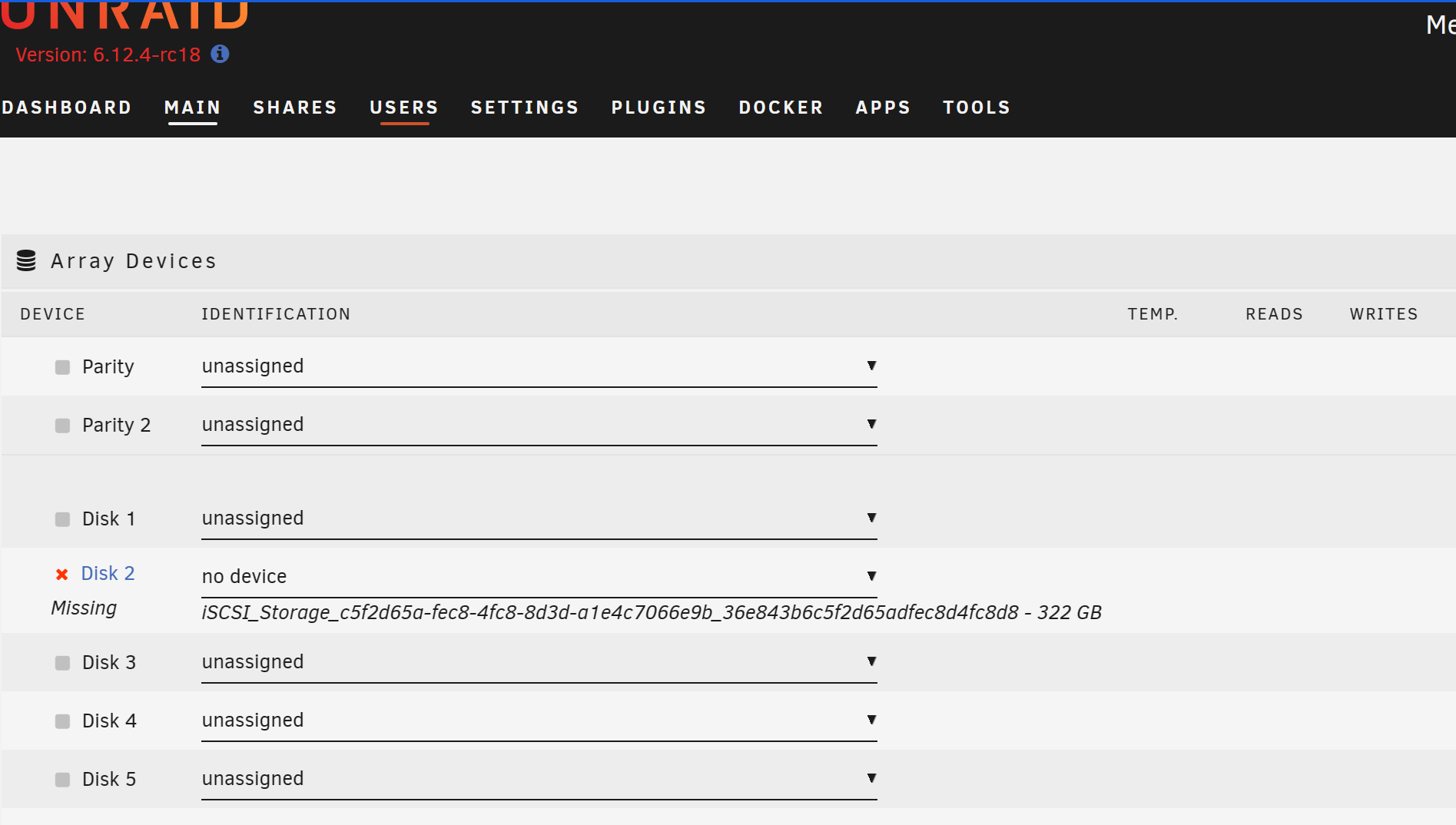

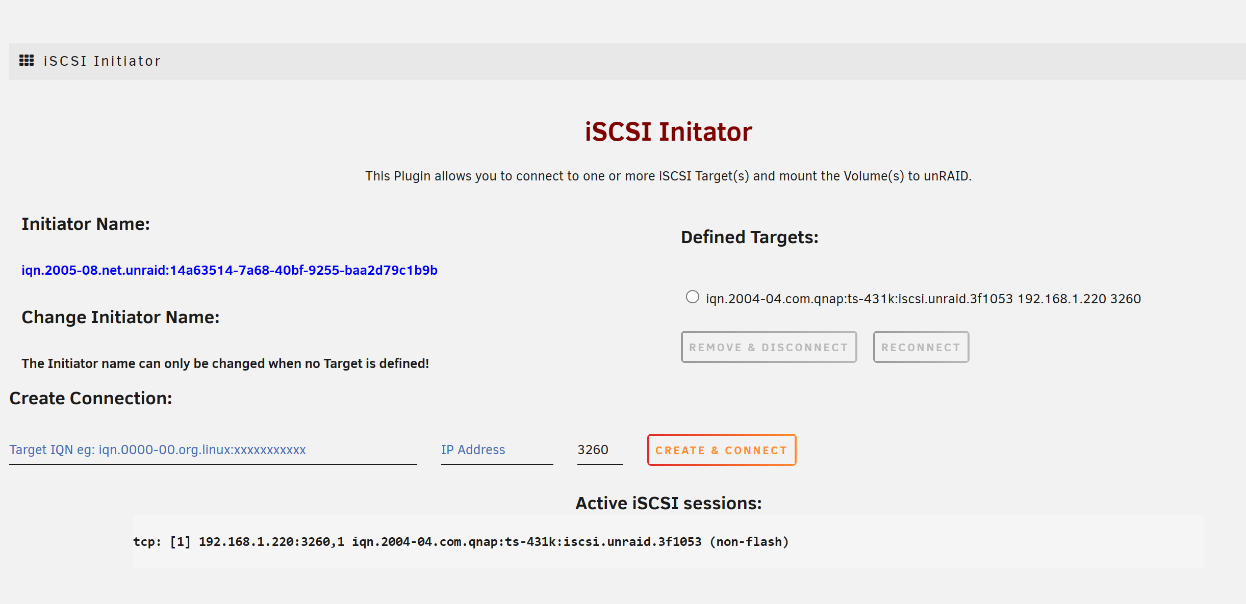

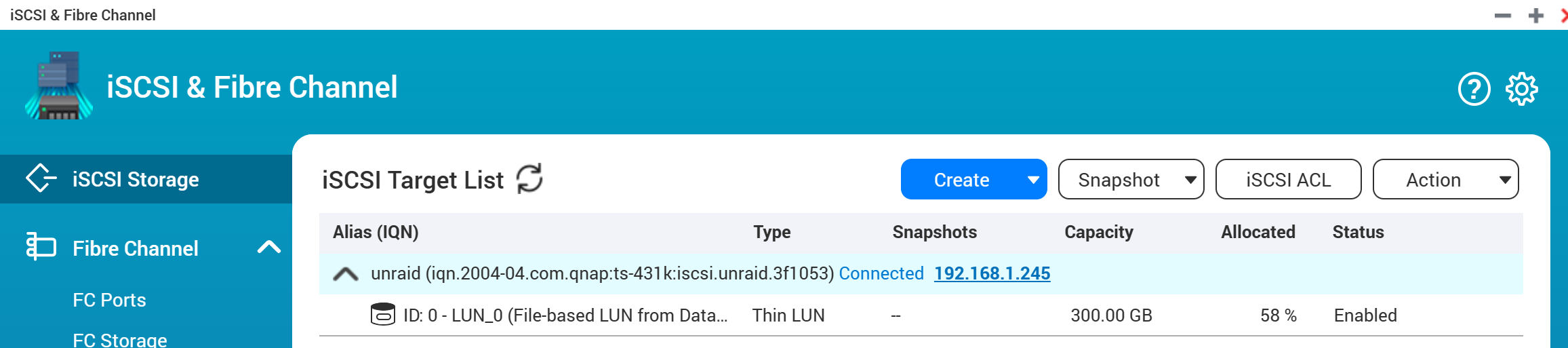

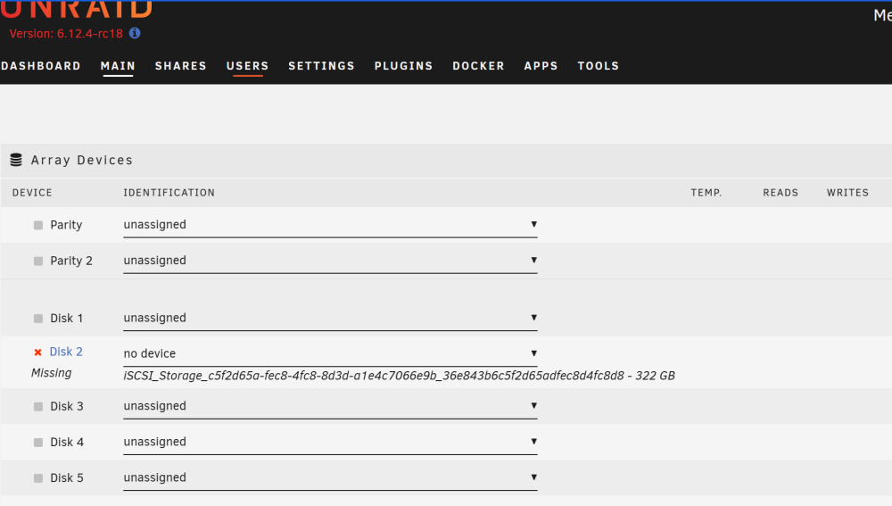

I was successfully using this in the past, few months ago I turned off my Unraid and now it doesnt want to reconnect the LUN. Though the iSCSI session seems to be active
Also the target (QNAP) shows the initiator is connected:
What could be the problem?
What did you do exactly? Did you upgrade to a newer Unraid version?
Do no devices appear in Unraid itself?
So I booted it up and it was not appearing then I did upgrade (both Unraid and the plug-in) in hope that it will resolve the problem. But at the end it didn’t, the LUN doesn’t appear under array at all. The weird thing is that I cannot even see the block device in dmesg

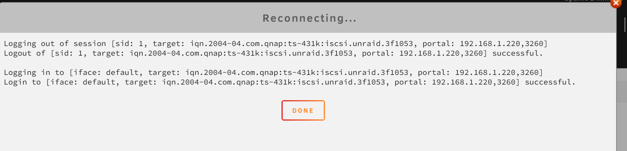

What happens when you select your target and click reconnect?
Nothing

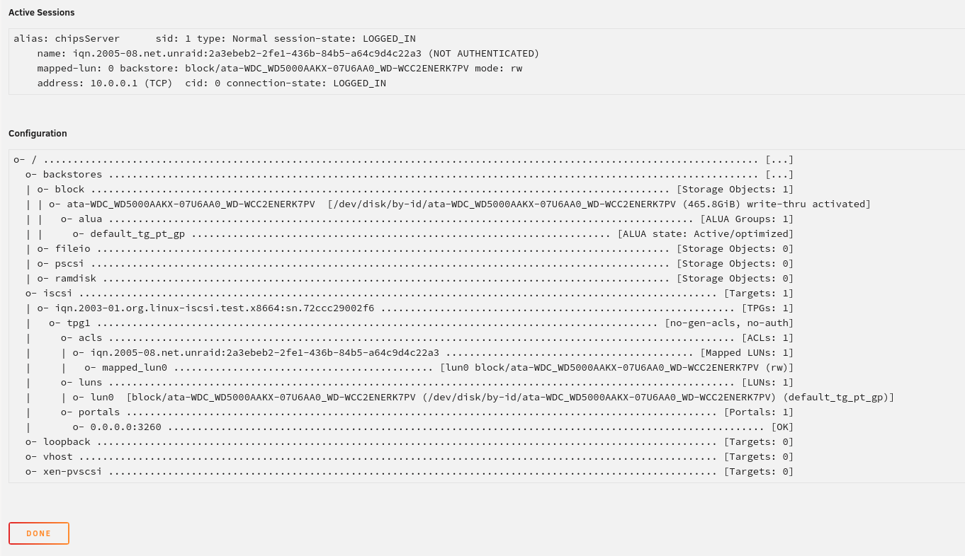

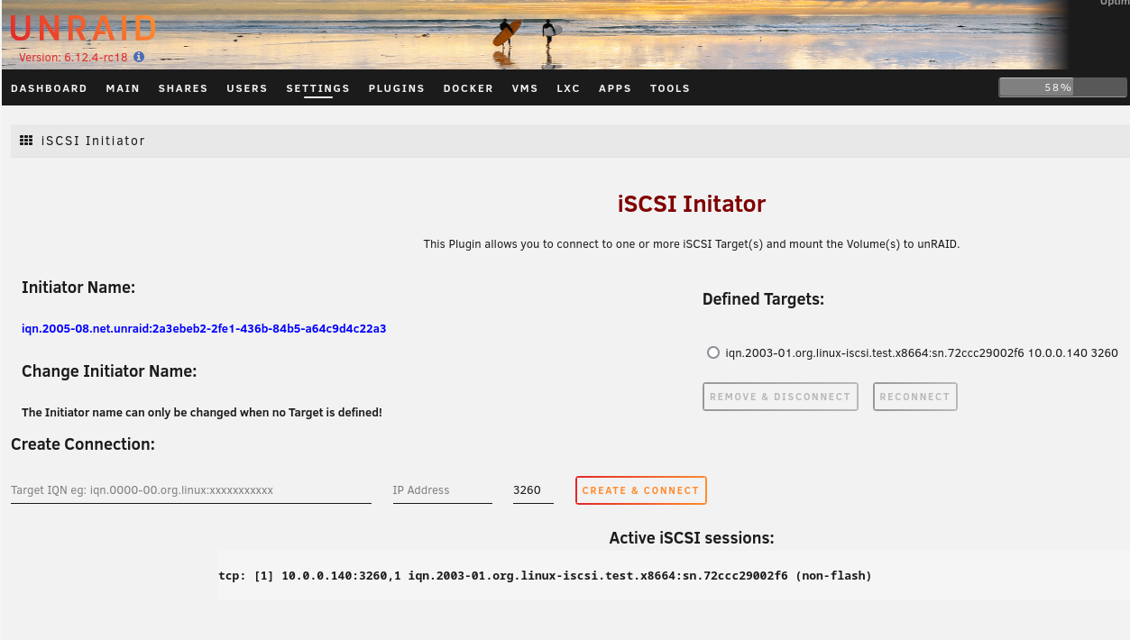

@rezo I've now tried it and I can see the block device on the Initiator side:
I'm also on rc18 to compare apples to apples (also the Initiator side):
And this is on the Target side:
There must have changes something on the QNAP side, maybe try to recreate the Target and also everything on the Initiator side.
Indeed, I created a brand new LUN and Im able to attach.... Shit, I need to do a recovery somehow, crappy QNAP
