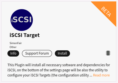

You need the iSCSI Target from the CA App, the iSCSI Initiator is for mounting a iSCSI Target to Unraid.
You need this:
I have already installed this application.
But you are in the wrong support thread, this is the right one:

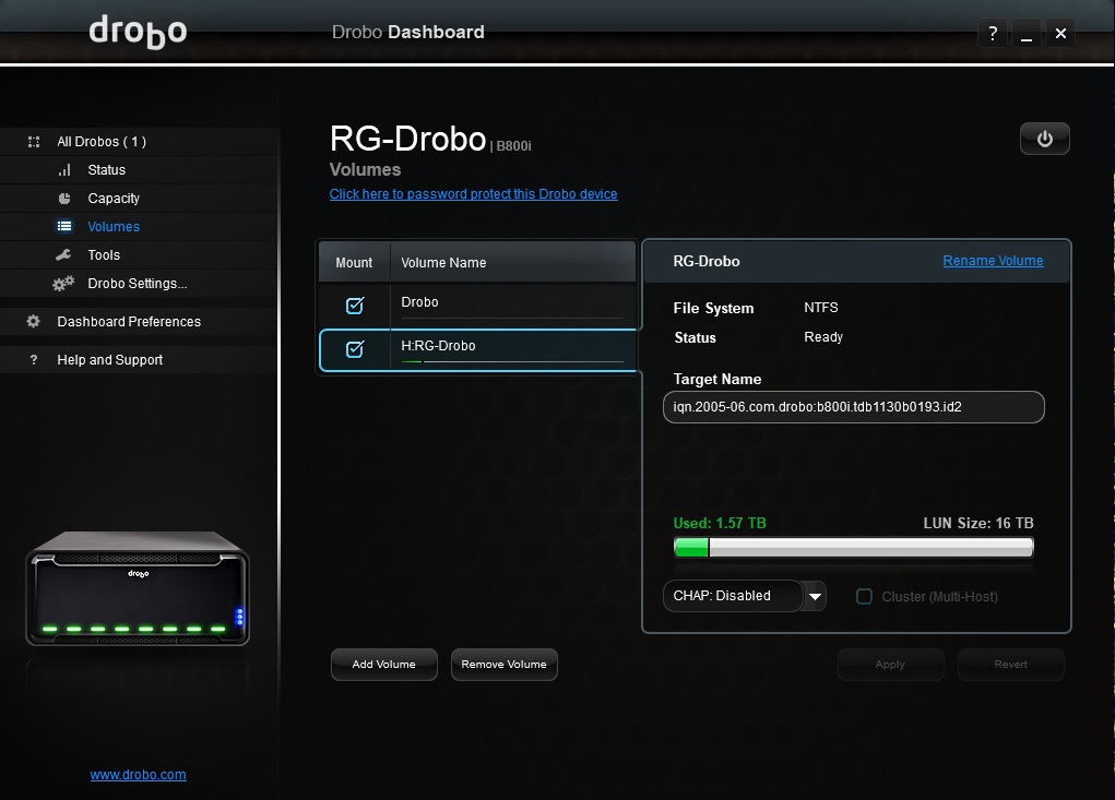

Did you add the IQN from the Initiator to the ACL from the Dobro Target?
There is no ACL on the Drobo target that I can find...

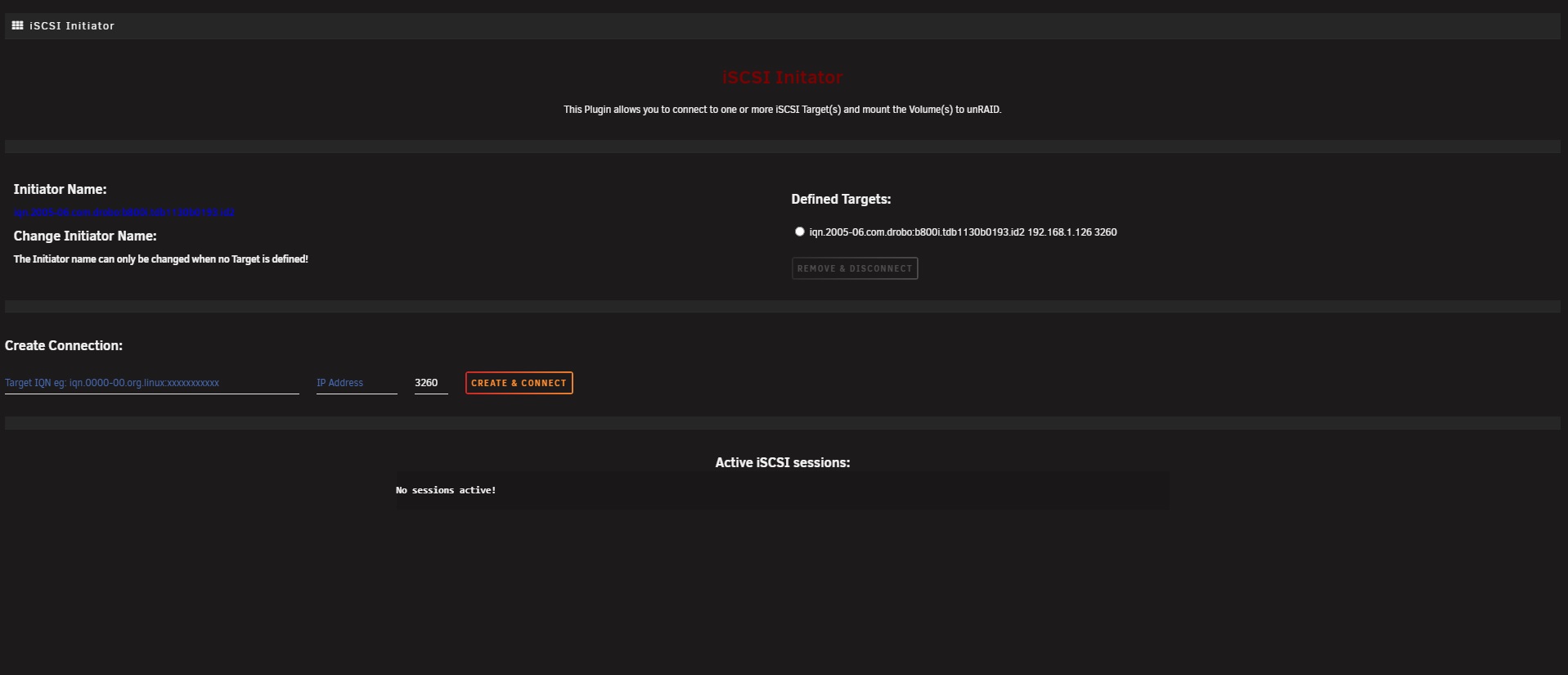

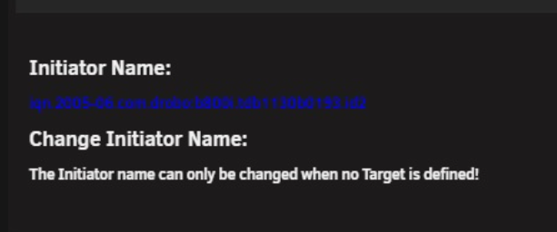

It looks like you have set the unraid IQN to the same name as the drobo
Edited by SimonF
You are completely right Simon! Didn't even see that, that blue text is really hard to read on a black background or it's just the compression, my monitor or most likely my eyes... :D
Yes I didn't see it at first was looking at user guides etc and the target.

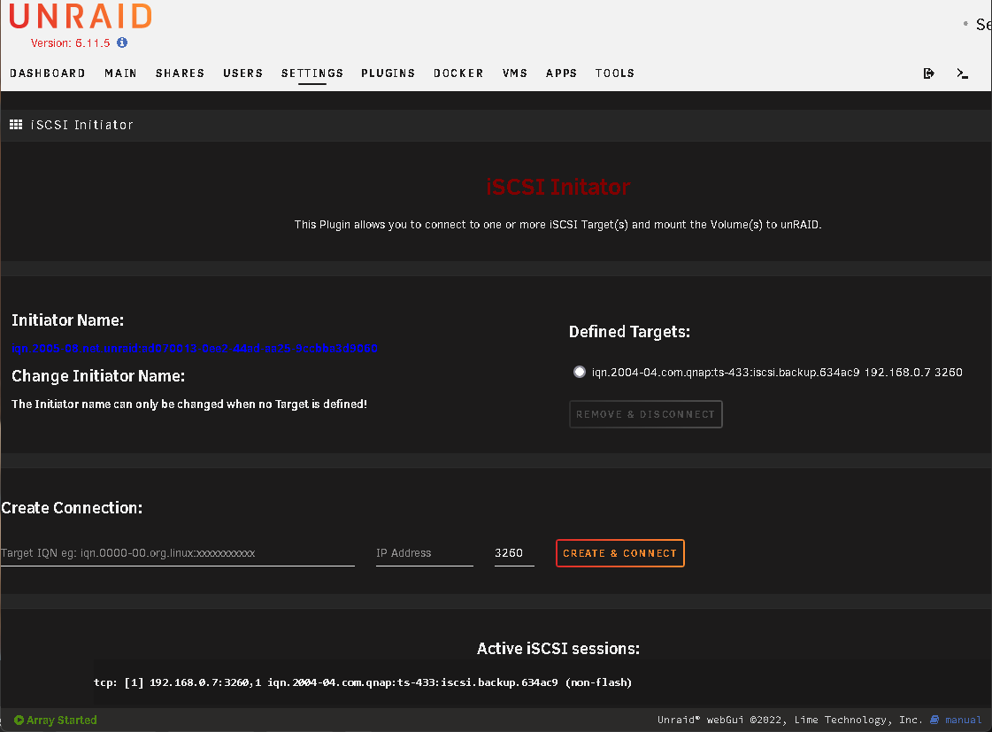

I installed the plugin and connected to the iSCSI connection on my NAS, I can see in the plugin and on my NAS that the connection is established, but I do not see the volume in the Main tab in Unraid. I rebooted the server, still nothing. Running Unraid v.6.11.5, plugin v.2022.09.27. Please help.
Please share your Diagnostics and a screenshot from the iSCSI Initiator plugin page.
