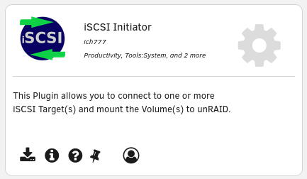

[Plugin] iSCSI Initiator
iSCSI Initiator
This plugin allows you to connect to iSCSI Target(s) and mount the Volume(s) to unRAID.
Installation of the Plugin:
  1. Go to the Community Applications App and search for 'iSCSI Initiator' and click on the Download button (you have to be at least on Unraid 6.9.2 to see the plugin in the CA App) :
    Or download it directly from here:
    https://raw.githubusercontent.com/ich777/iscsi-initiator/master/iscsi-initiator.plg
  2. Go to the plugin page to get your Initiator IQN, you can also change it if needed (a random one is created at plugin installation):
    (Please note that changing the Initiator IQN is only possible when no Target exists)
  3. On your Target set up the Volume(s) that you want to use on unRAID and assign it the Initiator IQN from Step 2.
  4. Back on unRAID enter the Target IQN, the IP and the Port from the Target and click "Create & Connect":
  5. If everything went correctly you should see at the bottom from the plugin page at the section "Active iSCSI sessions" that the connection is established and working:
  6. Go back to the "Main" tab from unRAID and you will see that the Volume is now mounted to unRAID.
  7. Now you can use the Volume as if it is a device that is physically attached to unRAID.
If you experience any problems (eg: "Active iSCSI session" showing: grafik.png.437f1d511e3c73e8f63bc96fd8385f95.png) when creating the connection click on this grafik.png.828775d2773424b515915c29ed72e7c0.png button on the top right corner to open up the syslog and create a post with the error from iscsid here, but first please make sure that you've entered the right Target IQN, IP and Port.
You can delete wrong/non-working/unwanted entries here by simply selecting the target and click "Remove & Disconnect":
ATTENTION:
It's not recommend to add Volumes, which are mounted through this plugin, to your Array or Cache Pool(s) because if the Target is not reachable or went offline when unRAID is running really bad things can happen.

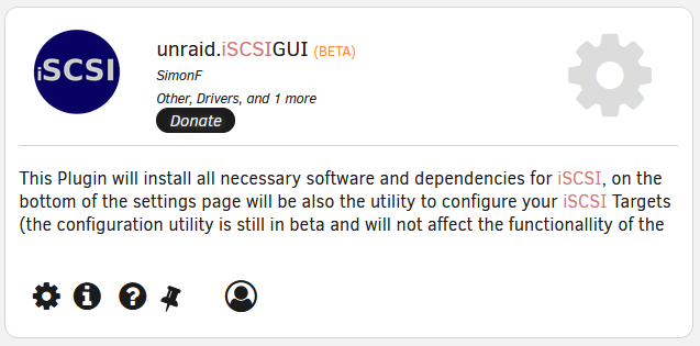

This looks really awesome! I'm excited to use it. Does this plugin also allow to use Unraid as a iscsi target from another device running windows?
This plugin allows you to mount Volumes from targets, the above shown plugin makes unRAID a Target and let other devices mount the Volumes.
No, but there is actually another plugin that allows you to do that (simply search for "iSCSI" and you will find both plugins):

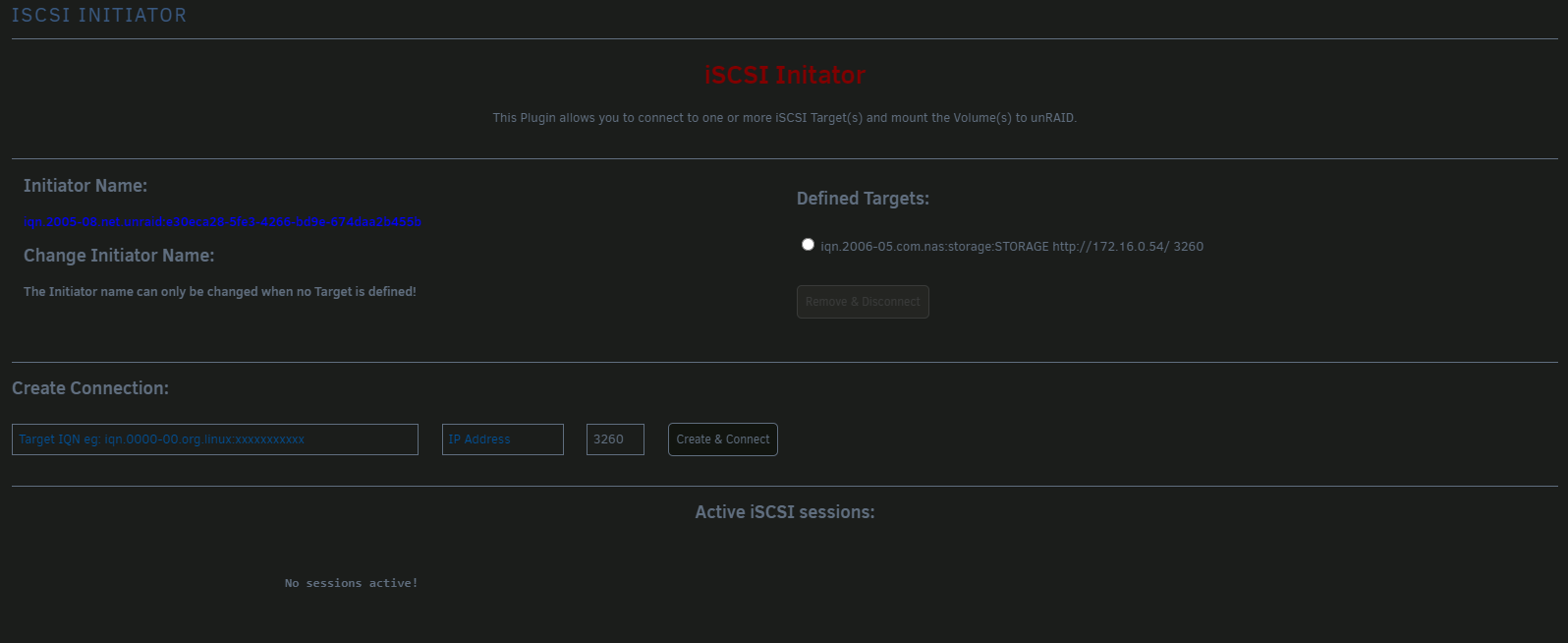

Hello! I'm experiencing the "no active sessions", but there are no errors:
Oct 3 11:43:12 REPOSITORY emhttpd: cmd: /usr/local/emhttp/plugins/community.applications/scripts/pluginInstall.php install https://raw.githubusercontent.com/ich777/iscsi-initiator/master/iscsi-initiator.plg
Oct 3 11:43:12 REPOSITORY root: plugin: running: anonymous
Oct 3 11:43:12 REPOSITORY root: plugin: creating: /boot/config/plugins/iscsi-initiator/iscsi.initiator-2021.09.17.txz - downloading from URL https://raw.githubusercontent.com/ich777/iscsi-initiator/master/packages/iscsi.initiator-2021.09.17.txz
Oct 3 11:43:13 REPOSITORY root: plugin: checking: /boot/config/plugins/iscsi-initiator/iscsi.initiator-2021.09.17.txz - MD5
Oct 3 11:43:13 REPOSITORY root: plugin: running: /boot/config/plugins/iscsi-initiator/iscsi.initiator-2021.09.17.txz
Oct 3 11:43:13 REPOSITORY root: plugin: creating: /usr/local/emhttp/plugins/iscsi-initiator/README.md - from INLINE content
Oct 3 11:43:13 REPOSITORY root: plugin: running: anonymous
Oct 3 11:43:16 REPOSITORY kernel: Loading iSCSI transport class v2.0-870.
Oct 3 11:43:16 REPOSITORY kernel: iscsi: registered transport (tcp)
Oct 3 11:43:16 REPOSITORY iscsid: iSCSI logger with pid=26746 started!
Oct 3 11:43:17 REPOSITORY iscsid: iSCSI daemon with pid=26747 started!
Oct 3 11:43:57 REPOSITORY flash_backup: adding task: /usr/local/emhttp/plugins/dynamix.my.servers/scripts/UpdateFlashBackup.php update
Oct 3 11:47:57 REPOSITORY flash_backup: adding task: /usr/local/emhttp/plugins/dynamix.my.servers/scripts/UpdateFlashBackup.php update
Anything else I could provide that would help, please let me know.
Try removing the text characters and slashes, leaving just the IP address of your target.
It seems to me that this is only the output from the plugin installation log after the daemon is started.
You've entered 'http://172.16.0.54/' please type in only the IP from the Target and don't use http, please look again at the first post.
Ah, I didn't realize I pasted the entire URL, I thought I only grabbed the IP from the NAS web interface, that is totally my fault. I couldn't disconnect and remove the connection in the plugin, I had to uninstall/reinstall the plugin to get rid of it. Turns out even If select only the IP in the URL in Edge, it puts the http in so, heads up for anyone else using Edge. It's an easy mistake to make.
Reinstalling the plugin and making sure the http info is not there, it works like it should. Thank you for your quick reply, as always!
Edited by Keek Uras
spelling
Yep, can imagine that this is a thing because you got '/' (slashes) in there and the plugin can't handle them if you want to remove it, will fix this in an upcoming version from the plugin.
It would be also possible to remove the config from the settings file too, but a removal and new installation from the plugin will also do the job.

I see that the plugin only tries to connect to one target?
Do you have 2 different machines at home that you are trying to connect or the targets on the same machine?
I see only one IQN with one Target in the log: iqn.2000-01.com.synology:Pegasus.Target-1.c85bc750ef
What does the plugin page tell you which connections are established? One or two?
There are 2 different machines, essentially 2 NAS boxes.
This is what the plugin shows.  There are 2 targets defined, but it seems like whichever one is the second one defined, doesn't get connected to automatically.
Can you send me please the output from:
cat /boot/config/plugins/iscsi-initiator/targets.cfg
issued from an Unraid terminal.
EDIT: Forget what I've wrote above, seems like I've built a bug into the plugin, will fix this in the next two hours, I'm currently not at home, will keep you updated when it's fixed.
Thank you for the report!
Please update the plugin and make sure that you are on version 2022.03.17 and reboot your server.
Everything should now work as expected!
Thank you for the report. :)
