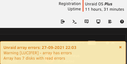

@JonathanM, your opinion here would be appreciated.  Right before the latest shutdown I got the error "Array has 7 disks with read errors", all my disks.  I was rebuilding a drive at the time, but other searches seem to point to a power issue.

So, seems the end answer was a combination of heat and power.
I replaced the case, with a Phanteks Enthoo 719.  Way better air flow, way more fans.
Replaced the 750W PSU with a 1000W and the server was able to complete it's rebuild of one of the drives.  There are 8 WD Red HDDs in there.
So the combination of all the drives being on, the more powerful CPU probably drawing more power was clearly tripping the PSU.
I'm going to mark this as solved.  Thanks for talking through it with me.
